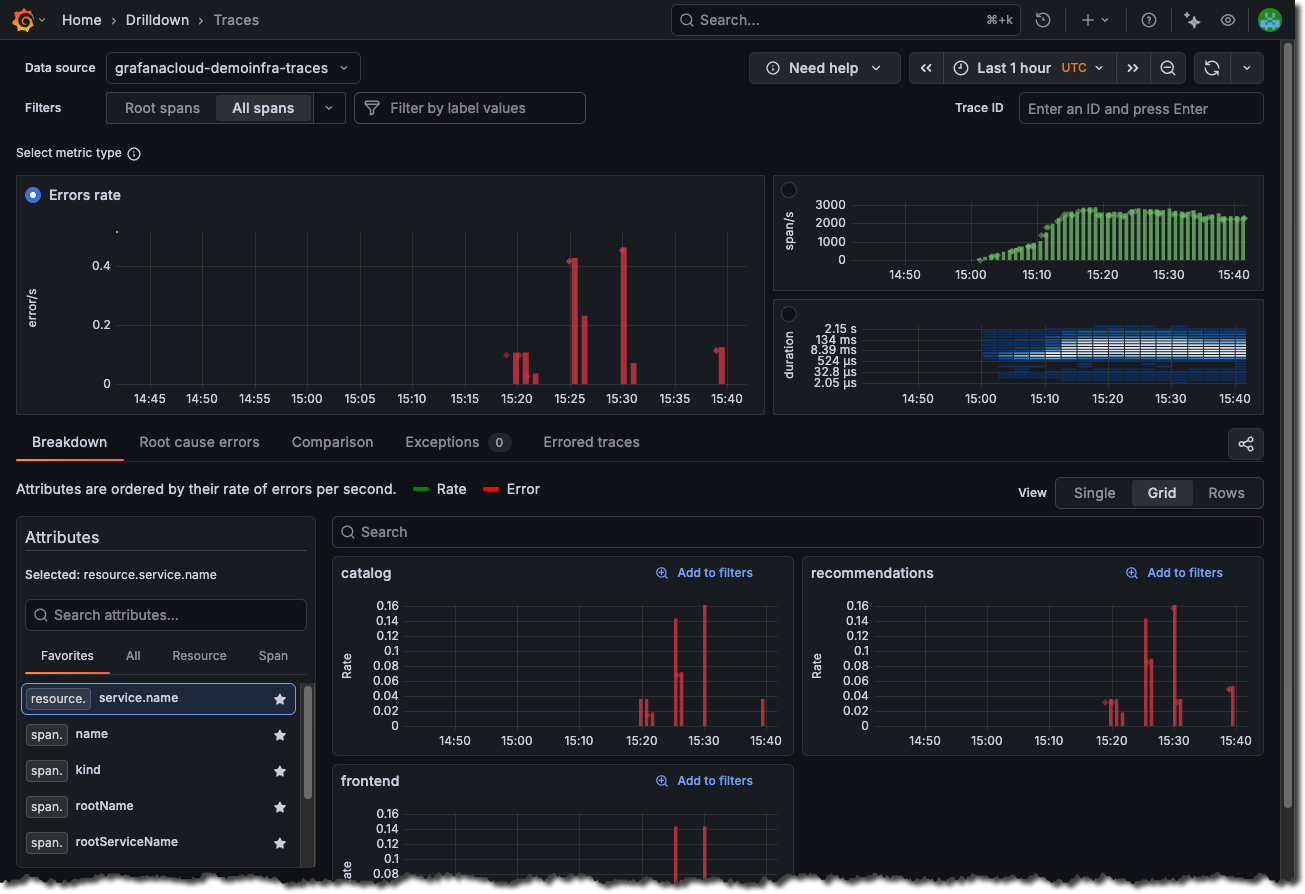

Using the Attributes sidebar, you can group the selected metric by different attributes. For example, if you have selected Errors as a metric type and then choose the resource.service.name attribute, the displayed results show the number of errors sorted by the resource.service.name with the most matches.
Use the Attributes sidebar to select the attribute for Group by. You can search, scope by Resource or Span, and use Favorites for quick access. Attributes already in your Filters are listed at the top of the Attributes sidebar.
Errors metric showing the Breakdown tab without filters
By default, the selected attribute is your first Favorite or resource.service.name. You can reorder Favorites to change this default. The Attributes sidebar displays other commonly used resource level attributes such as cluster, environment, and namespace.

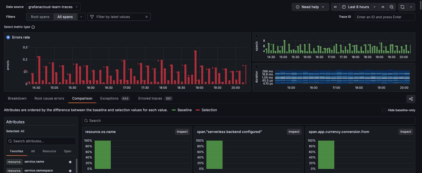

Use the Comparison tab
The Comparison tab helps you surface and rank which span attributes are most correlated with the selected metric so you can immediately spot what’s driving your trace-level issues.
Comparison view

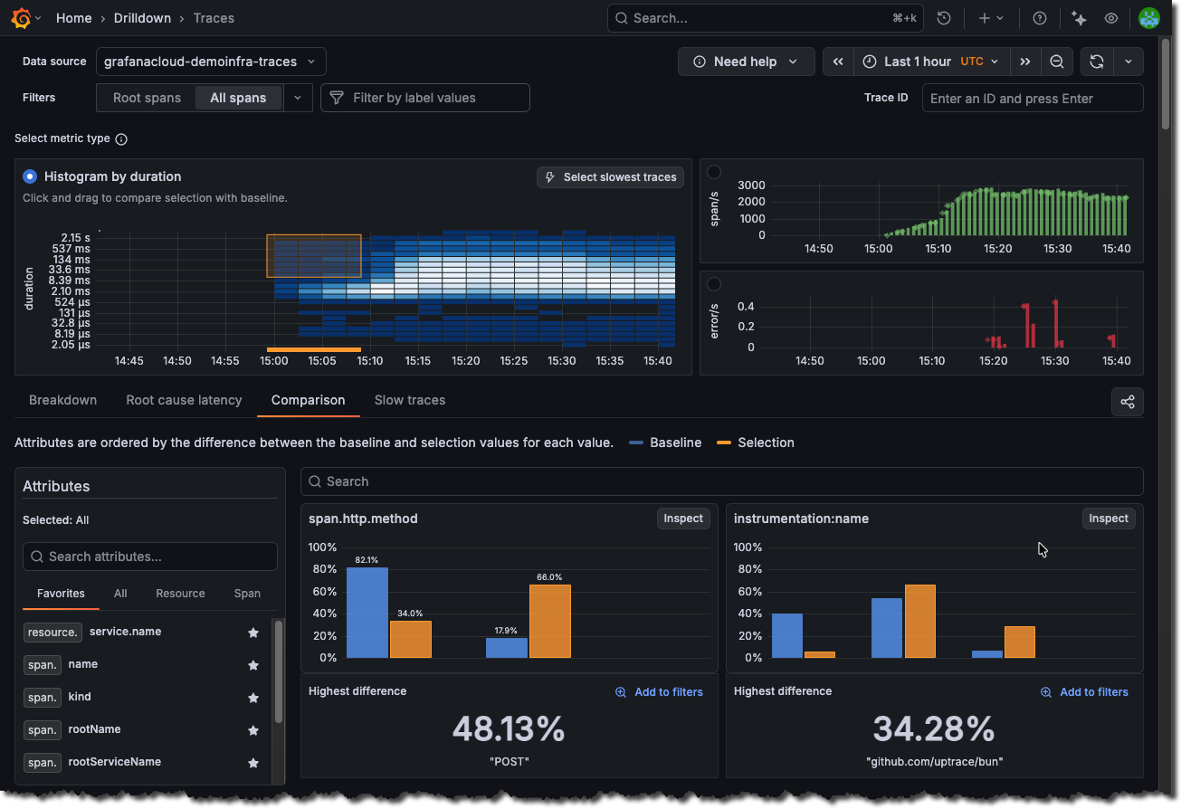

Upon selecting a metric, the tab computes, for each resource or span attribute, how strongly that attribute value differs between the selected subset (selection) and all other spans (baseline). It lists attribute‑value pairs in descending order of that difference, so the top entries are those most uniquely associated with your signal of interest.
  • If you’re viewing the Rate or Errors metrics, the selection contains all spans with errors, while the baseline contains all spans without errors.
  • If you’re viewing the Duration metric, by default the selection contains the slowest spans above the 90th percentile, while the baseline contains all other spans. You can manually adjust the selection on the duration heatmap.
The behavior of the comparison also differs depending upon the RED metric you’ve chosen. For example, if you’re viewing Errors metrics, the comparison shows the attribute values that correlate with errors. However, if you’re viewing Duration metrics, the comparison shows the attributes that correlate with high latency.
Use the Attributes sidebar to switch between All (overall differences) and a specific attribute (per‑value differences). Favorites, search, and scope controls work the same as in Breakdown.

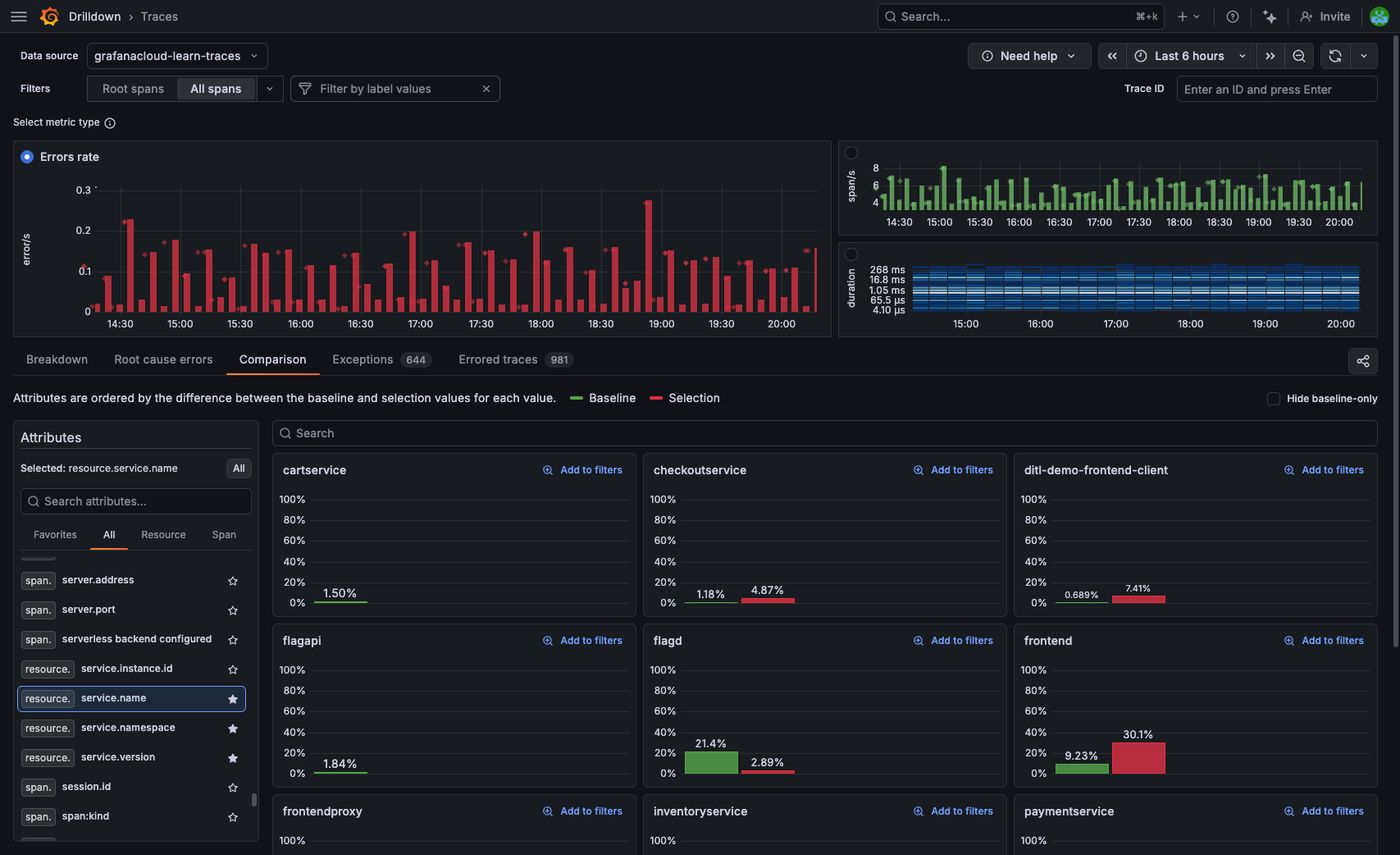

Focus on individual attributes with Inspect
Inspect lets you break down and view individual attribute values from a comparison. The overview shows each attribute with its single highest-difference value and an Inspect button, but you can’t see all values for that attribute at once.
Select Inspect on an attribute
When you select Inspect, the app focuses on that one attribute and shows a visualization for every value it contains. For example, selecting Inspect on resource.service.name shows every service with its baseline and selection bars, so you can immediately see which services are most correlated with the selected metric.
Inspect focuses the results on the selected attribute

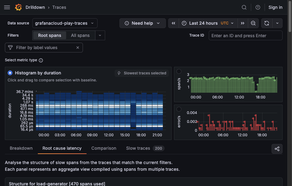

When you select Duration metrics, the Root cause latency tab shows the structure of the longest running spans so you can analyze the structure of slow spans.
The pictured spans are an aggregated view compiled using spans from multiple traces.
Duration metric showing root cause latency

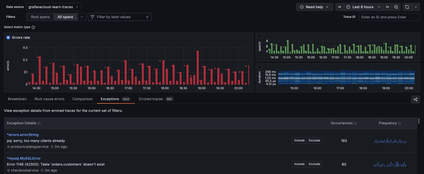

Use the Exceptions tab (Errors metric only)

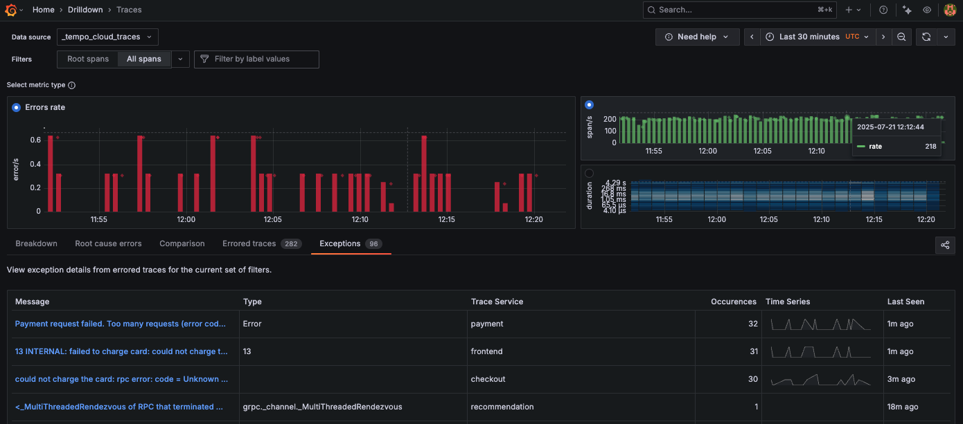

Use the Exceptions tab to see which exception messages are occurring within your current filters and time range. Exceptions are grouped by message so you can identify the most frequent failures and access the affected traces.
Examples:
  • Inspect individual exceptions by clicking a message to open the Trace list pre-filtered for that message, so you can inspect individual traces immediately.
  • Narrow exceptions by service, environment, namespace, or any span/resource attribute by combining with the Filters bar.
Exceptions tab
The Exceptions tab has a table with the following columns:
  • Exception Details: Exception type, message text, emitting service, and last seen time grouped by unique exception
  • Occurrences: Count of matching exceptions for the selected range
  • Frequency: Sparkline of occurrences over time
Each row includes Include and Exclude buttons so you can filter the current investigation to focus on or eliminate a specific exception.
The Exceptions tab is available when the Errors metric is selected and exceptions are present. The tab respects the current time range and filters. For example, when Errors are selected, Exceptions works with both Root spans and All spans selections. The results reflect the data in scope.
If you notice a rise in the Errors metric, you can use the Exceptions tab to investigate the issue.
  1. Select Errors as the metric.
  2. Open the Exceptions tab.
  3. The top row shows Payment request failed. Too many requests (error code 429) with rising occurrences and a spiky sparkline.
  4. Click the message to jump to the Trace list pre-filtered by that exception.
  5. Sort by Duration to find the most impacted requests, then open a trace to inspect retries and upstream dependencies.
