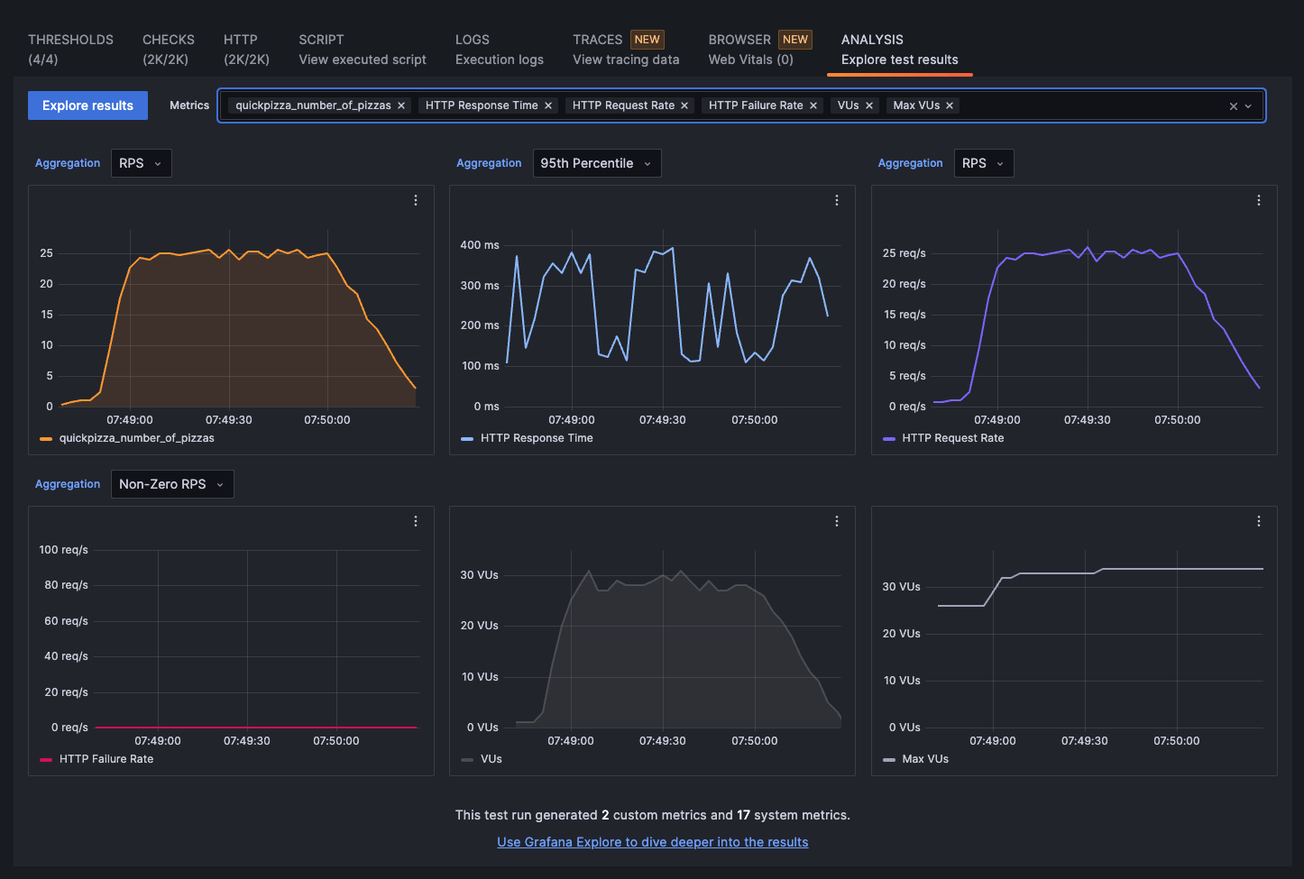

To inspect the metrics from your test run, go to a test result and select the Analysis tab.
Analysis tab in Grafana Cloud k6, showing six metrics panels, one custom and five system metrics
The analysis tab is available when inspecting a single test run, and also when comparing test runs.
Add/remove metrics
By default, the analysis tab displays panels for six metrics. In the Metrics field, you can search for any system or custom metrics, and add them to the analysis tab, as well as remove any metrics by selecting the “X” icon next to them.

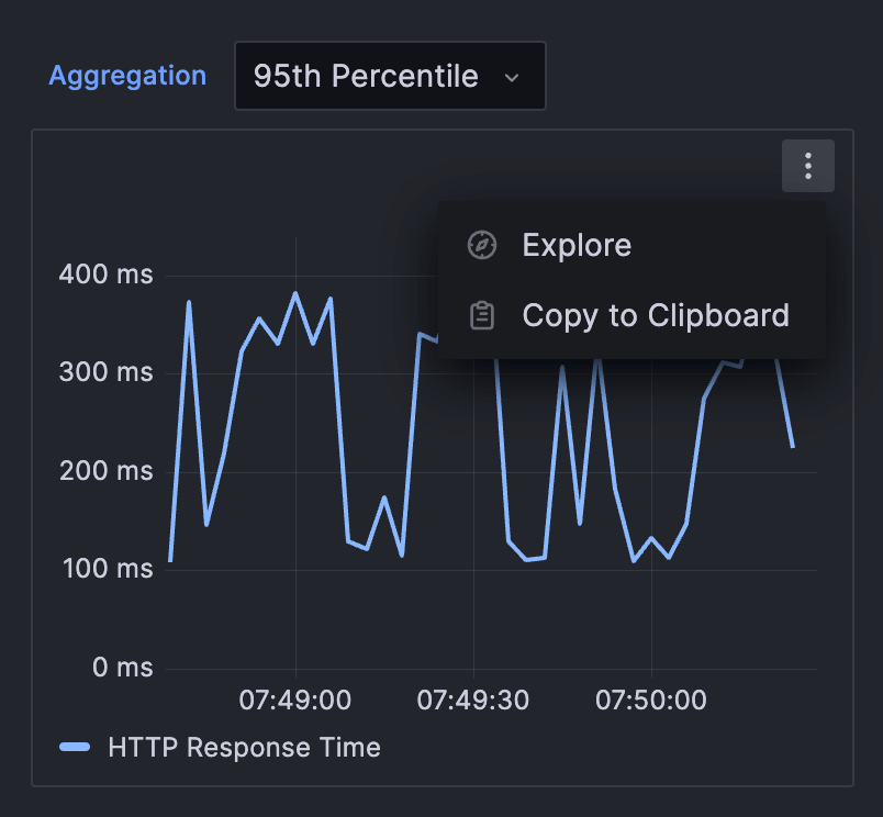

You can select the three-dot icon next to each panel to see two options:
  • Explore: Displays the selected metric in Grafana Explore, where you can customize any parameters for your query and add it to a dashboard.
  • Copy to clipboard: Copies the JSON information for the panel, which you can then add to a Grafana dashboard by opening a dashboard and selecting Add, and Paste panel.
Analysis tab in Grafana Cloud k6, showing the Explore and Copy to clipboard menu options for a panel once you click on the three-dot icon next to it
