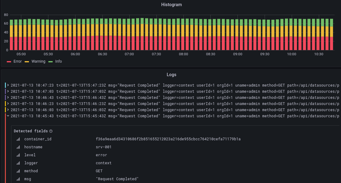

After beginning to send data, you can start to query it using the Explore tab or create your own visualizations. This is how you might integrate logs into a panel in Grafana Cloud:
Sample visualization dashboard
