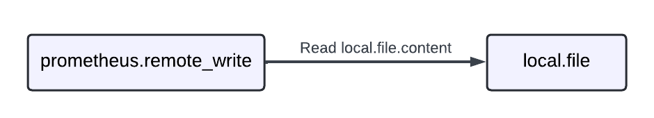

This pipeline has two components: local.file and prometheus.remote_write. The local.file component is configured with a single argument, filename, which is set by calling the sys.env standard library function to retrieve the value of the HOME environment variable and concatenating it with the string "file.txt". The local.file component has a single export, content, which contains the contents of the file.
The prometheus.remote_write component is configured with an endpoint block, containing the url attribute and a basic_auth block. The url attribute is set to the URL of the Prometheus remote write endpoint. The basic_auth block contains the username and password attributes, which are set to the string "admin" and the content export of the local.file component, respectively. The content export is referenced by using the syntax local.file.example.content, where local.file.example is the fully qualified name of the component (the component’s type + its label) and content is the name of the export.
Example pipeline with local.file and prometheus.remote_write components
Note
The local.file component’s label is set to "example", so the fully qualified name of the component is local.file.example. The prometheus.remote_write component’s label is set to "local_prom", so the fully qualified name of the component is prometheus.remote_write.local_prom.

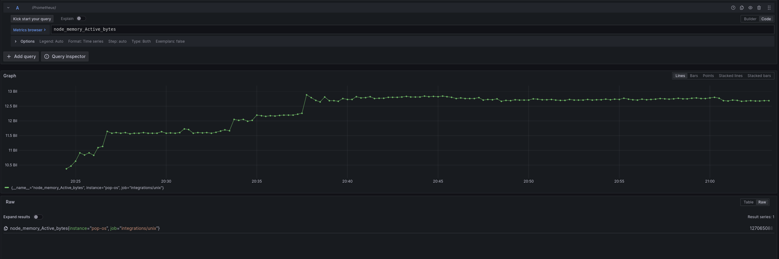

Navigate to http://localhost:3000/explore in your browser. After ~15-20 seconds, you should be able to see the metrics from the prometheus.exporter.unix component. Try querying for node_memory_Active_bytes to see the active memory of your host.

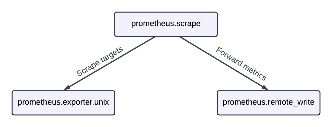

The following diagram is an example pipeline:
Example pipeline with a prometheus.scrape, prometheus.exporter.unix, and prometheus.remote_write components
Your pipeline configuration defines three components:
  • prometheus.scrape - A component that scrapes metrics from components that export targets.
  • prometheus.exporter.unix - A component that exports metrics from the host, built around node_exporter.
  • prometheus.remote_write - A component that sends metrics to a Prometheus remote-write compatible endpoint.
The prometheus.scrape component references the prometheus.exporter.unix component’s targets export, which is a list of scrape targets. The prometheus.scrape component forwards the scraped metrics to the prometheus.remote_write component.

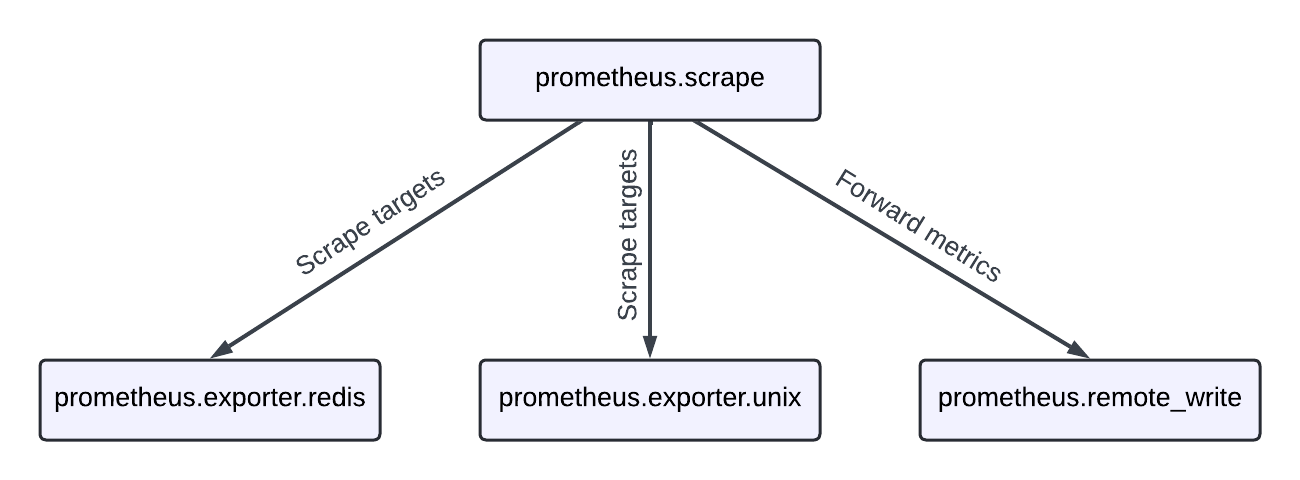

To give a visual hint, you want to create a pipeline that looks like this:
Exercise pipeline, with a scrape, unix_exporter, redis_exporter, and remote_write component
Tip
Refer to the array.concat standard library function for information about combining lists of values into a single list.
