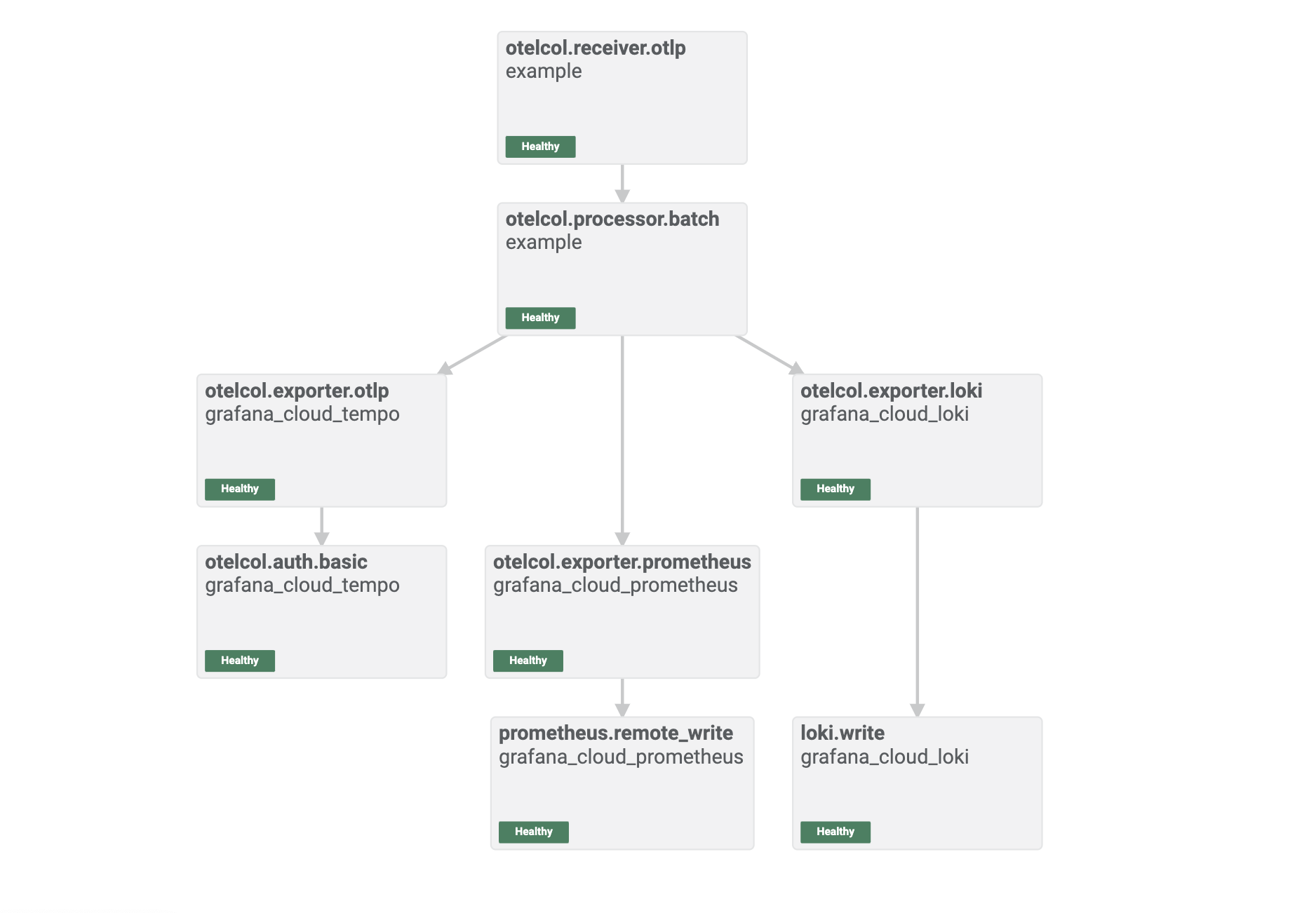

You can check the pipeline graphically by visiting http://localhost:12345/graph
Graphical representation of a healthy pipeline
