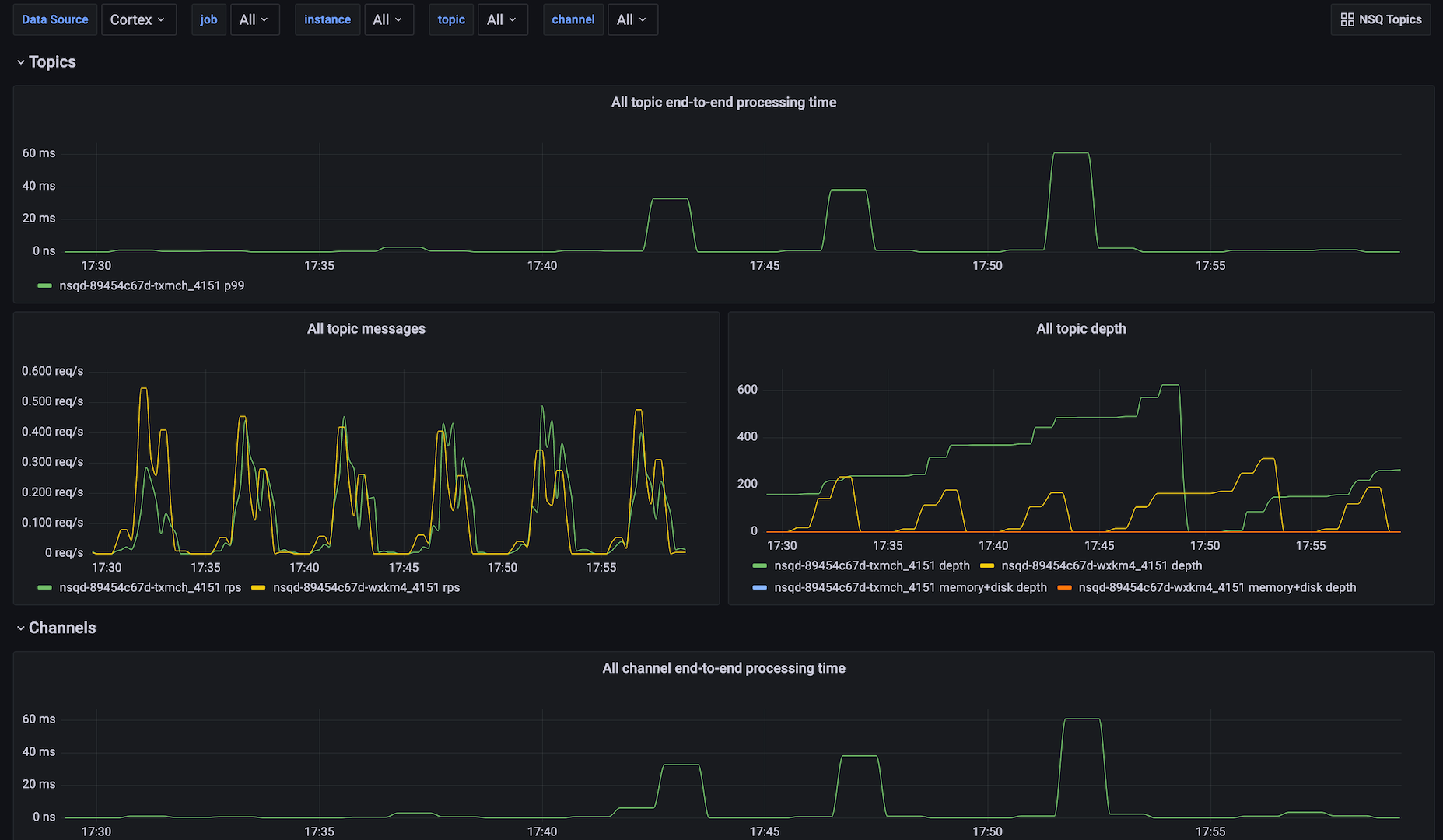

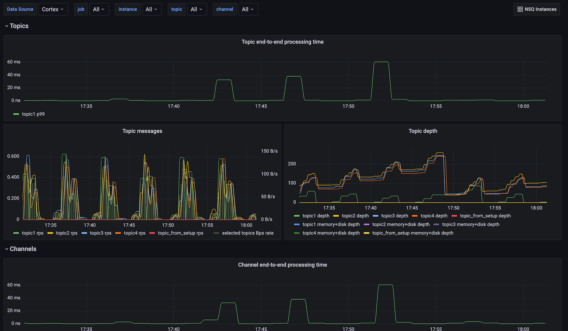

Dashboards
The NSQ integration installs the following dashboards in your Grafana Cloud instance to help monitor your system.
  • NSQ Instances
  • NSQ Topics
NSQ topics dashboard
NSQ instances dashboard
