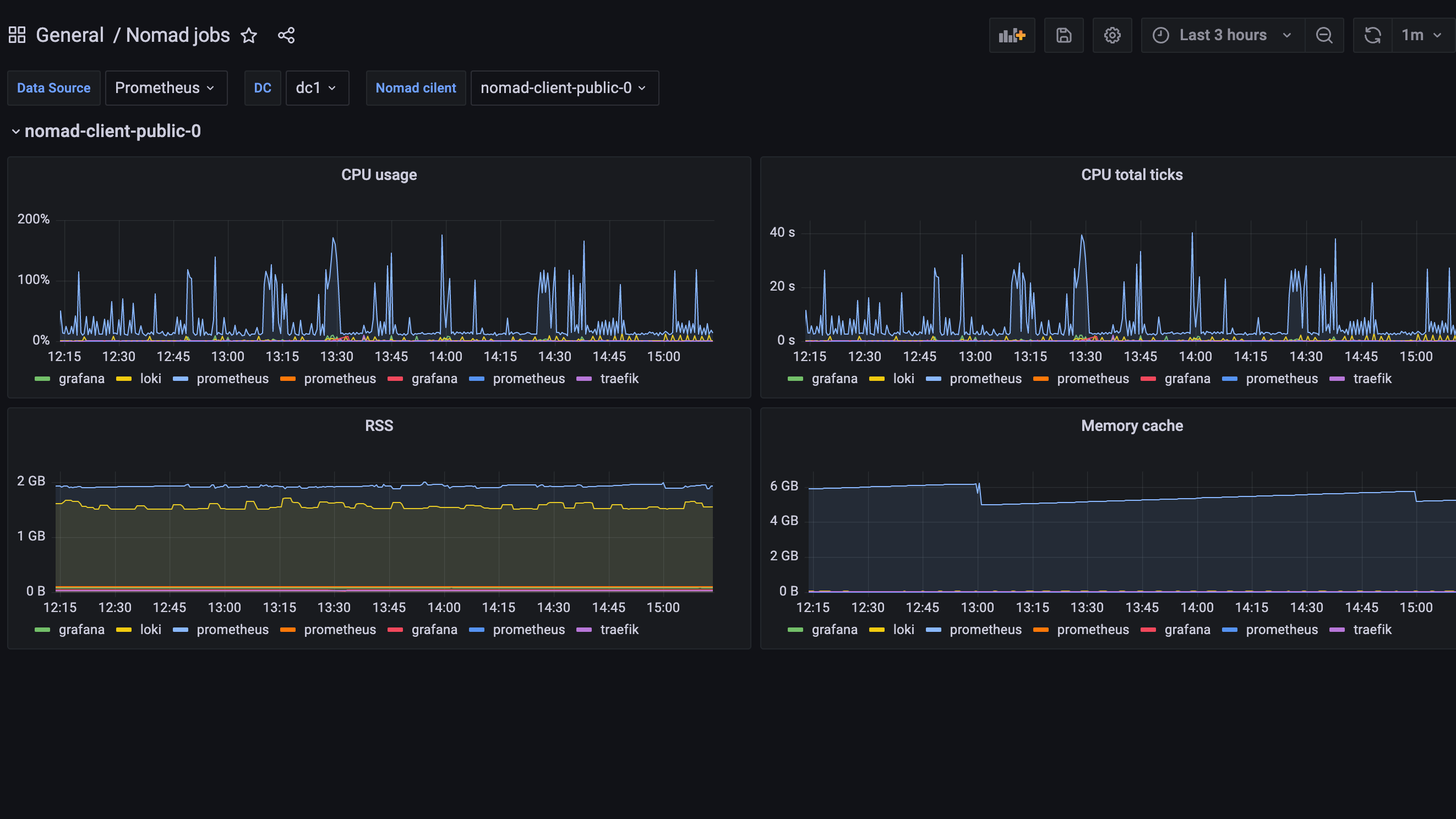

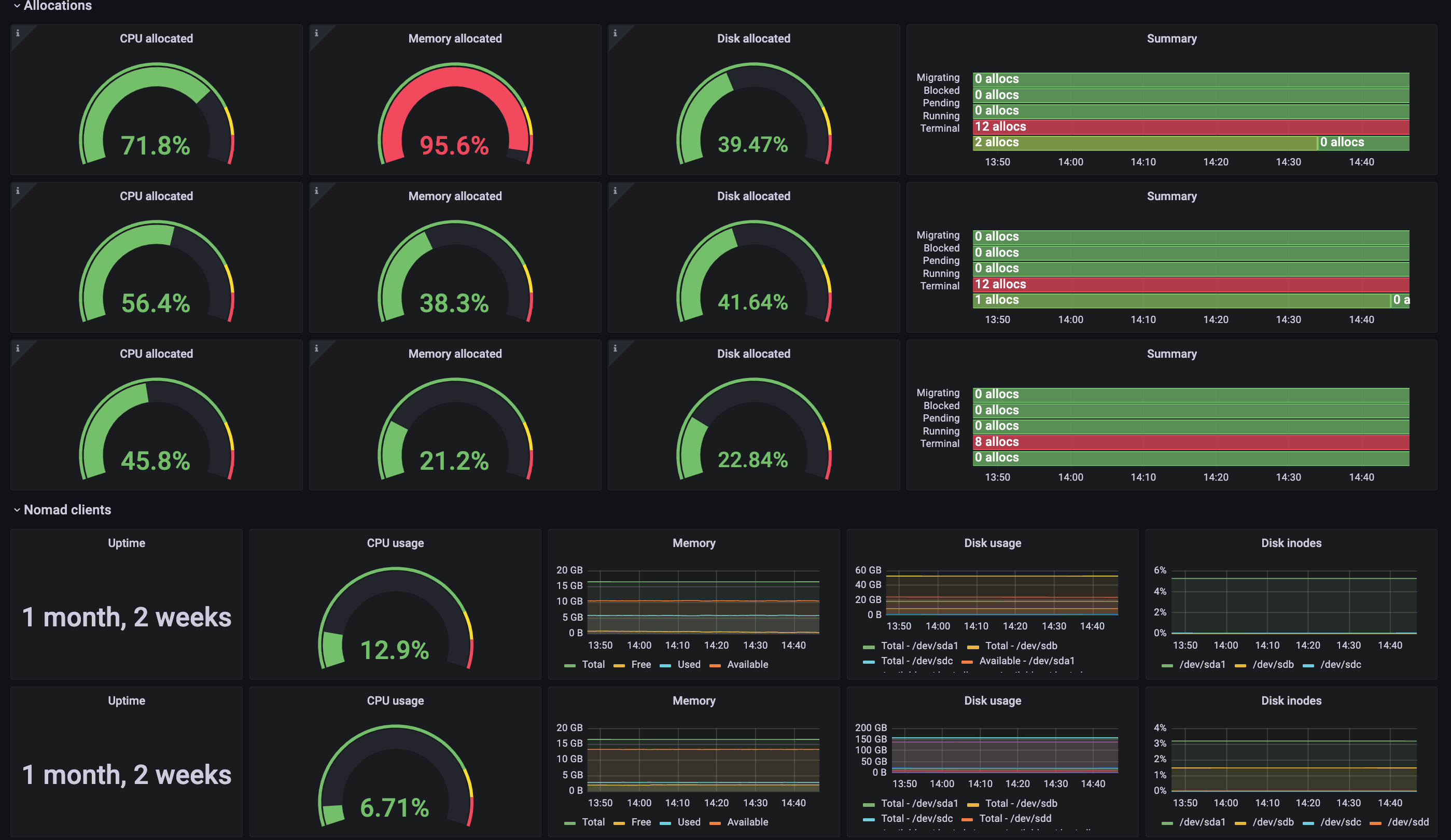

  • Nomad cluster
  • Nomad jobs
Nomad overview
Nomad overview
Nomad jobs
Nomad jobs
