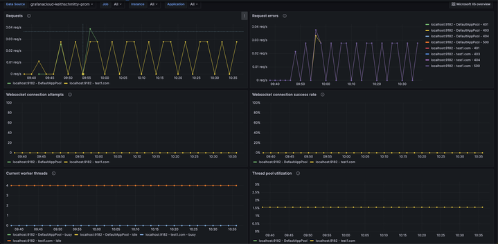

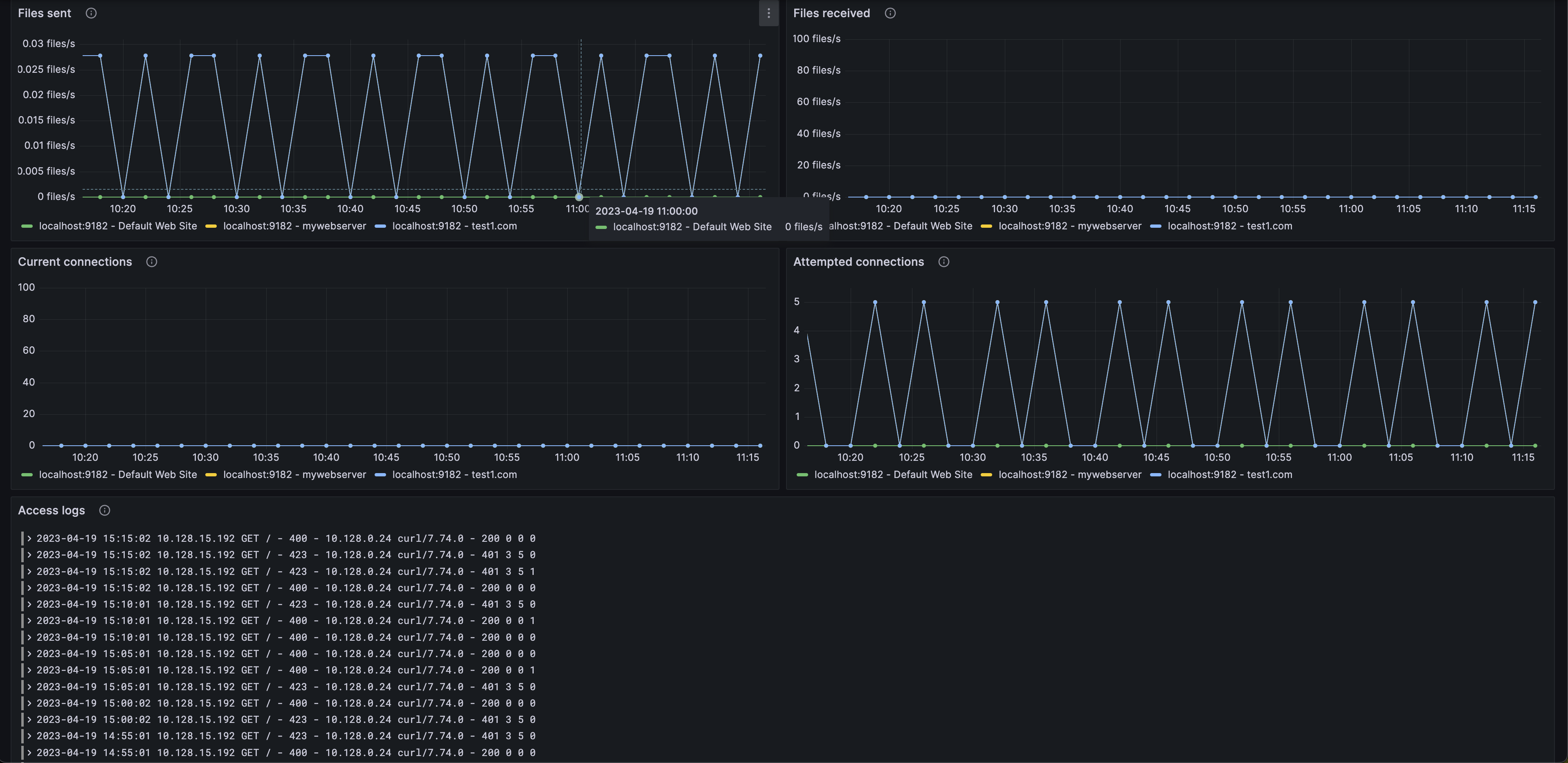

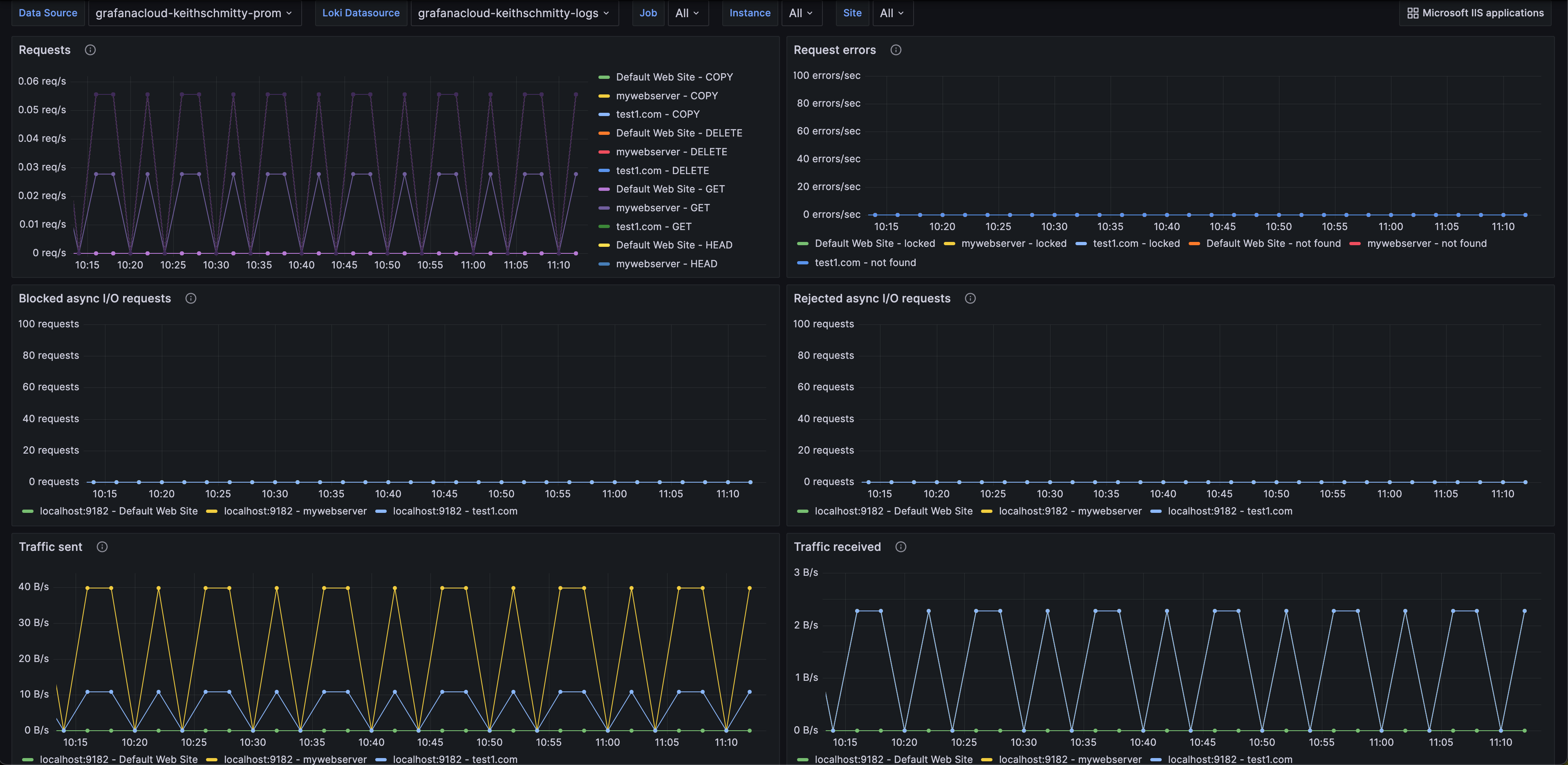

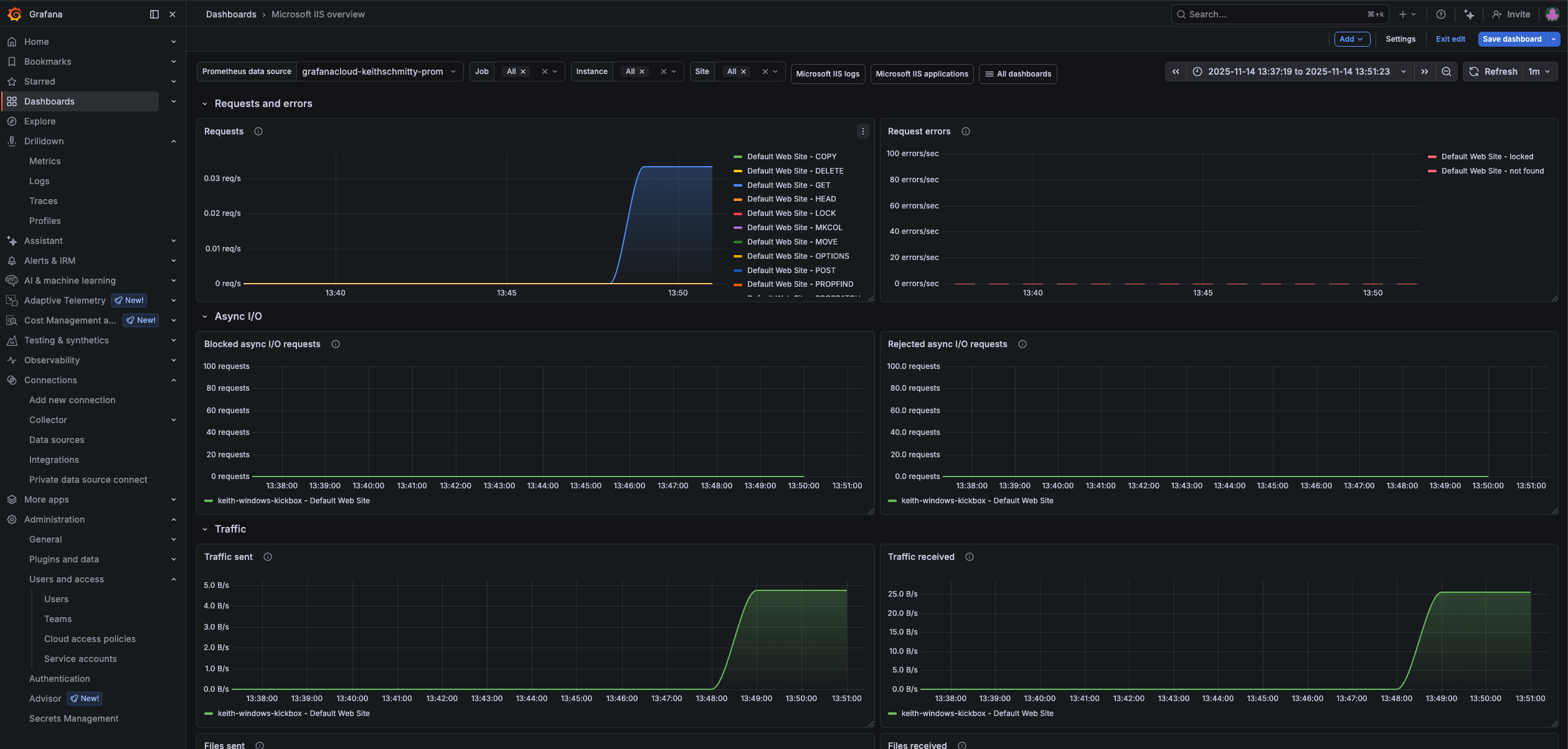

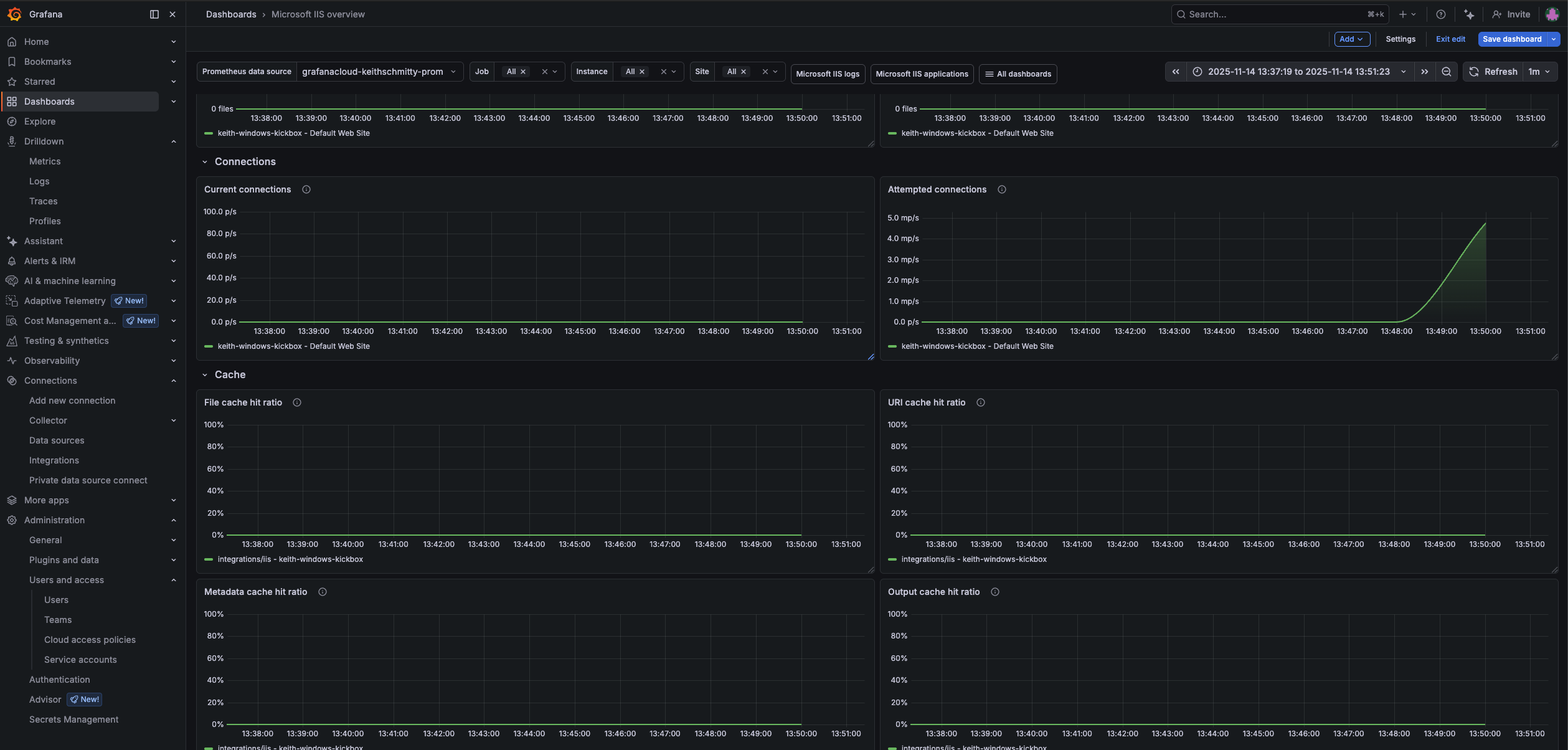

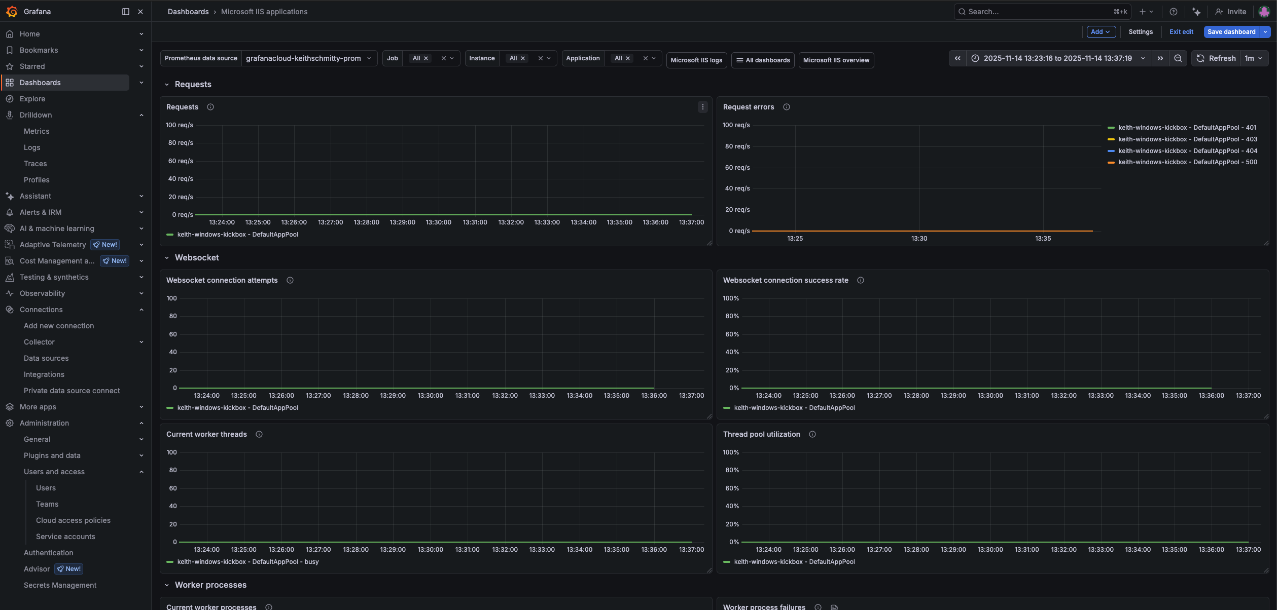

The Microsoft IIS integration installs the following dashboards in your Grafana Cloud instance to help monitor your system.
- Microsoft IIS applications
- Microsoft IIS overview
Microsoft IIS overview (Traffic)
