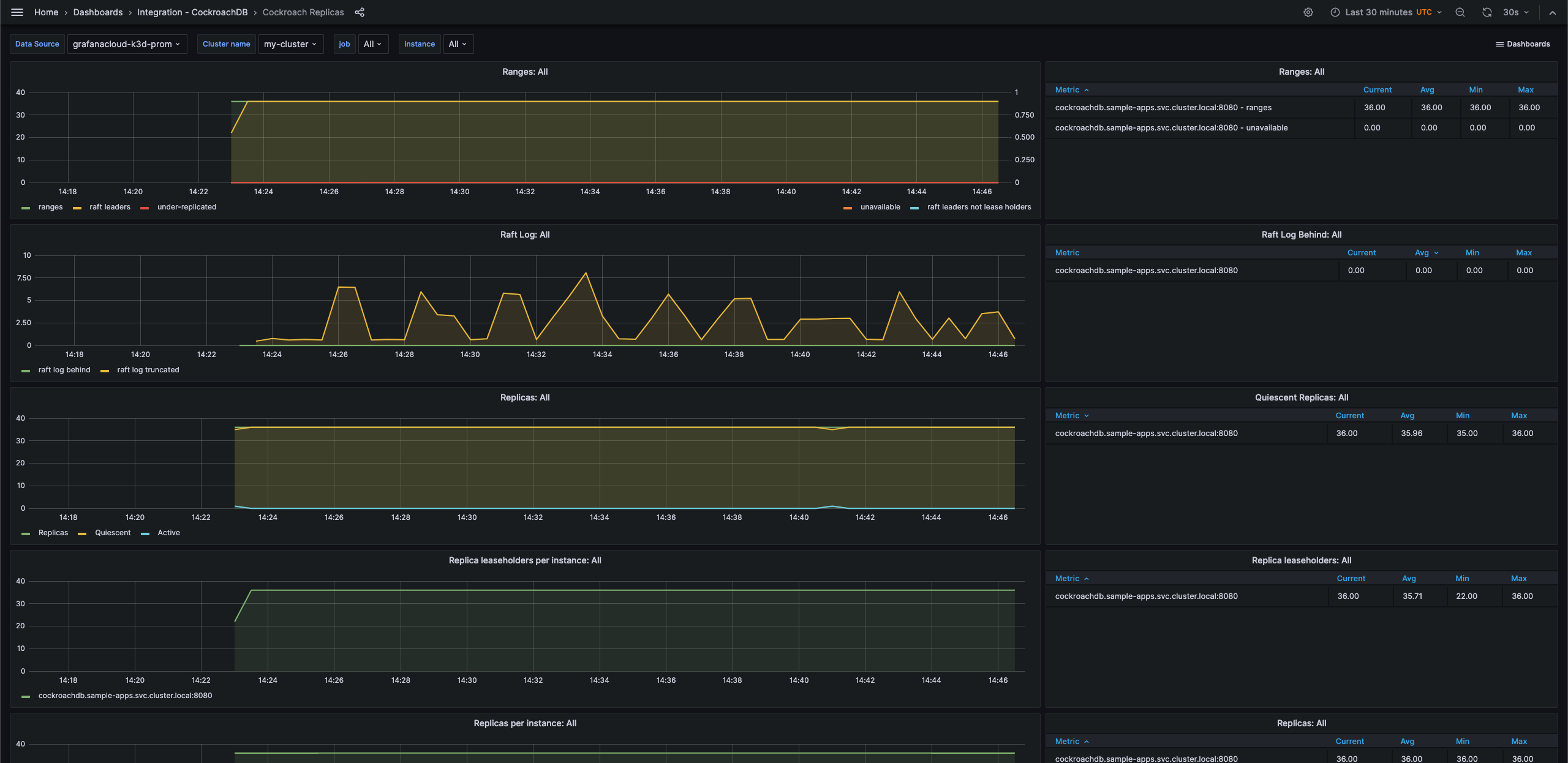

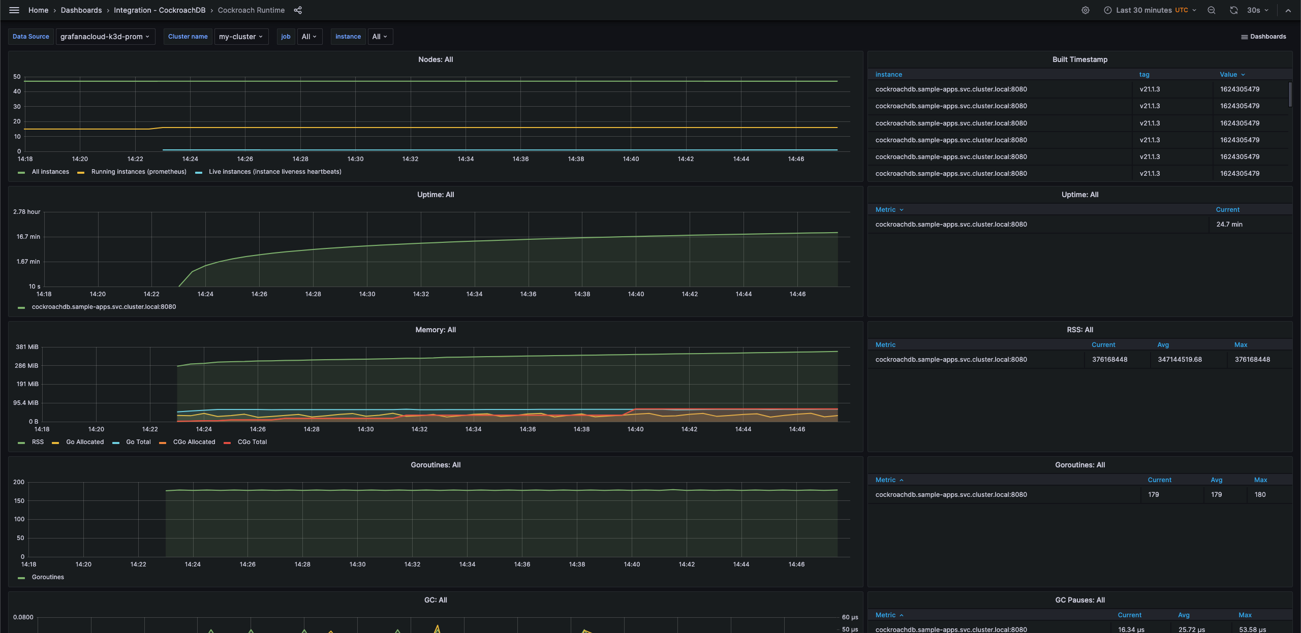

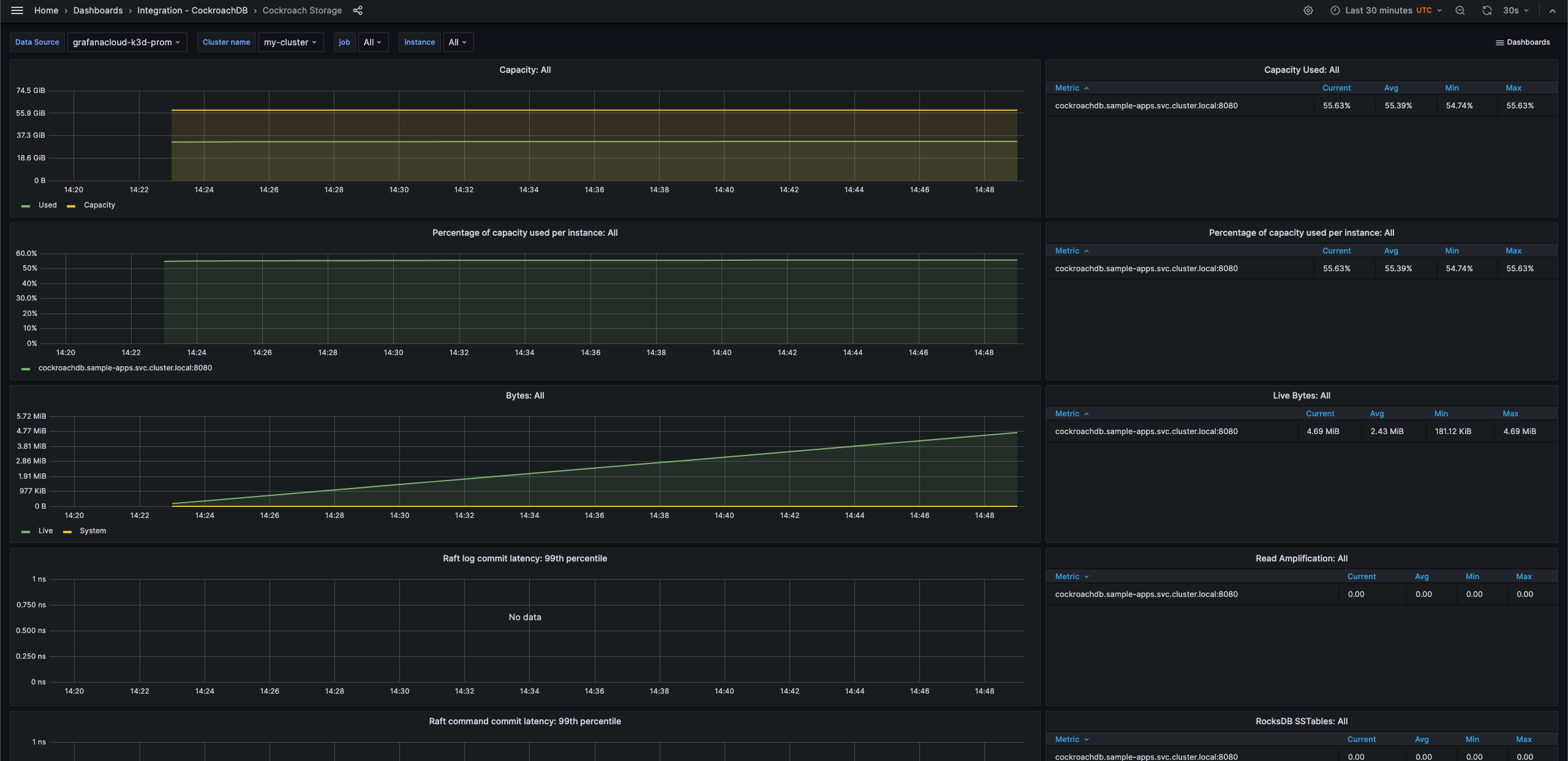

The CockroachDB integration installs the following dashboards in your Grafana Cloud instance to help monitor your system.
- Cockroach Replicas
- Cockroach Runtime
- Cockroach SQL
- Cockroach Storage
