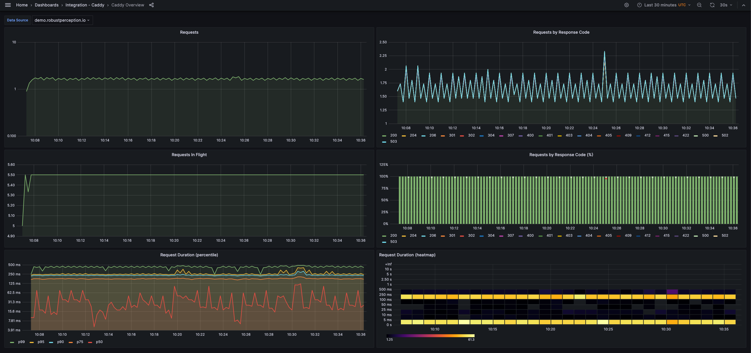

Dashboards
The Caddy integration installs the following dashboards in your Grafana Cloud instance to help monitor your system.
- Caddy Overview
Caddy overview
Metrics
The most important metrics provided by the Caddy integration, which are used on the pre-built dashboard, are as follows:
- caddy_http_request_duration_seconds_bucket
- caddy_http_request_duration_seconds_count
- caddy_http_requests_in_flight
- caddy_http_requests_total
- up
