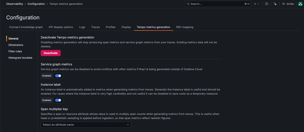

After activation, the configuration interface displays four sections: General, Dimensions, Filter rules, and Histogram buckets.
Tempo metrics generation configuration interface
Configure general settings
The General tab provides high-level controls for Tempo metrics generation after activation.
Deactivate Tempo metrics generation
Deactivating metrics generation stops producing span metrics and service graph metrics from your traces. Existing metrics data isn’t deleted.
To deactivate Tempo metrics generation:
  1. Navigate to the General tab.
  2. Click Deactivate.
  3. Confirm the deactivation.
Note
You can safely disable metrics generation if:
  • You generate metrics from traces on your end through OpenTelemetry Collector, Grafana Alloy, Grafana Beyla, or other tools
  • You use a custom data source for metrics
  • You don’t need the automatic metrics generation provided by the knowledge graph
Enable service graph metrics
Service graph metrics can be disabled to avoid conflicts with other metrics if you generate them outside of Grafana Cloud.
To enable or disable service graph metrics:
  2. Toggle the Service graph metrics switch.
Configure instance label
An instance label is automatically added to metrics when generating metrics from traces. The instance label is useful and should be enabled. For cases where the instance label has very high cardinality and isn’t useful, you can disable it to save costs as a temporary measure.
To enable or disable the instance label:
  2. Toggle the Instance label switch.
Set span multiplier key
The span multiplier key specifies a span or resource attribute whose value multiplies span counts when generating metrics from traces. This is useful when head or probabilistic sampling is applied before ingestion, ensuring span metrics reflect realistic figures. For example, if you sample 10% of traces (sampling rate of 0.1), set the span multiplier to the inverse (10) to ensure span metrics reflect realistic traffic volumes.
To configure the span multiplier:
  2. From the Span multiplier key dropdown, select an attribute name.
