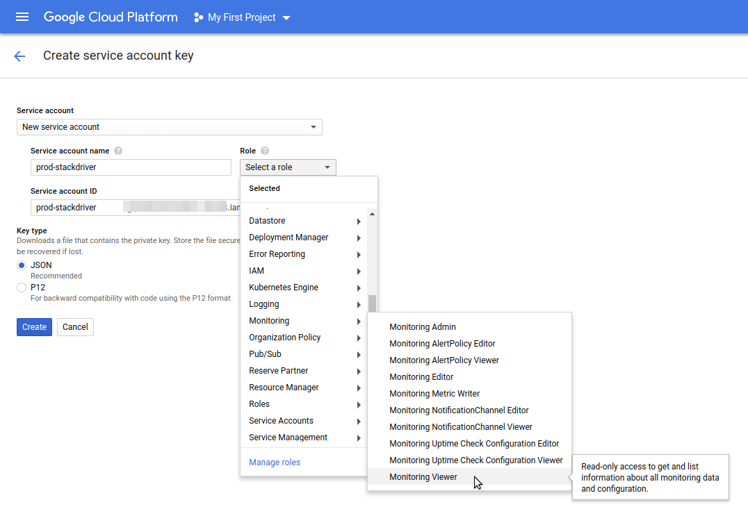

Configure a GCP Service Account
When you create a Google Cloud Platform (GCP) Service Account and key file, the Service Account must have the Monitoring Viewer role (Role > Select a role > Monitoring > Monitoring Viewer):

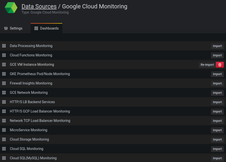

universeDomain: googleapis.comImport pre-configured dashboards
The Google Cloud Monitoring data source ships with pre-configured dashboards for some of the most popular GCP services. These curated dashboards are based on similar dashboards in the GCP dashboard samples repository.
To import curated dashboards:
Navigate to the data source’s configuration page.
Select the Dashboards tab.
This displays the curated selection of importable dashboards.
Select Import for the dashboard to import.
The dashboards include a template variable populated with the projects accessible by the configured Service Account each time you load the dashboard. After Grafana loads the dashboard, you can select a project from the dropdown list.
