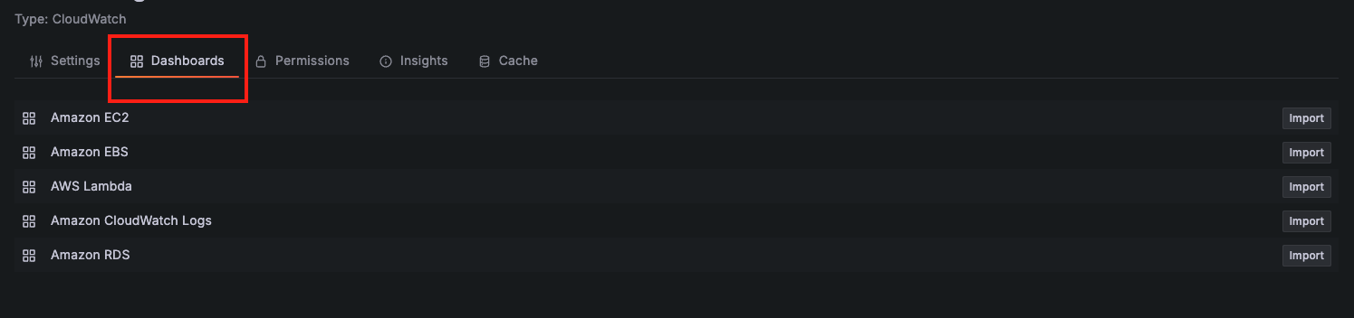

Import pre-configured dashboards
The CloudWatch data source ships with curated and pre-configured dashboards for five of the most popular AWS services:
  • Amazon Elastic Compute Cloud: Amazon EC2
  • Amazon Elastic Block Store: Amazon EBS
  • AWS Lambda: AWS Lambda
  • Amazon CloudWatch Logs: Amazon CloudWatch Logs
  • Amazon Relational Database Service: Amazon RDS
To import curated dashboards:
  1. Navigate to the data source’s configuration page.
  2. Select the Dashboards tab.
    This displays the curated selection of importable dashboards.
  3. Select Import for the dashboard to import.
CloudWatch dashboard import
