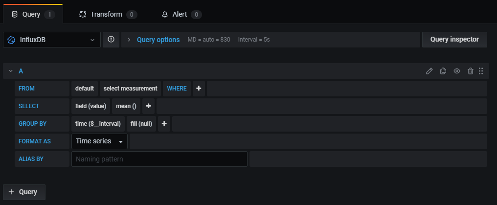

Use query editors
Each data source’s query editor provides a customized user interface that helps you write queries that take advantage of its unique capabilities. You use a data source’s query editor when you create queries in dashboard panels or Explore.
Because of the differences between query languages, each data source query editor looks and functions differently. Depending on your data source, the query editor might provide auto-completion features, metric names, variable suggestions, or a visual query-building interface.
