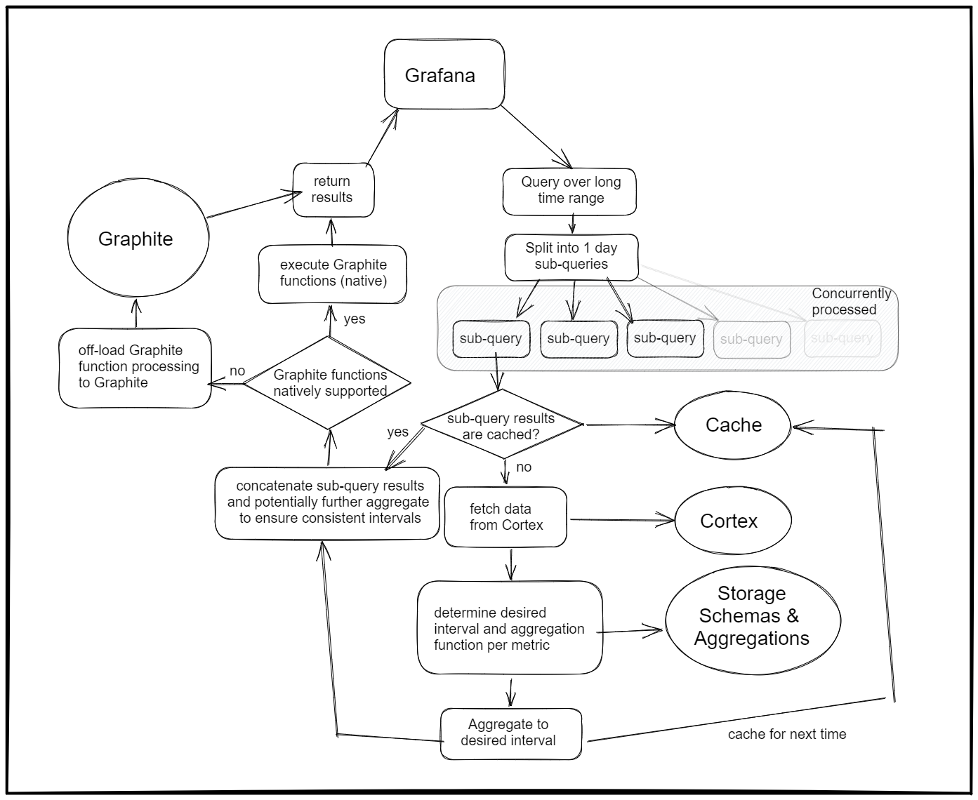

Query handling
The query handling endpoint accepts Graphite queries, it processes them in the following steps. This is a simplification which ignores the fact that some steps in the process are cached.
Parsing the query
The query gets parsed and based on the used functions a decision is made which query engine shall be used. Whenever all used functions are supported by the native query engine then this one is used, otherwise the Graphite function processing will be off-loaded to the external Graphite process.
The metric name patterns get extracted from the query and a Prometheus query gets generated to fetch the required data to serve the query from Cortex. To generate that Prometheus query the name mapping schemes get applied in reverse, for more information about the name mapping schema refer to Graphite write proxy.
Breaking the query up into sub-queries
If the original query is requesting a long time range, then it gets broken up into sub-queries. Each sub-query has a maximum time range of 1d by default, configurable via the flag graphite.querier.split-queries-by-interval, the time range boundaries are aligned to multiples of the split interval. The default sub-query length of 1d is derived from the fact that by default the blocks in the store have a length of 1d after compaction, that way each sub-query processes exactly one block.
Each sub-query gets assigned two points budgets defining how many data points it may produce, the two budgets are called soft budget and hard budget. The points budgets per sub-query get calculated based on the total query budgets configured via the flags graphite.querier.max-points-per-req-{soft,hard} which by default have the values 1000000 and 20000000, each sub-query gets an equal share which is proportionate to the total queried time range.
The soft budget defines to what number of points the results should optimally be aggregated, but it may be exceeded if it is not possible to stay within the soft budget due to the configured retentions in the storage-schemas. If the number of points can’t be reduced to fit within the hard budget then the query directly errors to prevent overloading of the query engine.
Note that the sub-queries are only responsible for fetching and processing the raw data in preparation for the query engine to run on top of the data. The query engine will later run on the combined sub-query results and not on each sub-query result separately.
Processing of the sub-queries
The sub-queries which resulted from breaking up the original query get processed concurrently by a pool of worker threads. The size of the work pool is configurable via the flag graphite.querier.query-handling-concurrency, with a default value of 8. Increasing the worker pool size can speed up the processing of queries with long time ranges because they will be processed at a higher concurrency as long as enough physical cores are available, but it will also increase the memory consumption.
Fetching the data
Each sub-query worker separately fetches the data which it requires to process its sub-query from Cortex. This means that if one Graphite query gets broken up into 5 sub-queries then Cortex sees 5 separate queries, so it is expected that the Cortex query rate might be higher than the Graphite query rate.
Choosing the target interval for each metric
Each metric will get aligned to an interval that is determined based on the tenant’s storage-schemas configuration. First the metrics get grouped by the schemas of which they match the pattern, these groups are called rollup groups because they always get rolled up (horizontally aggregated) together, then each rollup group’s target interval gets determined based on the queried time range and the schema configuration. For this the time range of the original Graphite query is used and not the time range of the sub-query. To learn more details about the process of determining the target interval, refer to storage schemas.
After each rollup group has an assigned target interval the total number of points which this sub-query is going to generate gets calculated based on the number of metrics in each rollup group, their assigned target intervals, and the time range of the sub-query.
If the total number of points which will get generated by this sub-query exceeds the sub-query’s soft budget then the rollup group which currently has the lowest target interval gets bumped to the next retention of its matching storage schema. Since the retentions are always defined in increasing interval order, bumping a rollup group to the next retention results in less points being generated. This process gets repeated until either the total number of points generated by the sub-query fits in the soft budget or all rollup groups have already been bumped to their final retention.
If the total number of points which will get generated by this sub-query still exceeds the sub-query’s hard budget then an error gets returned and the query processing gets aborted.
Alignment and aggregation of the data
The data points of each metric now get aligned to the target interval of the rollup group which the metric is in. If there are data points with time stamps that are not a multiple of the target interval then they get aligned to multiples of the interval by shifting them to a lower time stamp. If there are multiple data points within one interval then they get aggregated together by the aggregation function chosen based on the storage-aggregation’s configuration of the tenant, the resulting value will be assigned with a timestamp that is a multiple of the target interval. To learn more about the storage-aggregation refer to storage aggregations.
This process is cached, but the caching logic is omitted in this description for the sake of simplicity, to learn more about the caching logic refer to caching.

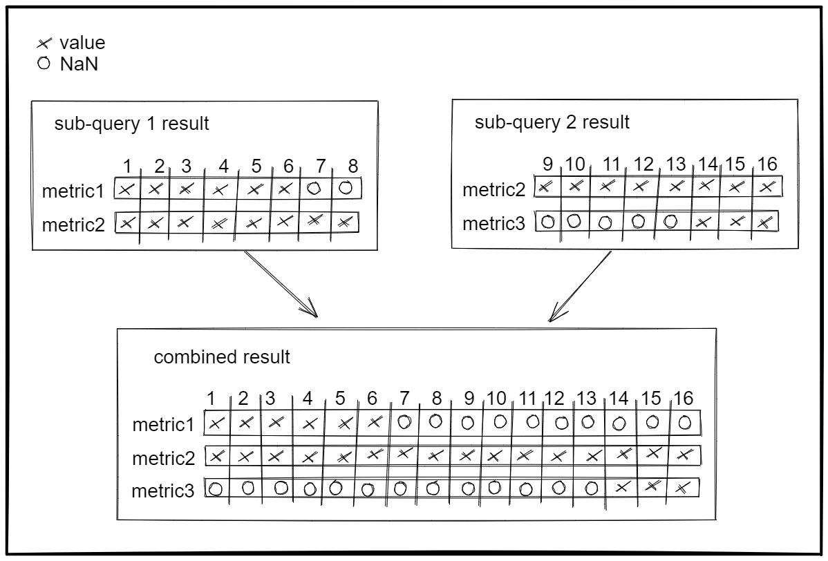

Combining the sub-query results
Each sub-query returns a set of metrics that has been aligned and aggregated to the correct interval, now the results of the different sub-queries get combined into one set of metrics.
If a sub-query result contains a metric which is not present in another sub-query result then the gap is filled with NaN.
Concatenating sub-query results
At this point it is possible that the same metric has been aggregated to different intervals in the different sub-queries, because if one sub-query resulted in a larger number of metrics than another then its retention might have been bumped to fit the number of points generated by the sub-query into its soft budget In this situation the sub-query results with the lower interval get aggregated to match the interval of the sub-query result with the higher interval, because the Graphite query engines require each metric to have a constant interval.
The result after combining the sub-query results is one set of metrics, where each metric is guaranteed to have a consistent interval and each metric has data points filling the entire queried time range because all gaps have been filled with NaN values.
Function processing
The combined sub-query results now get passed into the query engine that has been chosen in the beginning of the query handling process. This can either be the native query engine (preferred) or a an optional Graphite deployment running in a separate process (for function completeness). To learn more about how the Graphite querier offloads the function processing to a separate Graphite process, refer to offloading the function processing to Graphite.
Returning to the user
The query engine returns a set of metrics which has been generated by running the Graphite functions specified in the query on the combined sub-query results, this set of metrics now gets returned to the user.

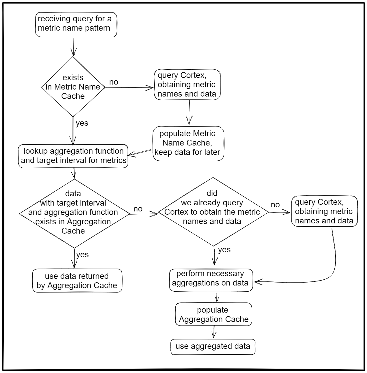

Metric name cache
The metric name cache caches the resolution of metric name patterns that are used in the queries into lists of concrete metric names. Each entry in the metric name cache contains a list of metric names corresponding to a combination of the following attributes:
  • Metric name pattern
  • Time range
Aggregation cache
The aggregation cache caches the aligned and aggregated results of sub-queries on a per-metrics basis. Each entry in the aggregation cache contains a chunk of data corresponding to a combination of the following attributes:
  • Metric name
  • Time range with a length of 1d by default
  • Target interval
  • Aggregation function used
Cache usage
This illustrates the flow how these two caches are used in the query handling process. cache usage flow
