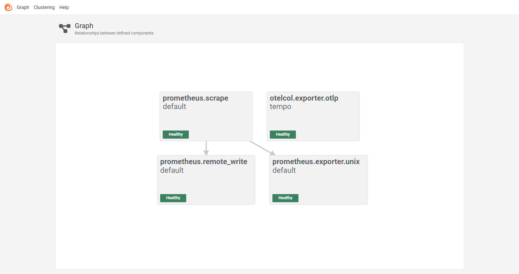

Graph page
Alloy UI graph page
The Graph page shows a graph view of components defined in the configuration file and their health. Clicking a component in the graph navigates to the Component detail page for that component.
