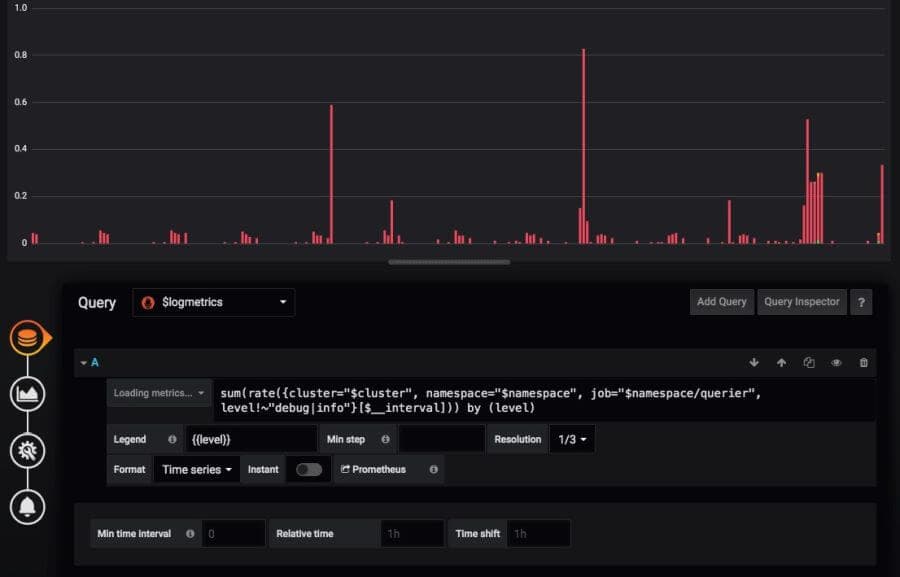

Starting in v0.4.0, Loki now supports calculating metrics from logs and provides a Prometheus-compatible API! You can now make metric panels directly from your logs:
To use this new functionality today in Grafana, set up a new Prometheus datasource and point it at https://[your-loki-url]/loki. Then you can create metric panels and dashboards like the above example.
There is also active development in Grafana to be able to support these metric-style queries directly against a Loki datasource, so keep your eye on upcoming Grafana releases!
For more information on querying metrics from logs, check out the docs, where you can learn how to use sum, rate, topk, and many other PromQL-style queries against your logs.
