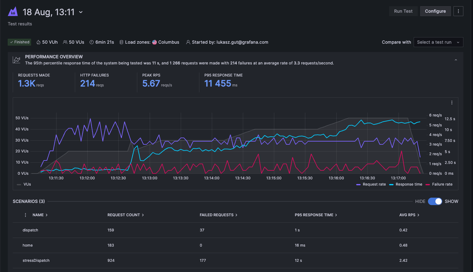

Grafana Cloud k6 automatically displays high-level performance metrics for your test (e.g., P95 response time, request rate, and failure rate), as well as specific data sets for the HTTP requests made, organized into scenarios (e.g., status code, request count, and response time percentiles). This allows you to discover that the response time of the requests increases significantly in the stressDispatch scenario, when there is more load on the system, with a max response time of 12 seconds.
While the performance testing results indicate the application has a latency issue under load, you have no idea what actually caused the latency, as you don’t have visibility into the system being tested. This is where Distributed Tracing in Grafana Cloud k6 comes into play.
A screenshot of Grafana Cloud k6 test results

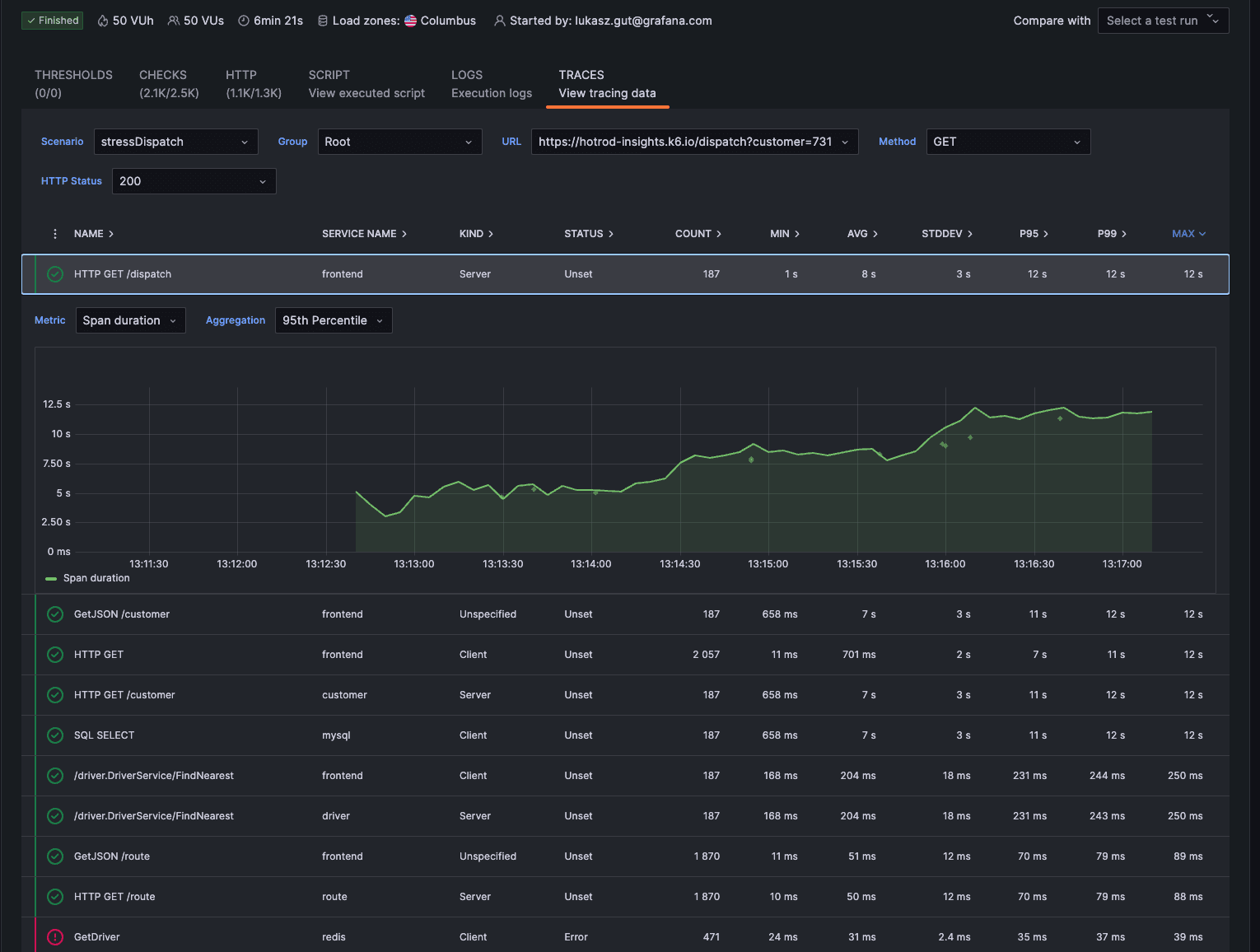

With Distributed Tracing in Grafana Cloud k6, you can now view and investigate the server-side traces generated by the k6 requests in the stressDispatch scenario to identify the root cause right in Grafana Cloud k6. This new integration with Grafana Cloud Traces brings a new Traces tab, providing a summary view of all the spans generated while the system was under test. This allows you to quickly identify the services that make up your distributed system and the operations these services performed. You can also track how each of the operations performed, in terms of count and duration, both in aggregate and over time. By sorting the operations by duration, you find that the HTTP GET /dispatch operation took the longest, therefore narrowing your search.
A screenshot of the summary view in Distributed Tracing in Grafana Cloud k6

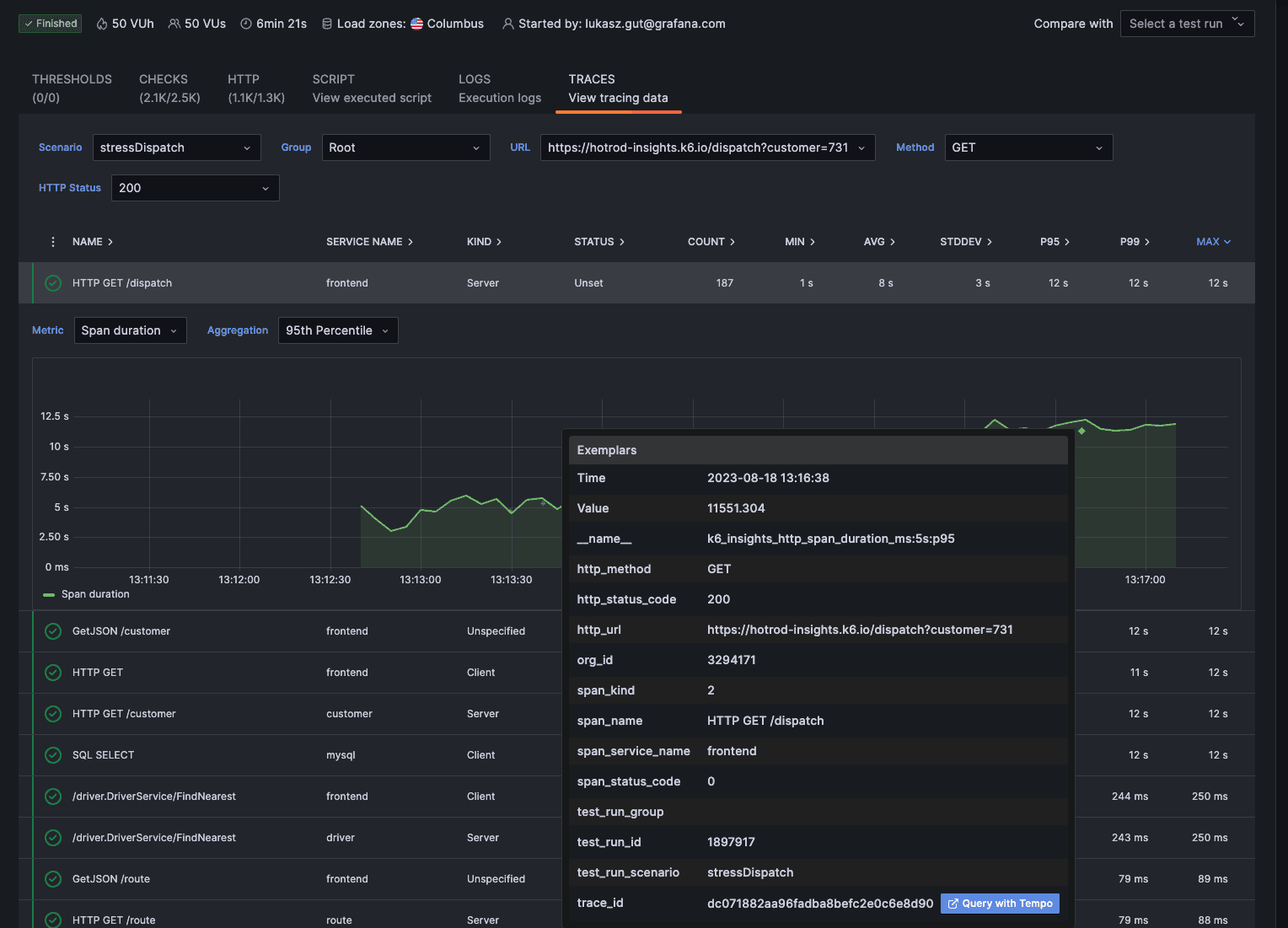

Further, as the metrics chart for the HTTP GET /dispatch operation has exemplars attached (i.e., small green dots that represent individual requests), you can simply click the Query with Tempo button and quickly jump from the aggregations to an individual trace in Explore to dig deeper.
A screenshot of the exemplars in Distributed Tracing in Grafana Cloud k6

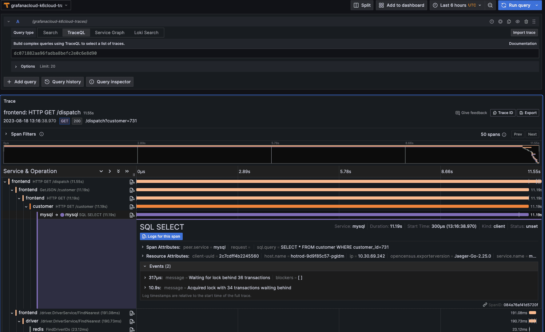

Finally, by examining the specific trace, you can find out why the HTTP GET /dispatch operation takes so long: the downstream mysql operation took 11 seconds to process. The events attached to the mysql span reveal more details, including these messages: “Waiting for lock behind 36 transactions” and “Acquired lock with 34 transactions waiting behind.”
All of these details point to the root cause of the application latency: There is a locking issue in MySQL that delayed all the upstream operations. With this insight, you can then work with your team to fix the problem quickly before it impacts your customers and revenue.
A screenshot of the Trace view in Distributed Tracing in Grafana Cloud k6
