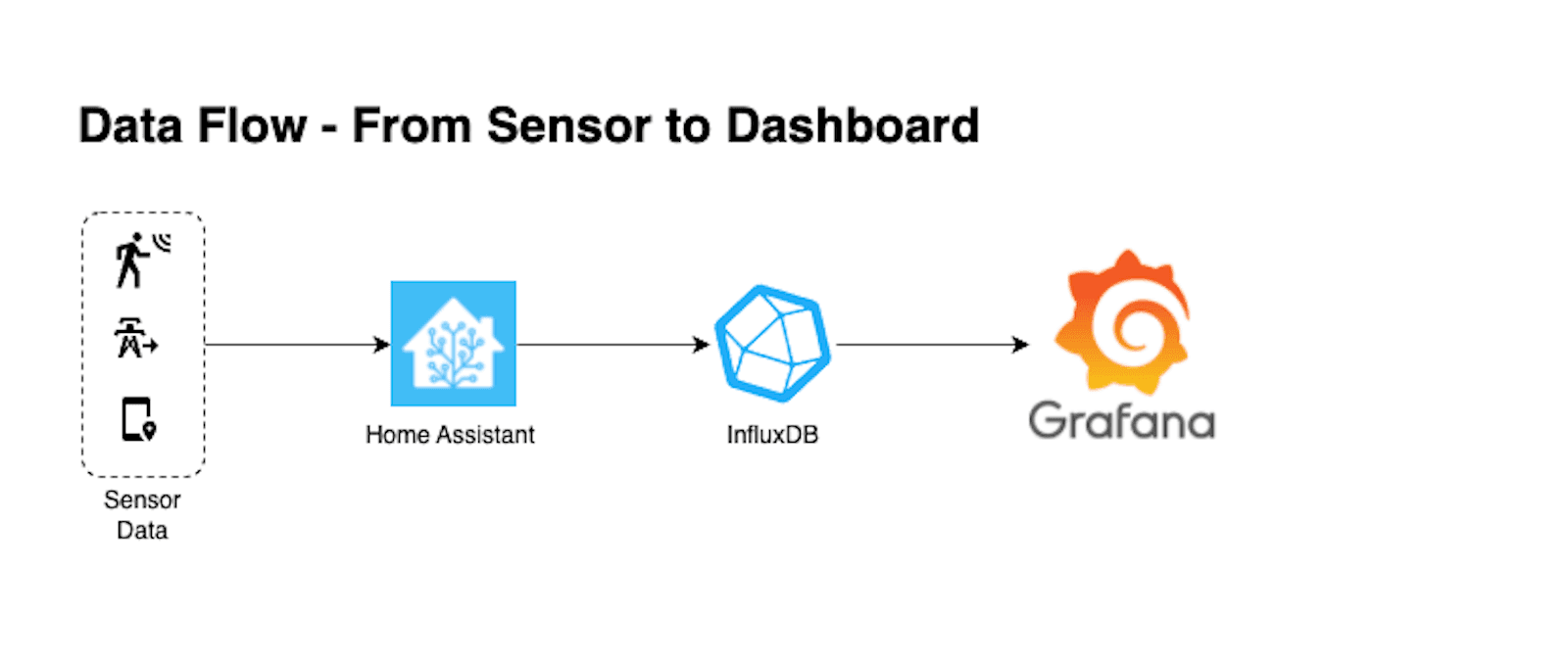

From Sensor to Dashboard
For my AAL project, I use an Intel NUC (nuc7pjyh). I chose Proxmox as an operating system because I also run some other virtual machines, like an Ubuntu Server. (The good thing about using virtual machines with Proxmox is that if you screw up something by writing code or installing packages, you just restore the backup of a virtual machine.)
On this NUC, there is also a VM with the Home Assistant Operating System (a Linux based operating system optimized to host Home Assistant and its Add-ons). Their add-on store is a very easy-to-handle docker environment, which makes installing a docker container like InfluxDB and Grafana really simple.
%3Aquality(100)%2F&w=3840&q=75)
You’re probably wondering about the sensor hardware I use. Well, it’s not that important because Home Assistant can handle the information of any motion sensor out there. It will create a sensor entity that can be used. However, the one thing you need to do is make sure the “time to next detection” is adjustable so you can ensure every motion — including re-entering a room in a very short time period — will be detected.

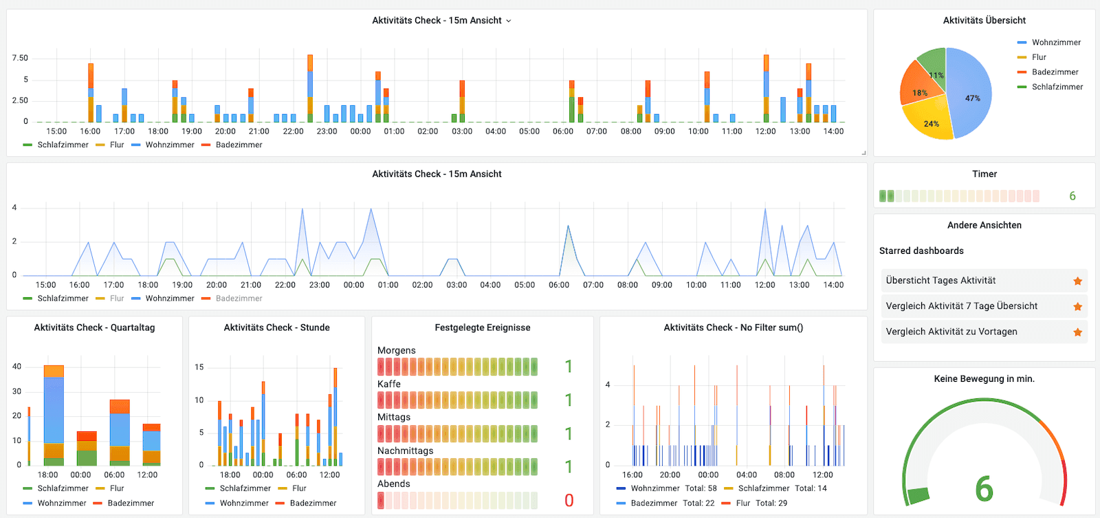

Here’s what an AAL activity dashboard looks like:
Let me break down some of the highlights and features of what you can observe and how you can get the most out of the dashboard.

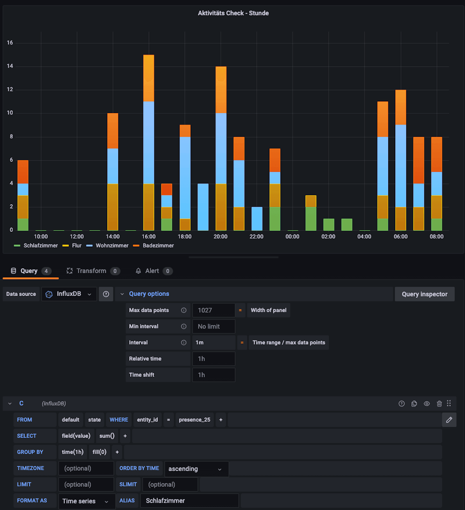

Interval and query options
The first feature that blew my mind was interval functionality. With a motion sensor, you only get binary data — 0 or 1 and a timestamp. In a graph, that information does not look very sexy, so you have to summarize the events by combining them into a time frame, e.g. 15 minutes. That will allow you to visualize each motion detected (1) in that specific time interval (15 min). For example, I can look at my father’s dashboard and see that there have been 30 movements in the Living Room from 10:00 until 10:15.

Alternative grouping method: Group by time
In Grafana, you can also use the Group By function (pictured below) in order to get results for a specific time period. Personally, I find the Interval function more useful, because if you begin to copy graphs to display different time periods (such as a weekly and monthly overview), you only have to change the time interval once for the whole graph. If you use Group By, only one query is affected.

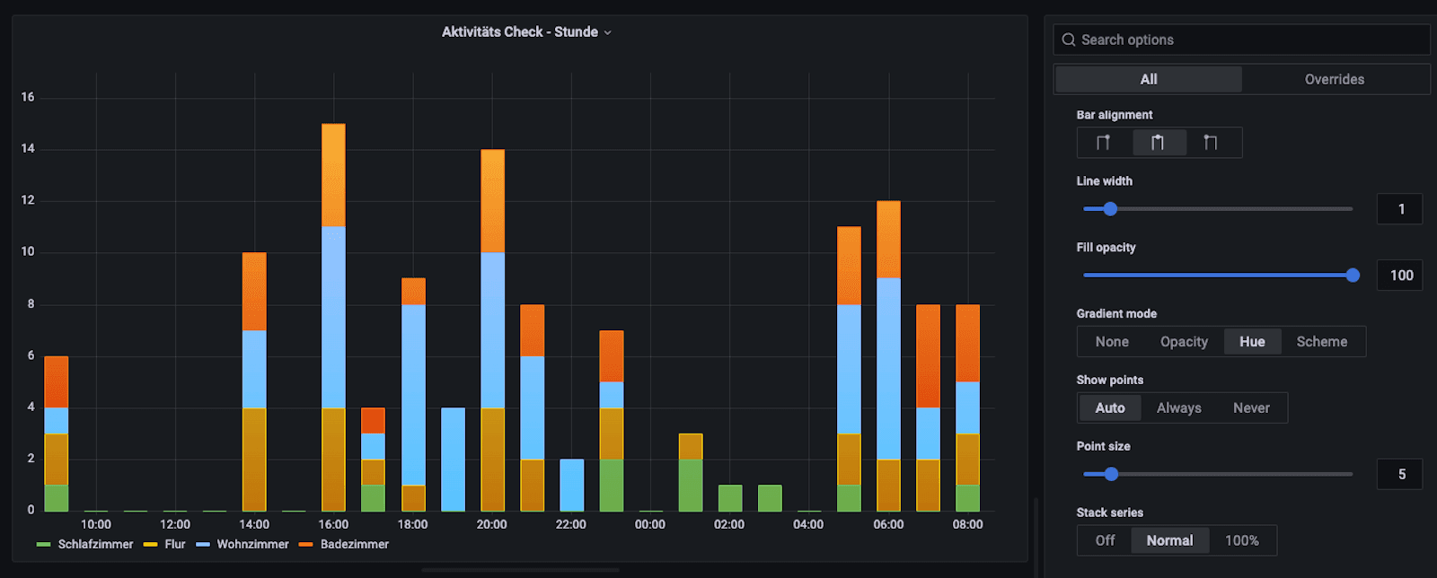

Stacking
Another feature I really like is that you can stack the bar graphs together. Using this method, the bars are added on top of each other so that you get a nice overview of the total movement in all rooms during a specific interval.
