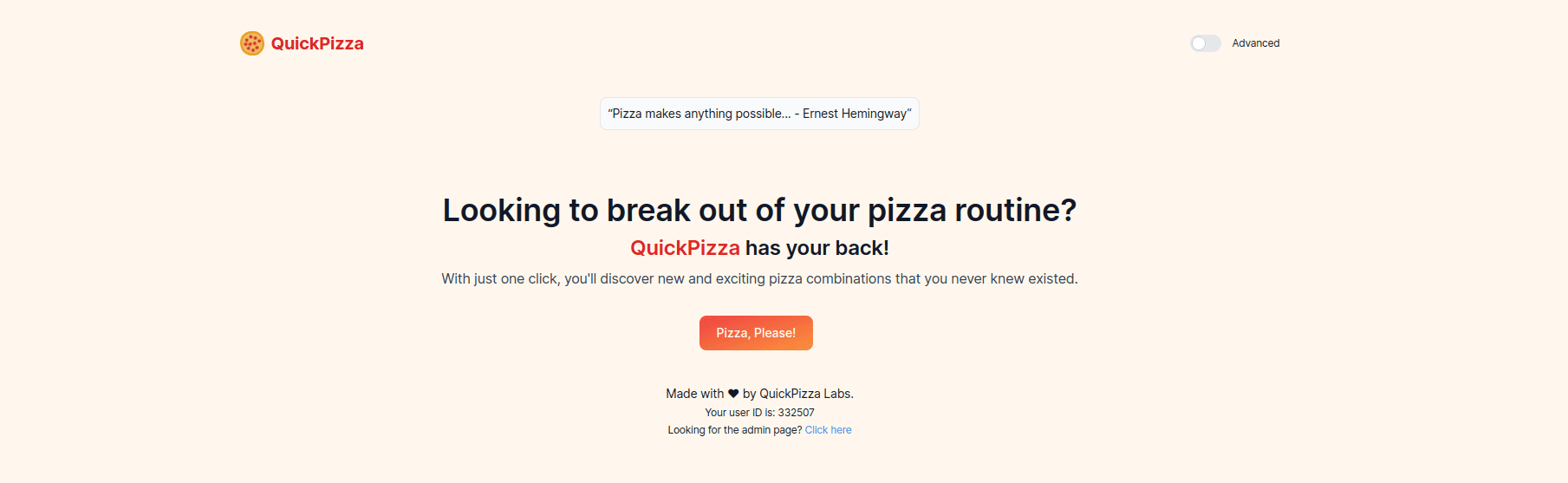

Let’s put ourselves in the shoes of an engineering team that works on 🍕 QuickPizza, a web application run by a VC-backed startup that goes by the same name. The goal of QuickPizza is to help end users deal with the often unbearable task of choosing which pizza to order. According to their CEO, they expect to disrupt the food market “by taking the burden of this choice from our customer, and enabling them to focus instead on what’s important: getting things done.”
A screenshot of the example QuickPizza application.

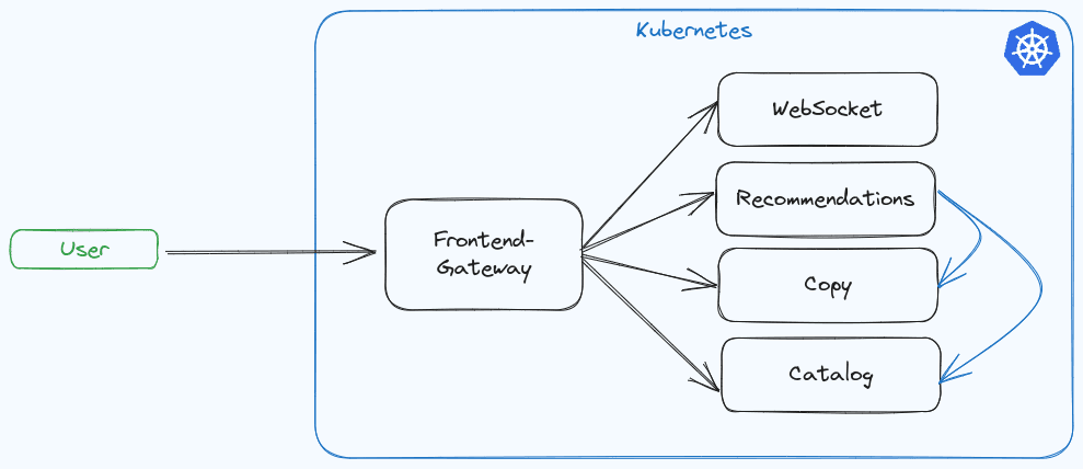

The QuickPizza application architecture consists of multiple services, running on Kubernetes, that talk to each other using HTTP:
A diagram of the QuickPizza application architecture.
For our example here, two of these services are especially important: Recommendations and Catalog.
As their names suggest, the Recommendations service is a sophisticated recommendation engine that suggests pizza combinations for users, while the Catalog service stores the different ingredients, like doughs and toppings, that can be used to make pizzas. The Recommendations service relies on and communicates with Catalog to retrieve the list of ingredients.
One team maintains the Recommendations service, and a separate team maintains the Catalog service.

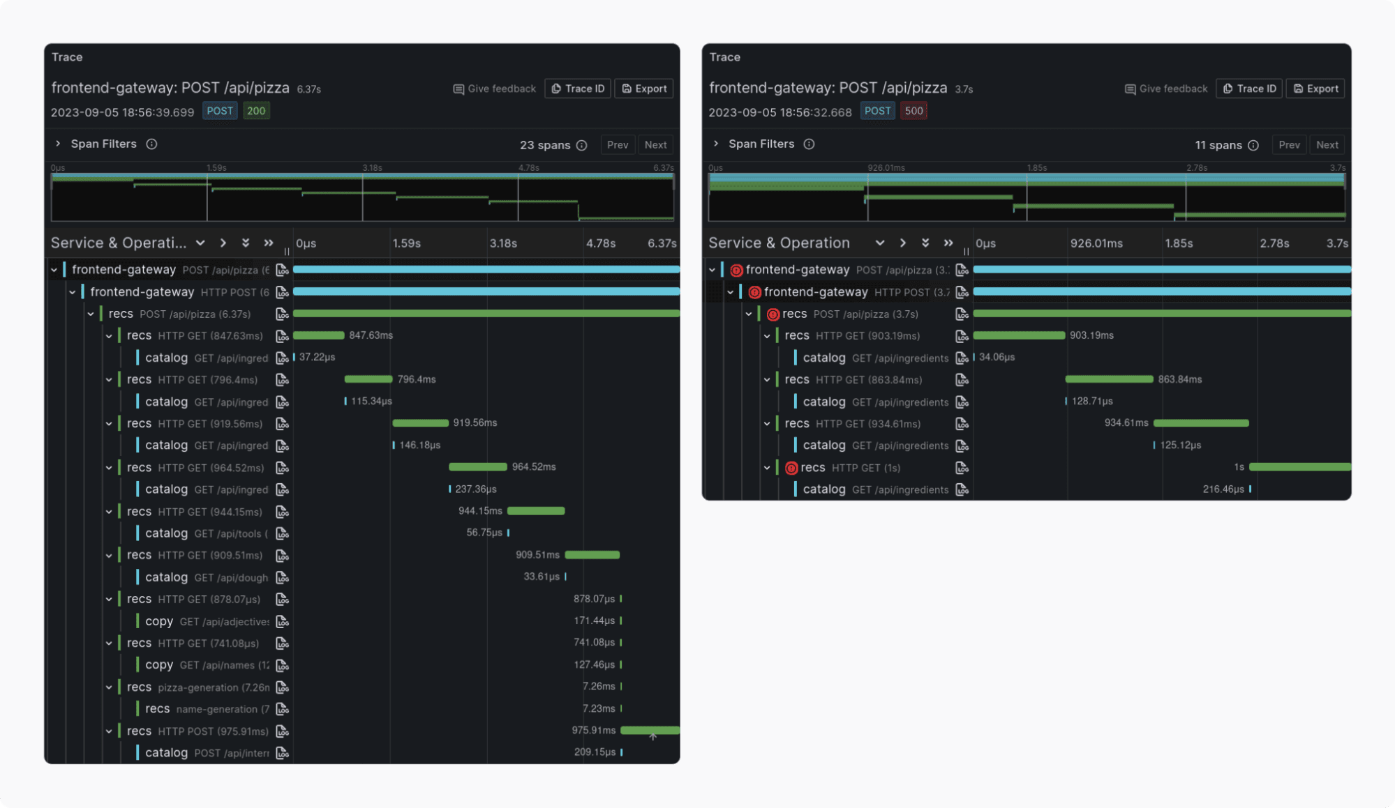

Something caught the attention of the Recommendations team: more than 50% of the requests failed. Given that they specified a latency of 900ms ±150ms, and that their service has a 1000ms timeout, this was surprising. Only a few requests, around 16%, should fall over 1000ms.

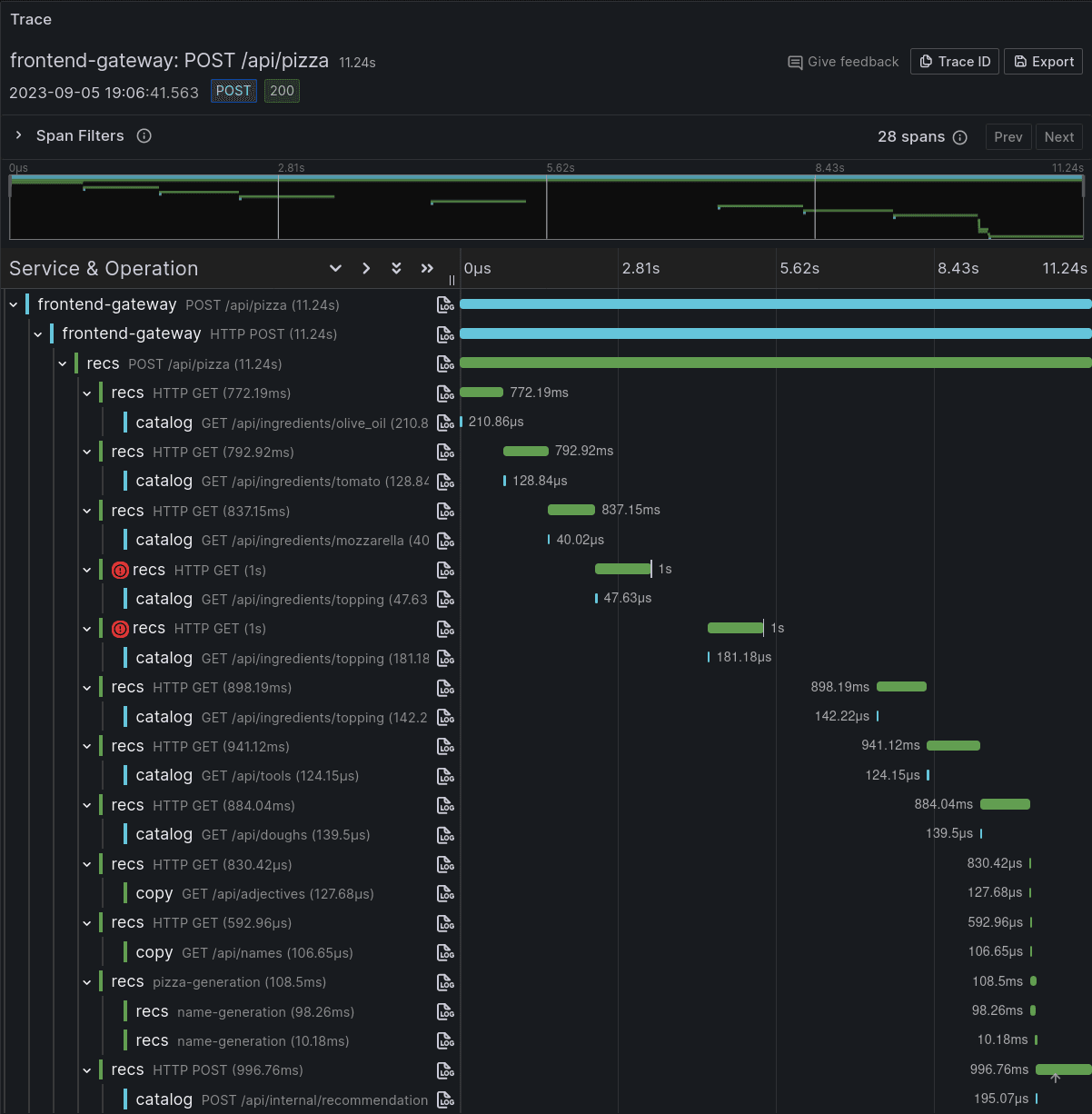

To better understand why this happened, the team jumped into Grafana Tempo to look at the traces generated by both a request that returned 200, and another one that failed and returned 500:
A screenshot of traces in Grafana Tempo.
Visualizing the traces for a request to the Recommendations service revealed why the end-to-end failure rate was higher than what we would expect for a single request: The Recommendations service actually makes several requests to the Catalog service, each with its own timeout. Any one of these requests failing would cause the Recommendations service to abort and return a 500 error.
This kind of failure amplification is very common in distributed systems.
