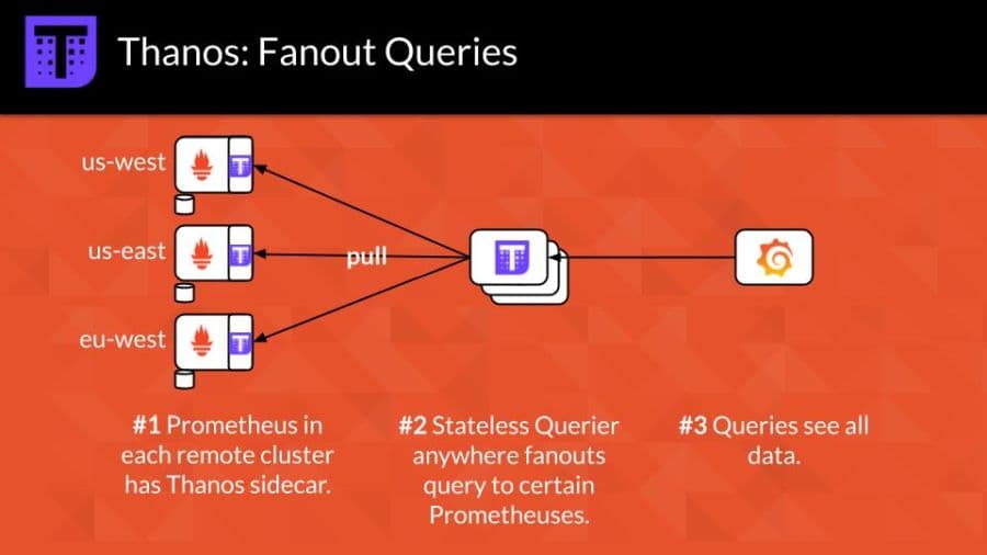

Thanos reuses your existing Prometheus servers in your existing clusters. A new stateless service, the Thanos Querier, “fans out” queries to these existing Prometheus servers. The existing Prometheus servers need an added sidecar (the Thanos Sidecar) deployed alongside them in order to handle these queries.

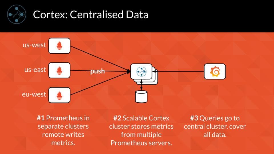

In Cortex, requests flow in the opposite direction – your existing Prometheus servers push data to a central, scalable Cortex cluster using Prometheus’ built-in remote-write capability. The central Cortex cluster stores all the data and handles queries “locally.”

This presents us with our first tradeoff: query performance and availability. With Thanos, chunk data must be pulled back from the “edge” locations to a central location where your Thanos queriers are running. If there is an interruption in this wide-area network, your query performance and availability will suffer. In the worst case, the latest 2 hours of data may not be available for querying. As Cortex relies on a push-based model for centrally aggregating the data, when an edge location becomes unavailable, all data up to that point is still available centrally. On the other hand, with Cortex you need to manage a separate Cortex cluster and storage on top of your Prometheus deployment – Thanos leverages your existing deployment.

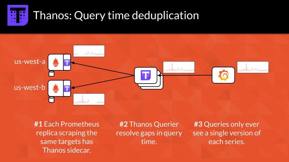

However, Thanos does! The Thanos querier will read from both replicas and combine the metrics into a single, no-gaps-included result. As the two replicas may naturally be slightly out-of-sync, Thanos uses a heuristic to determine which results to show to avoid gaps.

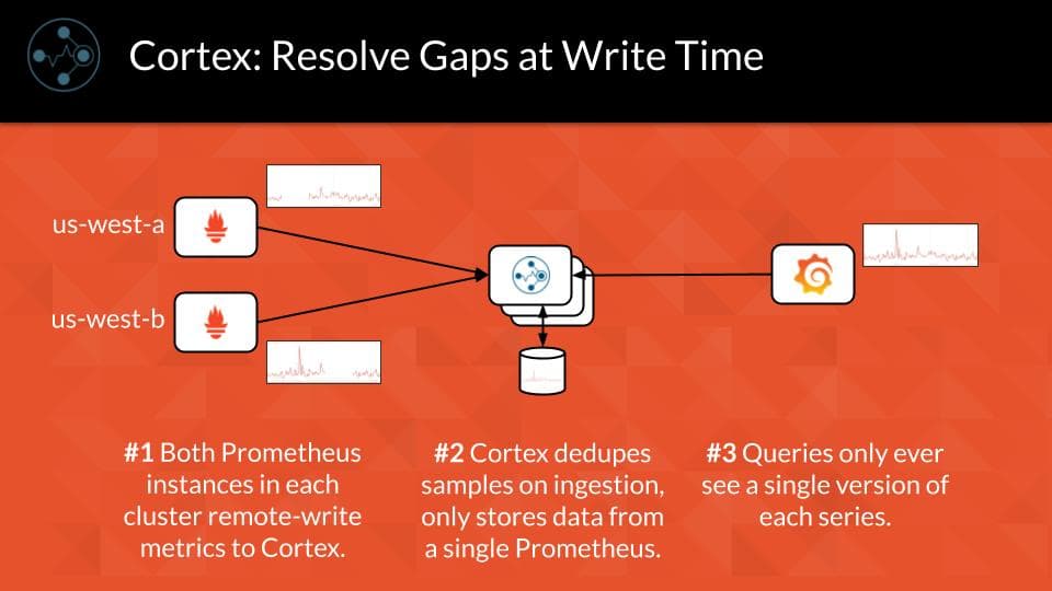

Cortex takes a different approach. As each replica is pushing samples to the central Cortex cluster, Cortex deduplicates the streams and only stores a single copy. Cortex relies on tracking the last push from each replica and using a simple timeout to “elect” the other replica as the master.

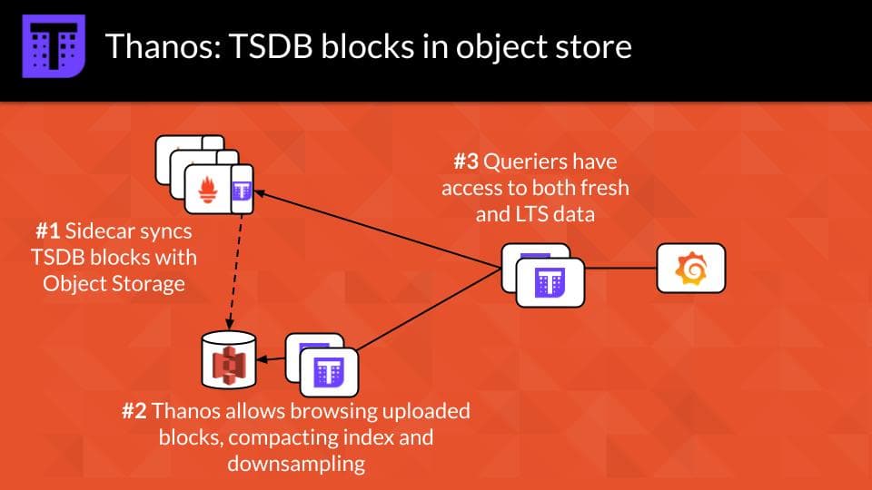

Thanos offloads Prometheus TSDB blocks to object stores; 7 different object stores are supported. Two-hour-long blocks are built locally and then uploaded to the object store by the Thanos sidecar. A separate microservice – the Thanos Store Gateway – is used to handle queries against the blocks in object storage. Responsibility for the durability of the blocks is offloaded to the object store – a wise choice, as replication and repair is difficult to get right.

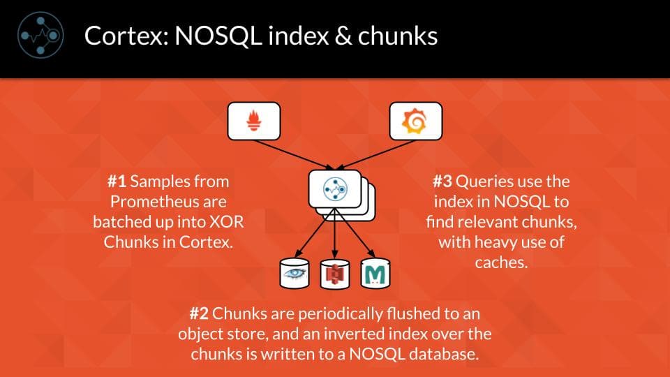

Cortex takes a similar approach, offloading the responsibility for durability and replication to managed services. The key differences are that Cortex stores individual Prometheus chunks in an object store and a custom index in a NoSQL store – recall that a TSDB block is a collection of chunks from multiple time series with an included index. At Grafana Labs, we store both the index and the chunks in a Google Bigtable cluster, although both Cassandra and AWS DynamoDB are supported.

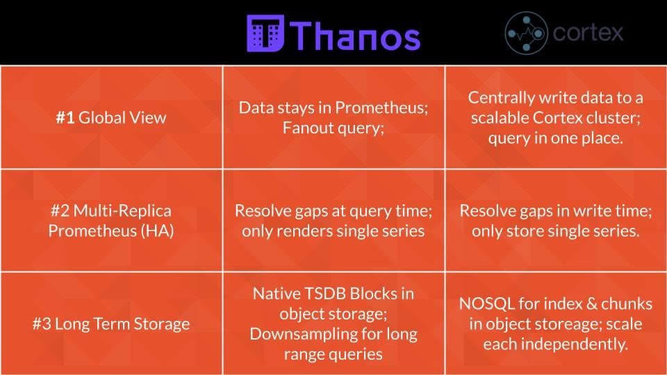

When comparing these approaches it boils down to two things: cost and performance. Both systems use managed services, and both systems can be run with a single dependency. Managed NOSQL stores (such as Google Bigtable or AWS DynamoDB) tend to cost more per GB stored than object stores (such as Google Cloud Storage or AWS S3), although they tend to cost less per IOP. This does tend to lead to a higher TCO for a Cortex-style system than a Thanos-style system. On the other hand, using a NOSQL store for the index in Cortex gives it an edge when it comes to query performance and scalability.
