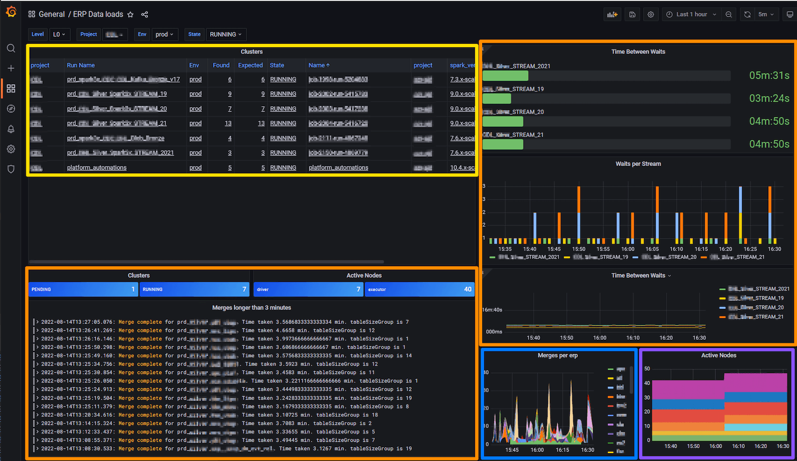

We’ve configured our main Grafana dashboard so we have access to all of this information across dozens of jobs in one screen.
Below, the panel highlighted in yellow shows cluster and job status; the orange one contains job performance data; the blue has ERP distribution; and the one outlined in purple is where we can see how many nodes are active in this environment over time.
Here’s a closer look at what we are observing:
Cluster performance
In the Clusters Panel (outlined in yellow), we can see information comparing the responses from the Job Controller (Databricks API) and information gathered from the jobs by the Grafana Agent. We compare the Expected and Found columns to alert if the cluster isn’t healthy. The bottom right panel shows the same information in a stacked chart, which has a direct correlation to how much we are spending on compute at any moment in time.
Job performance
In the section highlighted in orange, we monitor the performance of the load jobs themselves — specifically merges longer than three minutes. You can see raw log lines, which are aggregated into Prometheus using Loki recording rules but are also still available to view from Loki.
We find Grafana’s unique ability to have both the raw data and the aggregates correlated across metrics and logs extremely powerful, and we have used it in multiple parts of our solution.
Dozens of megabytes of logs are written per minute by the processing nodes, and among them are lines that tell us when a stream job completes a cycle. We have a strong SLA per stream of 15 minutes per cycle, and in this dashboard we can view current and historic performance as well as generate alerts.
We use Loki’s recording rules to capture this information in Prometheus for both quick display and trend analysis. We found those rules to be extremely useful, enabling time series calculations on log information that just wouldn’t be possible (or at the very least extremely slow) with just a logging solution.

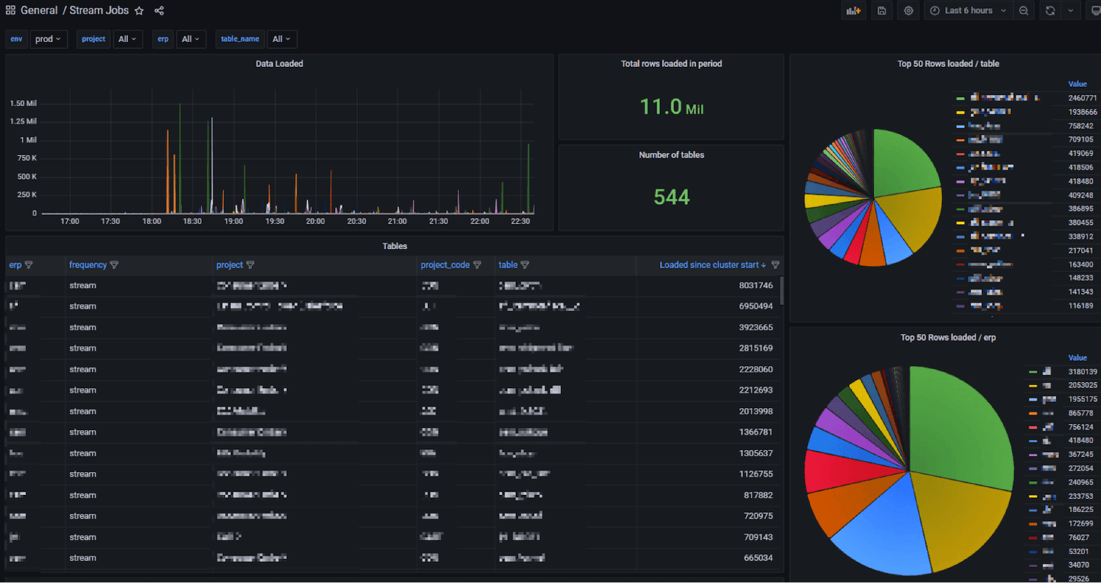

To monitor tables and ERP distribution, we built separate drill-down dashboards that aggregate information while allowing us to filter to see only one project or even a specific table. Here’s an example:
With these two dashboards, we are able to not only control operations, but we also feed back insights to development teams so they tune the loads based on actual production performance. We’ve been able to cut cycle time by more than threefold in six months, increasing the freshness of data used for decision making. At the same time, we’re able to alert on any slow-downs or connection problems with any of the data sources.

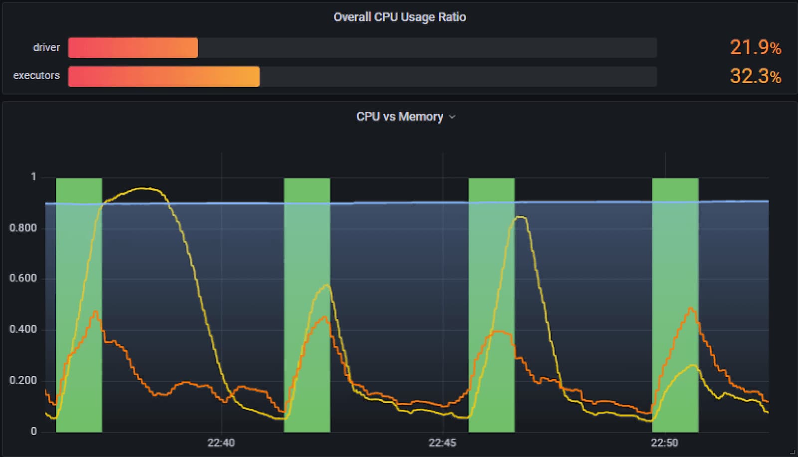

Below you can see the heartbeat of a stream job, which displays CPU and memory information from Prometheus along with merge timestamps collected from Loki, all in one graph. In this panel, we also monitor overall CPU usage over time.
With the insights the rich Grafana visualization provides, we were able to help the development teams focus their optimization efforts, achieving SLA while reducing costs by 40%.

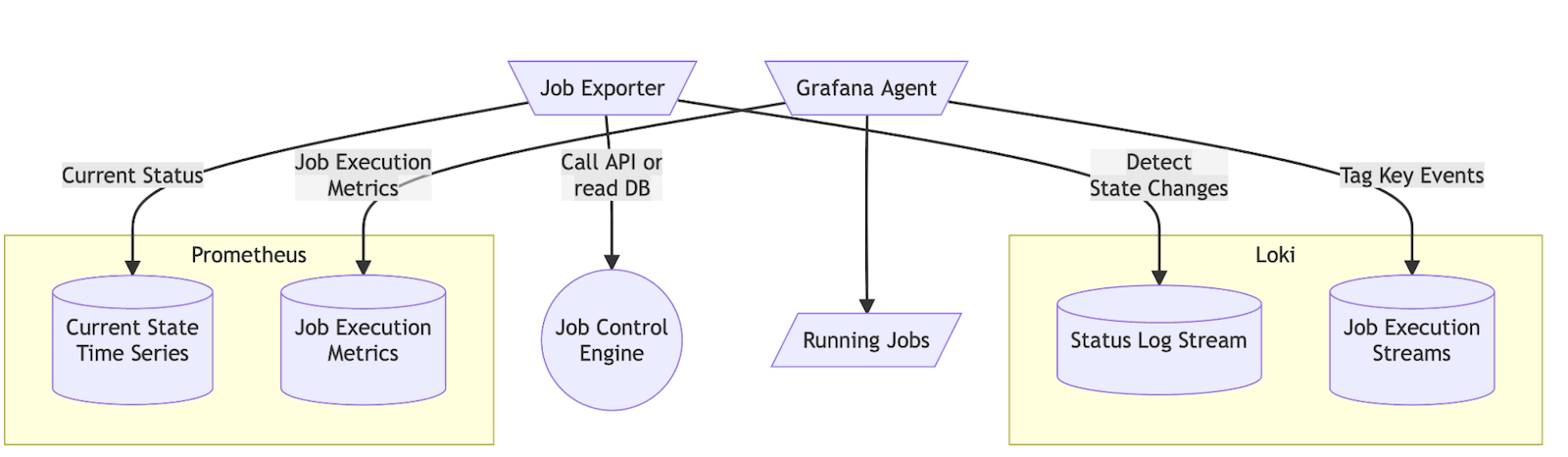

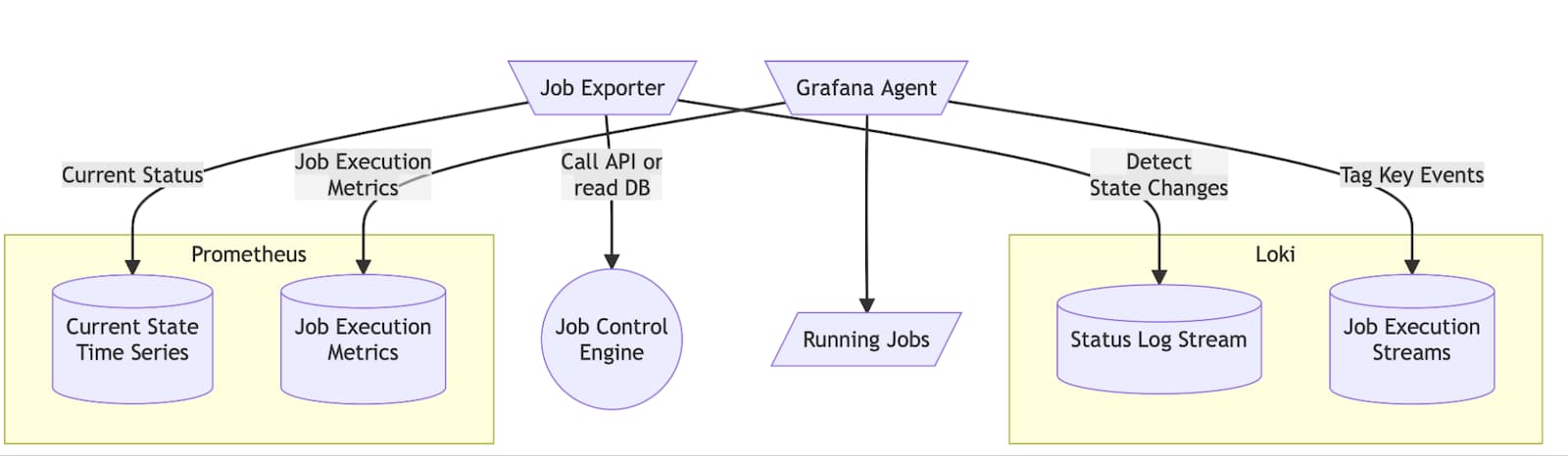

The abstraction is based on the following data flow, replacing Job Control Engine with any of the above.
We have four flows of information which are seamlessly integrated with Prometheus and Loki by using labels in Grafana.
In Prometheus, we store two flows:
- Current job execution status information stored in Prometheus metrics (avoiding high cardinality items like job id or table)
- Metrics collected by the Grafana Agent and jmx exporter
In Loki, we split information into two main log streams:
- Status log stream (this has the high cardinality metrics as well as all information collected on the job execution as a json payload)
- Job execution streams (tagging key execution lines using Promtail built into the Grafana Agent)
All four flows are seamlessly integrated through labels that identify which job execution they came from.

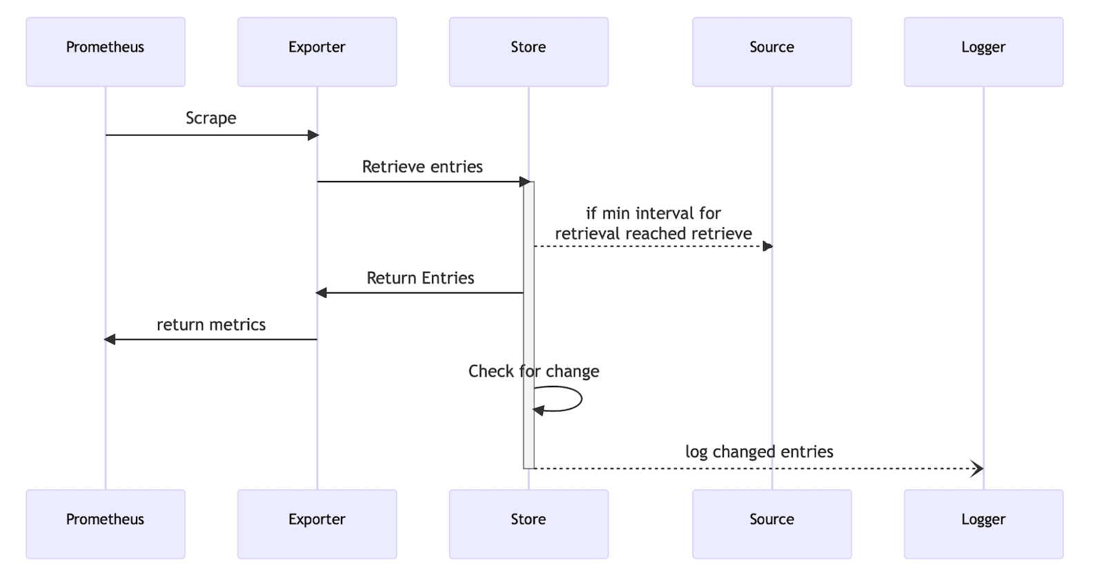

The job_exporter reads current state for jobs from APIs or databases and writes the low cardinality data to Prometheus. At the same time, it is also detecting state changes which it writes to logs in Loki with the same labels. Together with the state changes, we write the full payload of information to logs that are collected by Loki. This would cause a cardinality explosion if written to Prometheus, yet it remains easily accessible in Loki.
The exporter consists of the following dynamic configured actors that are configurable at start time in a yaml file:
- Exporter: a Prometheus exporter implementing a probe and metrics endpoint
- Store: an in-memory cache that allows us to avoid calling a source when we would exceed API quotas
- Logger: this writes a json log of mutations, including the whole payload discovered
- Source: named sources that implement the data collection specific to each job engine and map it to the generic framework
The following diagram shows the interaction between the different actors:
