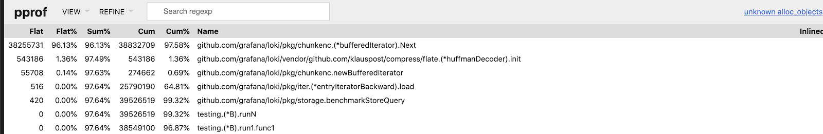

You can quickly find what is allocating memory with pprof alloc_space and alloc_object memory traces, and you want to start reducing those with the highest allocation rate. In Loki we found out that creating a gzip reader and a line buffer for every chunk was allocating a lot of objects.
Embedded image
This image shows an example of the top view for alloc_object (go tool pprof -http :8080 -sample_index=alloc_objects memprofile.out). Our buffered iterator’s Next function was allocating the most.

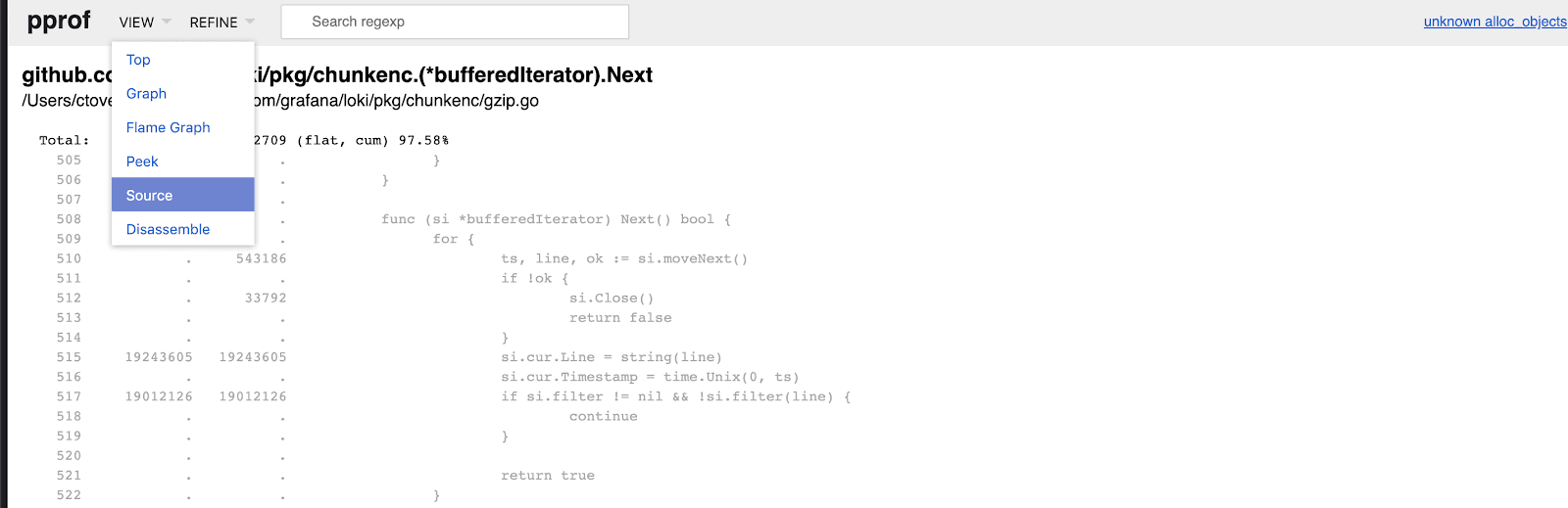

When looking at alloc_object top functions, you can select an item and use the source view to see the details of total allocations within your code.
Embedded image
This is how we realized that when filtering lines via regex using LogQL, a lot of allocations were wasted. The Go regex package is mostly popular when working with strings, but in our case our line buffer is a slice of bytes. Converting that buffer to a string creates a copy that we might ultimately throw away if the regex doesn’t match. Turns out there is another method: accepting slice of bytes, which helped us reduce unnecessary allocations.

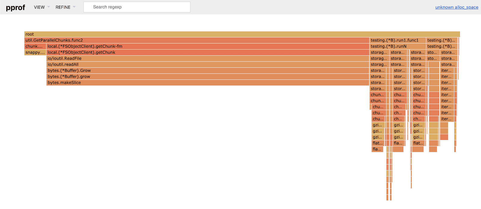

I like to use the flame graph, as it gives you a quick overview. This one is after optimization. We can clearly see that most of the allocated space now comes from fetching chunks.
Reducing the memory traffic (allocations over time) was a first step, but we could still see high usage of memory – which means we were probably leaking memory.
