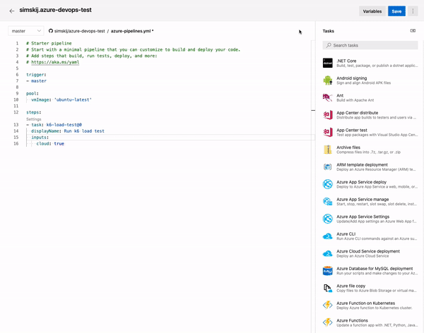

Running your tests in our cloud is transparent for the user, as no changes are needed in your scripts. Just add cloud: true to your pipeline configuration.
To make this script work, you need to get your account token from Grafana Cloud k6 and add it as a variable. The Azure Pipeline command will pass your account token to the Docker instance as the K6_CLOUD_TOKEN environment variable, and k6 will read it to authenticate you to Grafana Cloud k6 automatically.
A gif showing how the token is used to authenticate you to Grafana Cloud k6.

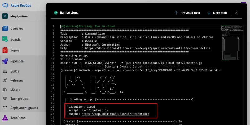

By default, the Azure Pipelines task will print the URL to the test result in Grafana Cloud k6, which you may use to navigate directly to the results view and perform any manual analysis needed.
A screenshot of the URL to the test run.A screenshot of the test results.
