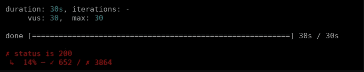

Usually, we should start with somewhat modest loading (e.g. 2-5 Virtual Users), to get a grasp on the system’s baseline performance and work upwards from that. But suppose we are new at this and we also feel a bit optimistic, so we reckon we should start a load test of the above script with 30 Virtual Users (VUs) for a duration of 30 seconds.
We execute the k6 test with the aforementioned parameters:
k6 run -d 30s -u 30 ./script.js
The below partial output of our load test indicates there is an error.
We see that only 14% of our requests were successful. This is abysmally low!

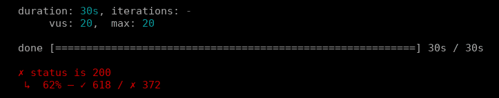

This produces:
OK, things improved a lot, but still, 38% of our requests timed-out. We proceed by increasing the sleep value for each VU to 1 second:

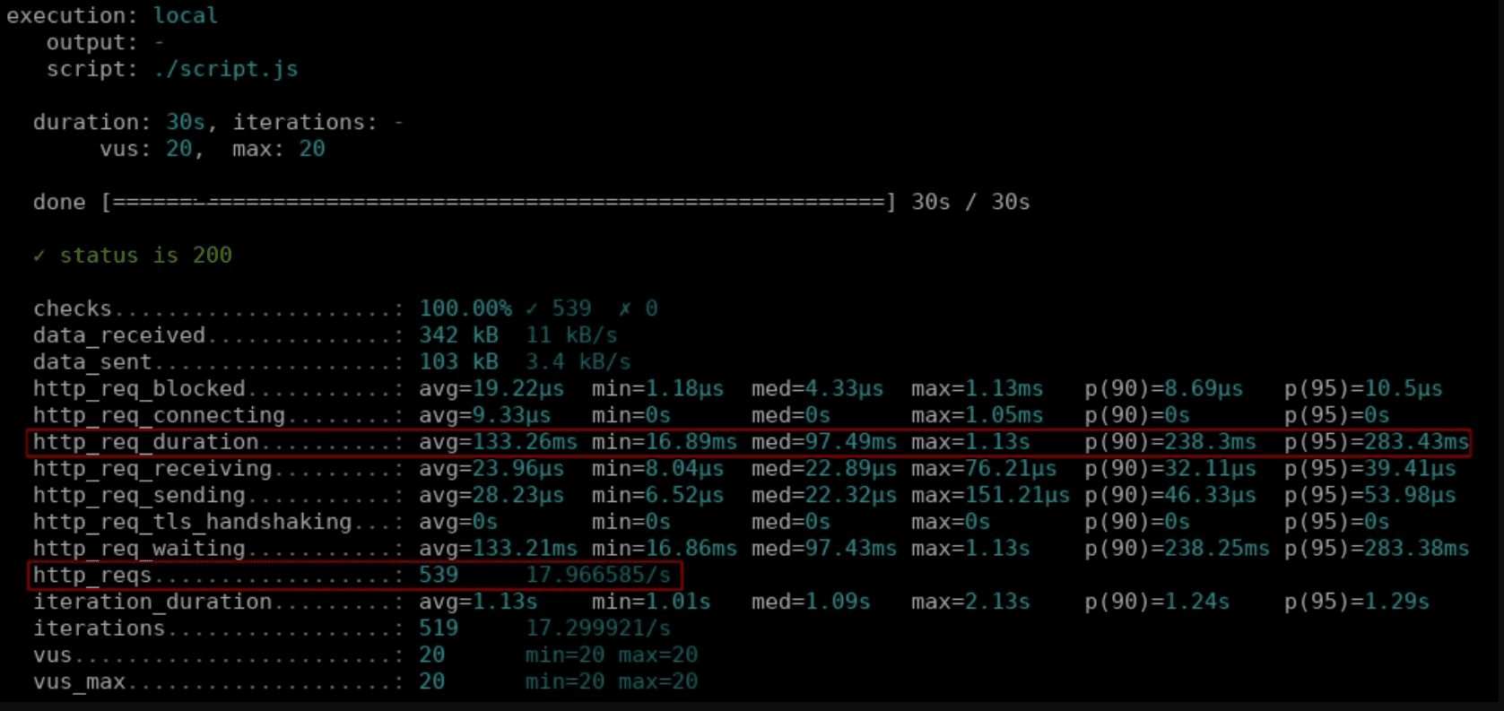

And we rerun the test, while keeping the same number of VUs:
k6 run -d 30s -u 20 ./script.js
This produces a more desirable outcome for our system:
Some things we notice from the above output:
- All requests finished in a timely manner, with the correct status code
- 95% of our users got served a response in under 283.43ms
- In the 30 second test duration we served 539 responses, at a rate of ~18 requests per second (RPS)
Now we have a better idea of the capabilities of this endpoint when responding to GET requests, in our particular environment.

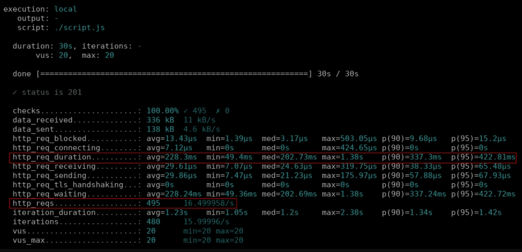

Armed with experience from our previous test runs, we decide to keep the same VU and sleep time values when running the script:
And this produces the following results:
We notice from the results above that we managed to serve all POST requests successfully. We also notice there was an increase in the duration of our responses and a decrease in the total number of requests we could handle during a 30 second test duration. This is to be expected though, as writing to a database will always be a slower operation than reading from it.
