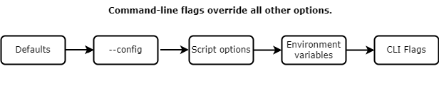

Task 1: Override options
Goal: Understand the different ways to configure k6 options
Docs: k6 Options
This was a good warm up. I knew about the k6-option lookup order, because I keep changing the diagram. (I can’t ever decide how to represent precedence: with equality operators? Through arrows? Through some sort of vertical and horizontal positioning?)
Use the basic script to see default VUs, duration, and iterations.
The basic script has one virtual user (VU) run the default function for one iteration:
k6 run script.js
Override defaults in exported script options
Now, I can add options to the script in an options object.
Solution: Options in script
import http from "k6/http";
import { sleep } from "k6";
export const options = {
vus: 2,
iterations: 2,
duration: "10s",
export default function () {
http.get("https://test.k6.io");
sleep(1);
k6 run options/script.js
Override them using environment variables
This script still has exported options, but the environment variables override them.
Solution: Set options with environment variables
K6_ITERATIONS=3 K6_DURATION="20s" K6_VUS=3 k6 run options/options.js
Override them using command-line flags
I’m keeping the environment variables in to emphasize the “override” part of this challenge.
Solution: set options with CLI flags
K6_ITERATIONS=3 K6_DURATION="20s" K6_VUS=3 \ #flags override these
k6 run --vus 4 --duration "30s" --iterations "4" options/options.js

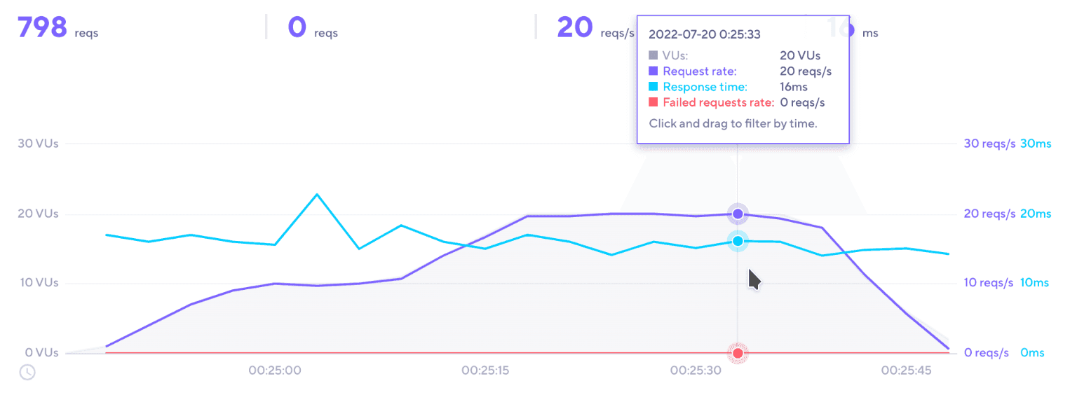

I guess it worked, but I’m not sure how to check. Visualization would confirm the ramping structure…
Run the same test on the cloud and visualize the ramping
Overall, I expect that stages that have these values:
tages : [
{ duration: "10s", target: 10 },
{ duration: "10s", target: 20 },
{ duration: "20s", target: 20 },
{ duration: "10s", target: 0 },
…should have a request-per-second throughput that looks something like this:
xxxxxxxxxxxxxxxxxxxxxxx
xxx xx
xxx xx
xxxxxxx xx
xx xx
xx xx
xx xx
Let’s see:
k6 cloud stages.js
Here’s how this test looked in the cloud:

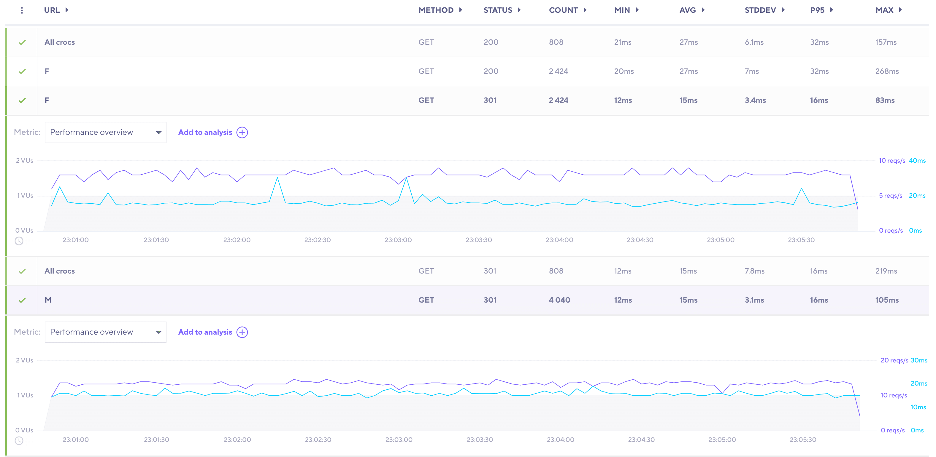

Group dynamic URLs and visualize the test on k6 Cloud
By default, each requested URL is going to have its own tag. This can create a big mess with dynamic URLs.
Of the crocodile objects, the sex property was the only one that had repeated values. That seems like a good candidate for a name.
Solution: group dynamic URLs
const response = http.get("https://test-api.k6.io/public/crocodiles", {
tags: { name: "All crocs" },
const crocs = JSON.parse(response.body);
crocs.forEach((croc) => {
http.get(`https://test-api.k6.io/public/crocodiles/${croc["id"]}`, {
tags: { name: `${croc["sex"]}` },
k6 run --out json=grouped_crocs.json api/grouped.js
Now, to run it on the Cloud:
k6 cloud api/grouped.js

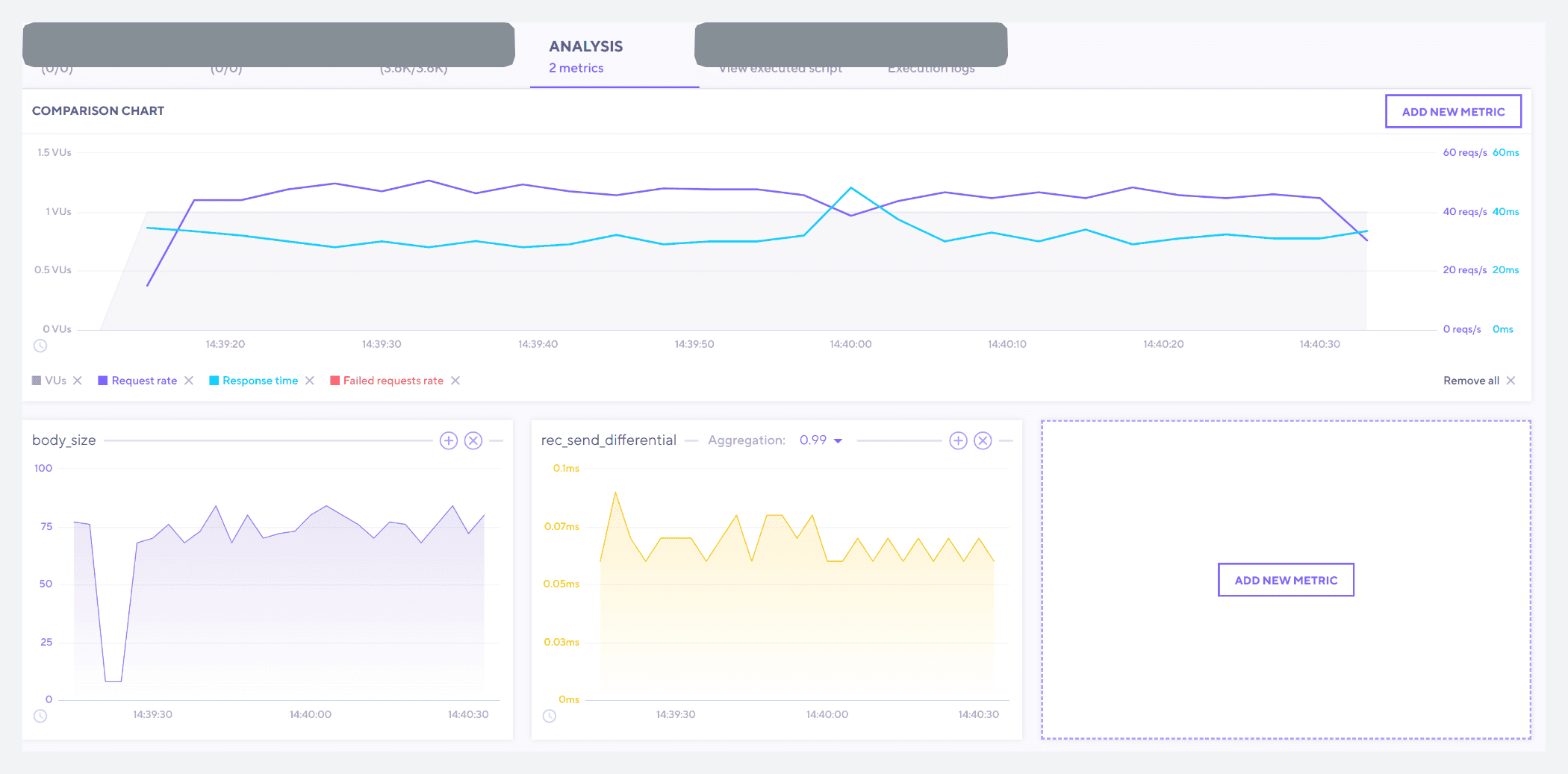

This time, I had to dig into the docs. I couldn’t figure out what a good metric would be or how to find data to make a metric from.
I looked at the example and noticed a timings object. I assumed these timings were built into JavaScript, like forEach (now, from a distance of a few weeks, I can look back and laugh at how naïve I was).
I then discovered that k6 has a Response module whose data k6 uses to create metrics. I wondered why the metrics page wouldn’t mention that. Then I noticed a truncated reference for the Response object, in a table on the same page that I’d been looking at. I scrolled past this table at least ten times, and it’s not a long page.
I should be embarrassed by that, but more I wonder whether I can make the docs clearer here. Like most people, I scan up and down a page, looking for what I need. A good document should respect that people rarely read whole pages.
Create one or two types of custom metrics (Counter, Gauge, Trend, Rate)
I decided to make two metrics:
- A gauge to save a maximum value
- A trend to make a p99 value
The gauge wasn’t hard, but it took me so long to make a trend metric that didn’t seem trivial. Finally, I came up with the idea of making a differential between sending and receiving time. Maybe this is still trivial, but I think it works (in the sense that it doesn’t throw errors or emit evidently junk data).
Solution: custom gauge and trend metrics
import { Gauge, Trend } from "k6/metrics";
const bodySize = new Gauge("body_size");
const recMinusSend = new Trend("rec_send_differential");
thresholds: {
rec_send_differential: ["p(99.9)<1500"],
let response = http.get("https://test-api.k6.io/public/crocodiles", {
gaugeSize(crocs.length);
timingsDuration(response);
const crocLength = JSON.parse(response.body.length);

See the results on the console and Cloud
Results on the console:
Look for rec_send_differential:
k6 run --iterations 20 metrics/trend.js
running (01m15.5s), 0/1 VUs, 20 complete and 0 interrupted iterations
default ✓ [======================================] 1 VUs 01m15.5s/10m0s 20/20 shared iters
body_size......................: 80 min=8 max=84
data_received..................: 129 kB 1.7 kB/s
data_sent......................: 55 kB 723 B/s
http_req_blocked...............: avg=4.68ms min=1.95µs med=8.29µs max=501.54ms p(90)=13.34µs p(95)=16.16µs
http_req_connecting............: avg=2.22ms min=0s med=0s max=237.32ms p(90)=0s p(95)=0s
http_req_duration..............: avg=204.83ms min=169.09ms med=204.31ms max=308.28ms p(90)=222.6ms p(95)=249.09ms
{ expected_response:true }...: avg=204.83ms min=169.09ms med=204.31ms max=308.28ms p(90)=222.6ms p(95)=249.09ms
http_req_failed................: 0.00% ✓ 0 ✗ 360
http_req_receiving.............: avg=132.43µs min=42.22µs med=137.35µs max=458.75µs p(90)=188.43µs p(95)=216.65µs
http_req_sending...............: avg=39.48µs min=10.59µs med=42.3µs max=146.95µs p(90)=56.4µs p(95)=64.13µs
http_req_tls_handshaking.......: avg=2.42ms min=0s med=0s max=261.71ms p(90)=0s p(95)=0s
http_req_waiting...............: avg=204.66ms min=169ms med=204.15ms max=308.05ms p(90)=222.48ms p(95)=248.94ms
http_reqs......................: 360 4.767042/s
iteration_duration.............: avg=3.77s min=3.56s med=3.68s max=4.34s p(90)=4.09s p(95)=4.1s
iterations.....................: 20 0.264836/s
rec_send_differential..........: avg=0.099752 min=-0.002987 med=0.102304 max=0.258276 p(90)=0.162797 p(95)=0.18427
Results on the cloud:
I’m cranking up the iterations here, so the graph has more obvious data points.
k6 cloud --iterations 200 metrics/trend.js
Of the many ways to aggregate the data, this chart compares the metric’s p99 values.
