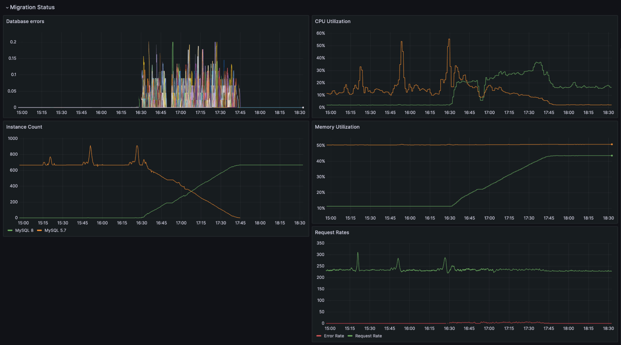

Using a Grafana dashboard to monitor progress 📈
We created a Grafana dashboard to monitor the rollout of the migrations for each cluster. This dashboard tracked how many instances were running on the source and target database servers, instances with a high database error rate, and database server resource utilization. It was important to keep an eye on CPU usage, since MySQL 8 uses a bit more CPU than MySQL 5.7 (about 5-10% more, from what we saw).
%3Aquality(100)%2F&w=3840&q=75)
