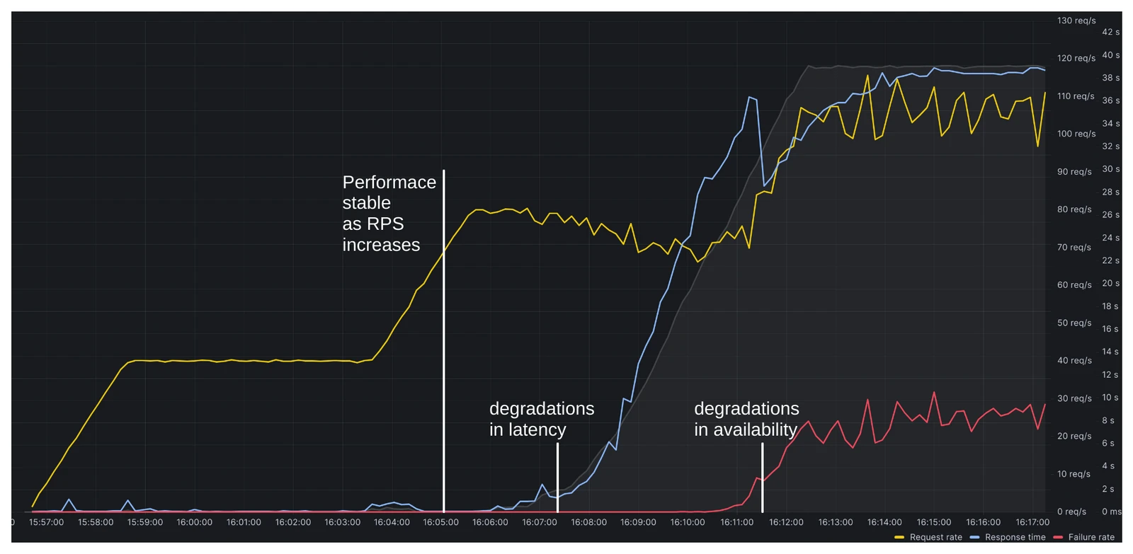

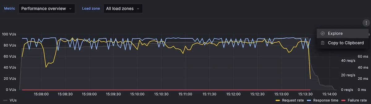

Healthy performance often looks flat
Healthy performance is generally stable. In visualizations, stable behavior manifests in flat, horizontal lines.
One common visual comparison is between throughput and request duration or error rate. For example, if the system remains available under increasing load, the error rate should follow a horizontal trend even as the number of requests per second (RPS) increases. If the system loses availability under load, the error rate should increase with RPS.
Often, the availability and latency of a system remain stable up to a certain load, then degrade sharply. This degradation would manifest as a sharp upward trend in the graph. In some performance-test literature, this pattern is called the knee.
A screenshot of annotated k6 results analysis in a Grafana dashboard.

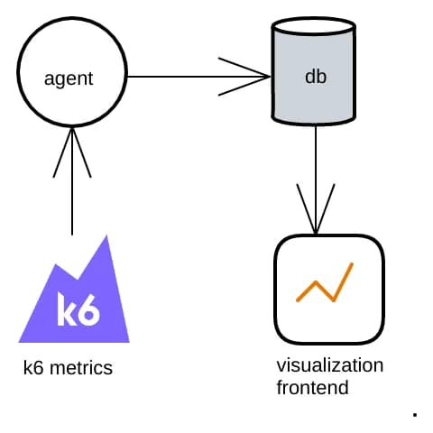

Thus, you can choose the structure and frontend that fits your workflow. For example, in this diagram of a generic workflow:
  1. k6 outputs metrics in some format and sends the metrics to an agent that can receive that format.
  2. The agent forwards the metrics to be stored in a database.
  3. The frontend queries the database and visualizes the output.
A diagram shows a flow from k6 metrics to an agent to a database to a visualization frontend

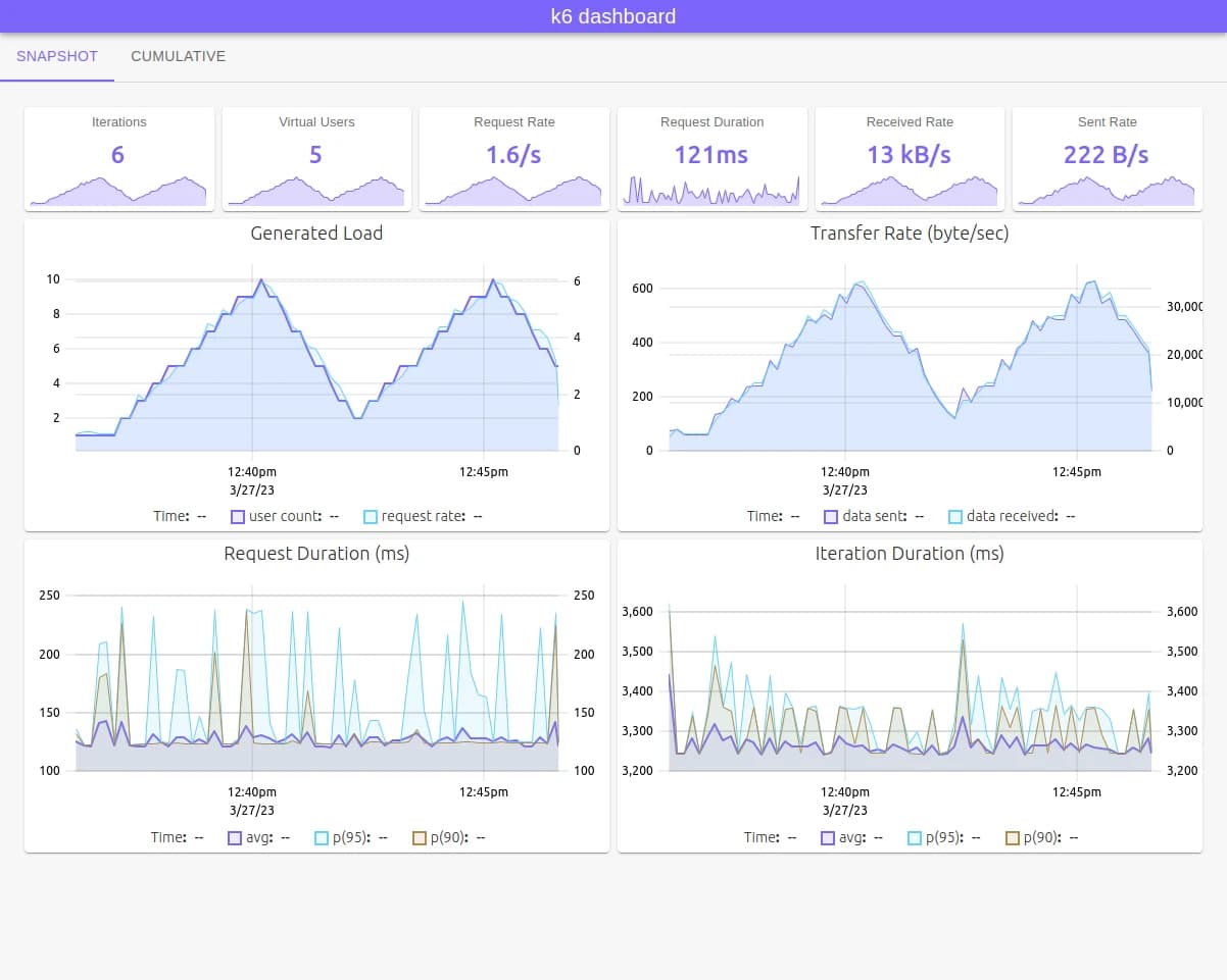

Server-sent events with xk6-dashboard.
For the first visualization, we want to highlight a great community project, xk6-dashboard. The dashboard runs a local web server that visualizes metrics as the test runs.
A screenshot of an xk6 dashboard
You can use it as you would use any extension:
  1. Download xk6:
  2. Build the binary:
  3. Run the test with the custom binary, using dashboard as the argument for --out.
    ./k6 run --out dashboard script.js
  4. Visit the dashboard on your localhost and view results as they appear. The default is http://127.0.0.1:5665/
For the latest instructions, visit the xk6-dashboard repository. If you want to make your own visualization tool, the source code for the xk6-dashboard may serve as inspiration.

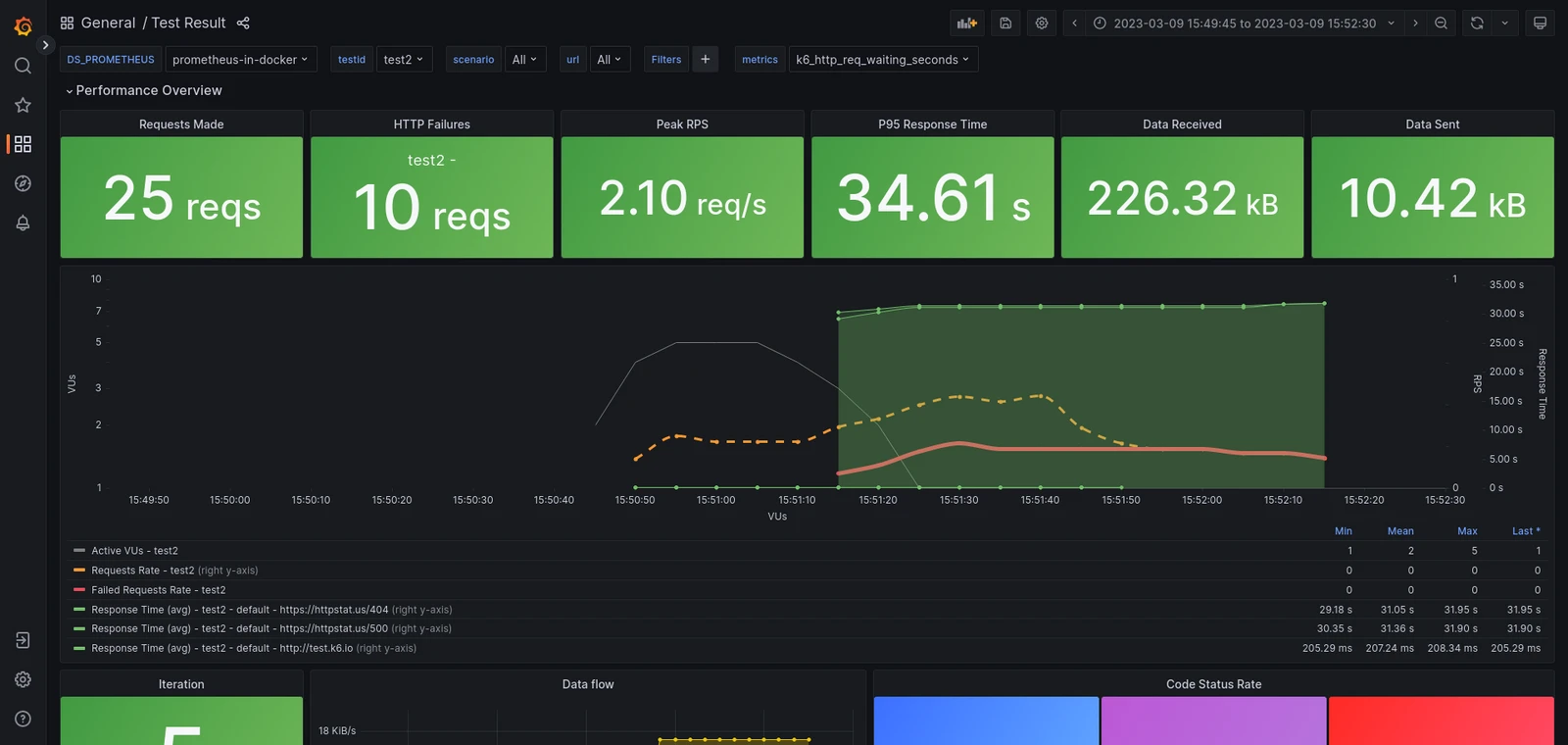

For visualization, one option is with Grafana — either Grafana Cloud or in a self-hosted instance.
A screenshot of test results visualized in Grafana
For detailed instructions about sending metrics in remote-write and visualizing data, refer to the k6 documentation about Prometheus remote-write.

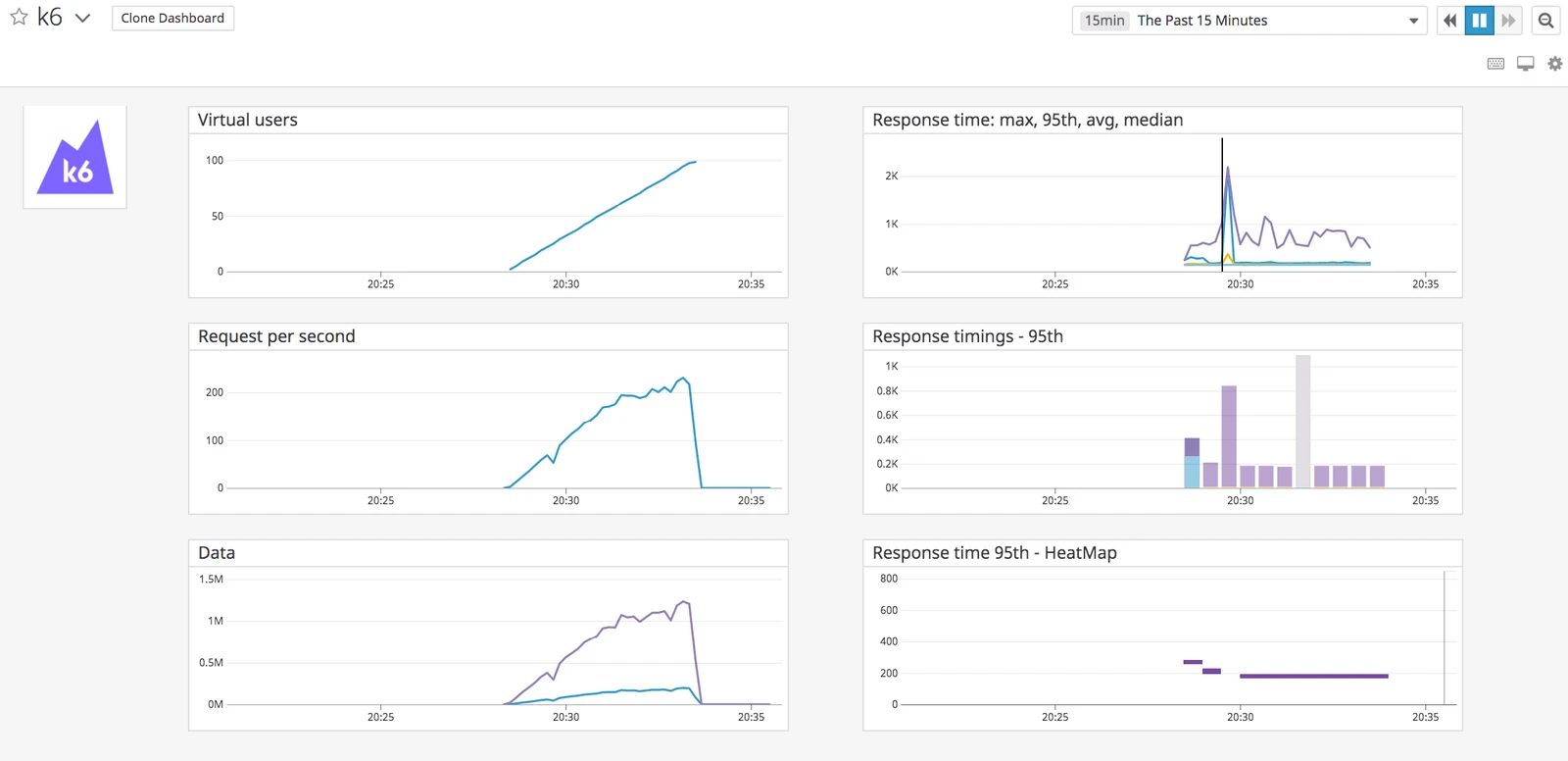

Datadog
A screenshot of Datadog metrics visualized in k6

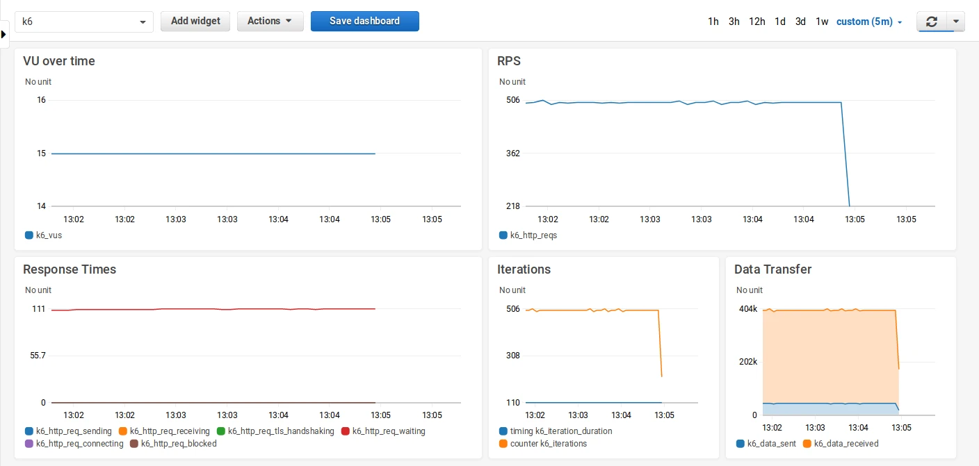

Amazon CloudWatch
A screenshot of CloudWatch metrics visualized in k6

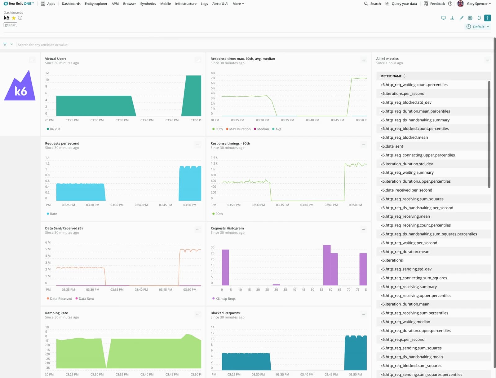

New Relic
A screenshot of New Relic metrics visualized in k6

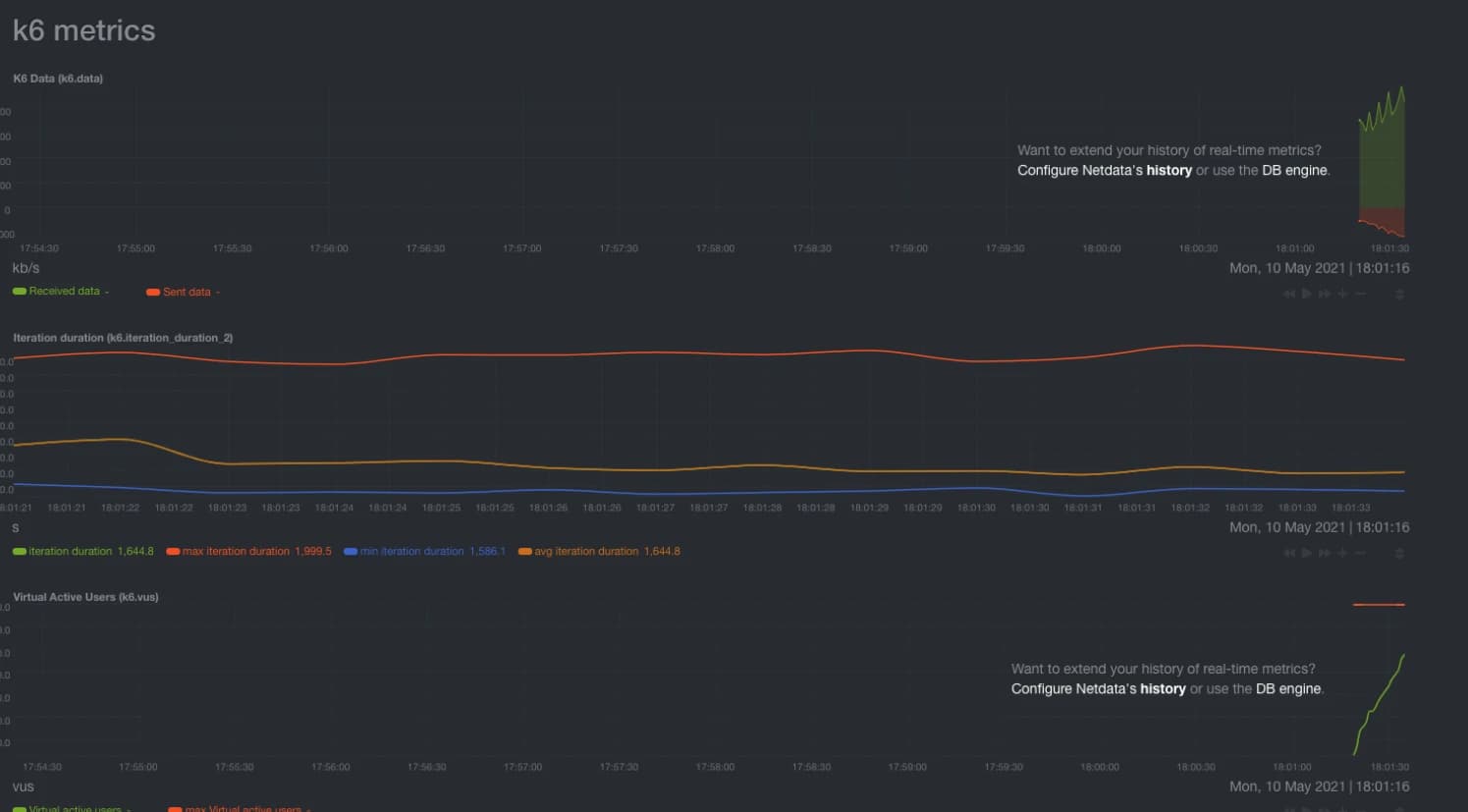

Netdata
A screenshot of Netdata metrics visualized in k6
For statsD–specific options, refer to StatsD in the k6 docs.
