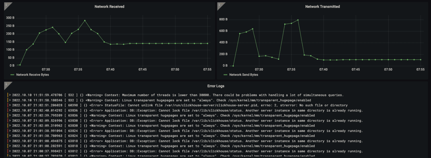

ClickHouse Overview dashboard
This dashboard gives a general overview of the ClickHouse instance or cluster based on all the metrics exposed by ClickHouse.
%3Aquality(100)%2F&w=3840&q=75)
We monitor several metrics here, including:
ClickHouseMetrics_MemoryTrackingClickHouseProfileEvents_QueryClickHouseProfileEvents_SelectQueryClickHouseMetrics_MySQLConnection
The Overview dashboard also contains a log panel so you can correlate logs and metrics for troubleshooting. In order to see signals correlated on the same dashboard, job and instance labels must match for metrics scrape config and the logs scrape config in the Agent configuration file.
To get more information on how to set this up, refer to the corresponding documentation.

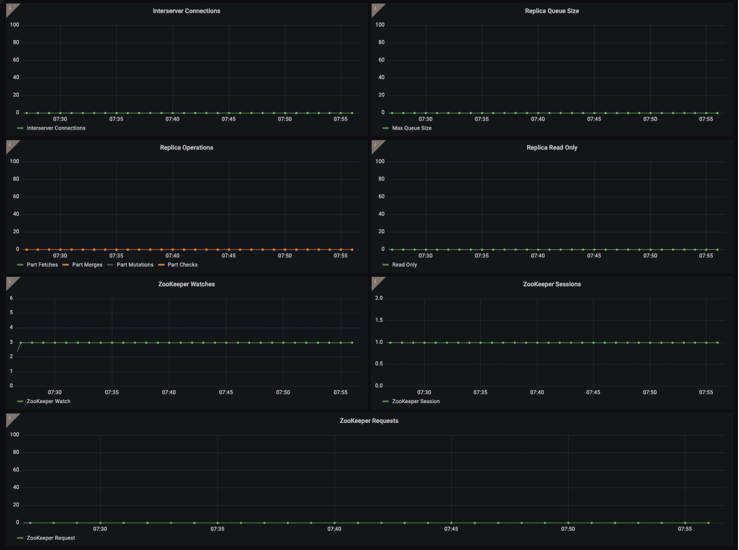

ClickHouse Replica dashboard
Monitoring replicas in ClickHouse is crucial to ensure data consistency, accuracy, availability, and performance of the system. Replicas provide redundancy, fault tolerance, and enable distributed query processing. Early detection of issues allows for corrective action to be taken before they impact the system’s operation, ensuring optimal system performance and query accuracy.
