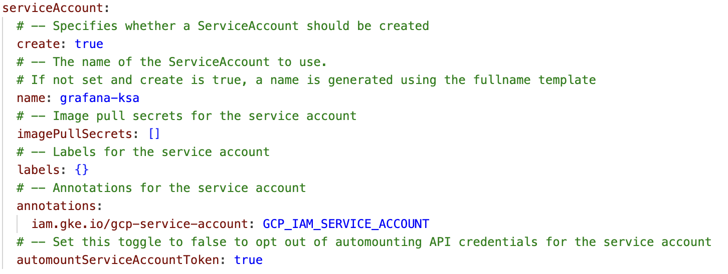

If you are using a Helm chart, just edit this code to values.yaml.
A screenshot of code for IAM policies.

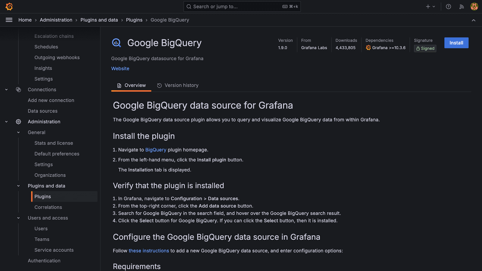

A screenshot of the the installation page for the BigQuery data source in Grafana.
Verify that the plugin is installed
  1. In Grafana, navigate to Configuration > Data sources.
  2. From the top-right corner, click the Add data source button.
  3. Search for Google BigQuery in the search field, and hover over the Google BigQuery search result.
  4. Click the Select button for Google BigQuery. If you can click the Select button, then it is installed.

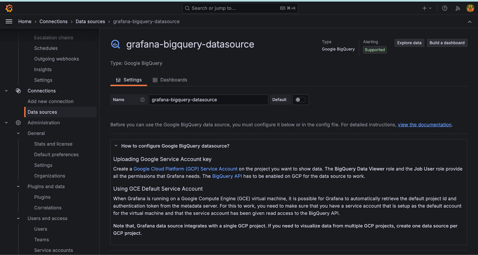

A screenshot of the Settings tab for the BigQuery data source in Grafana.

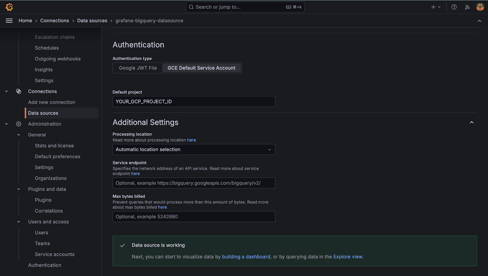

Authentication
By automatically retrieving credentials using Workload Identity Federation (when running Grafana on GKE), make sure that the service account has been given read access to the BigQuery API.
A screenshot of the Authentication page for the BigQuery data source plugin.

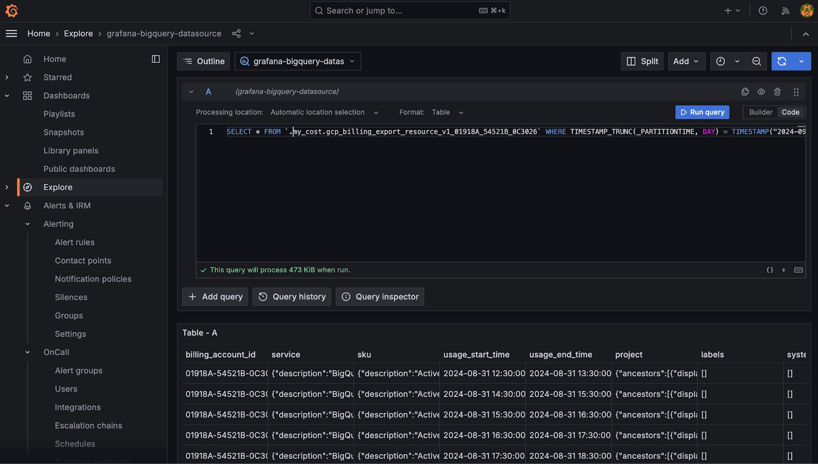

Query the data source
The query editor allows you to query the Google BigQuery data source. Queries can contain macros, which simplify syntax and allow your queries to be more dynamic. The SQL query editor comes with a rich support for standard SQL, as well as autocompletion for:
  • BigQuery standard SQL language syntax
  • BigQuery datasets, tables, and columns
  • Macros and template variables
A screenshot of a query for the BigQuery data source.
