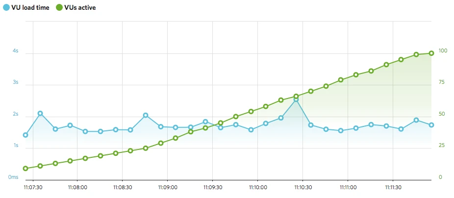

Flat VU load time and increasing VUs. This signals that the system under test (SUT) is stable with increasing concurrent users. Overall, a signal that performance is good, but we don’t stop here!

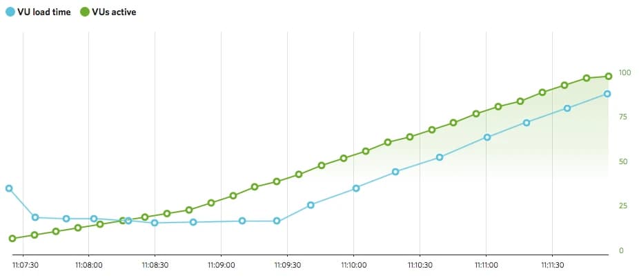

Increasing VU load time and increasing VUs. This signals that the SUT is degrading with increasing concurrent users. Overall, this is a strong signal that a performance problem exists.

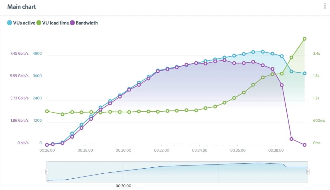

If the load generators are stable (and they usually are), let’s look to make correlations with the metrics available. Bandwidth can be a good indicator, as VUs increase do you maybe see bandwidth plateau? That could be a sign of a network bottleneck! If you’ve already installed either our open source Server Monitoring Agents or have integrated our platform with New Relic, you can pull these data points right into your test result data set. Does CPU utilization of the SUT reach high usage with your increasing load times? Maybe that’s a performance bottleneck you are running into.
Here we can see the quick rise in VU load time right at about the same time that bandwidth flattens out. This suggests a possible network-level issue is causing the degrading performance.
