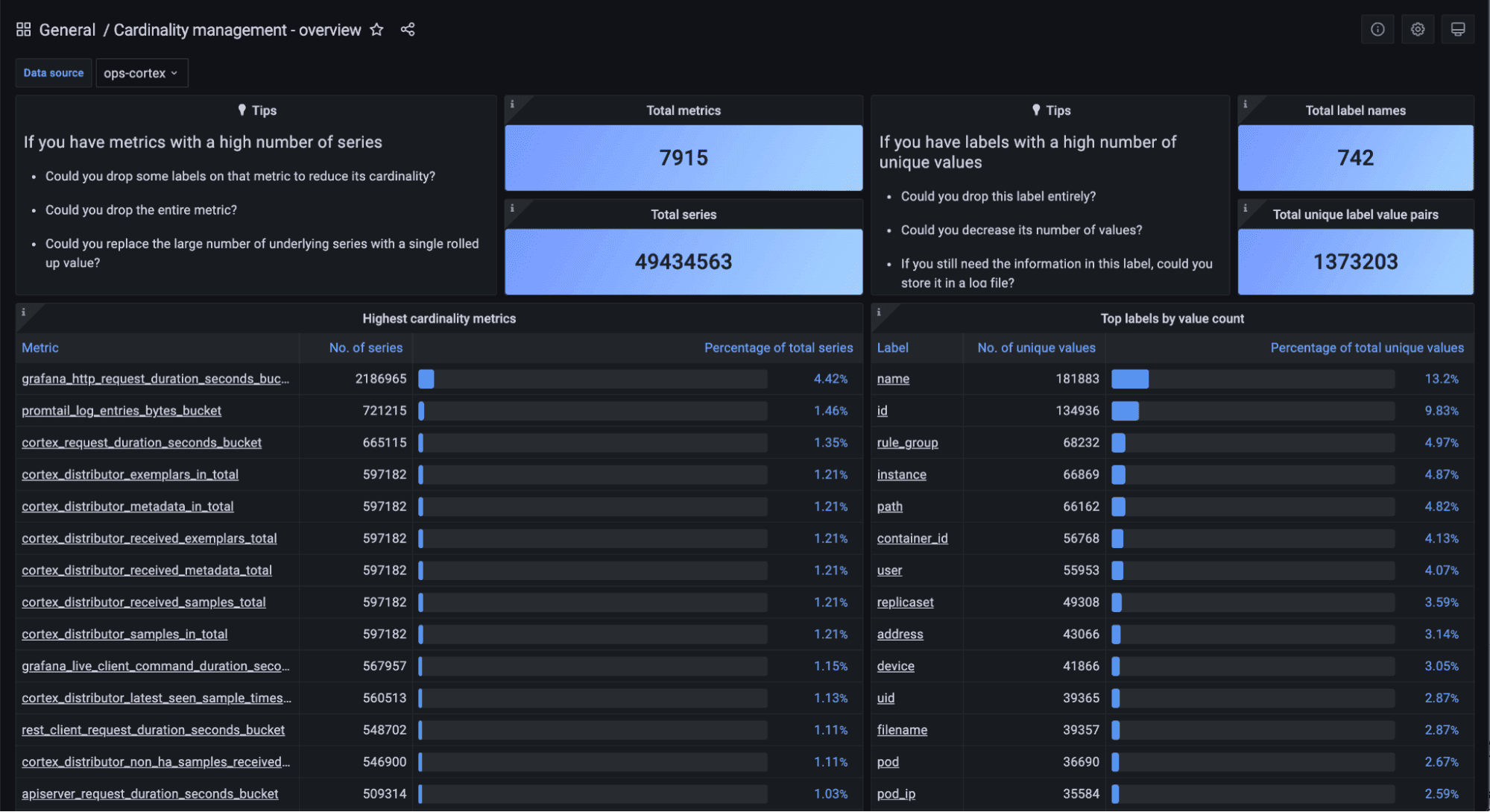

Overview dashboard
The overview dashboard shows you cardinality information across metrics and labels for a single selected data source. You would use this dashboard to inform yourself if a certain data source has a high number of series and to get a good idea on where to start looking for the origin of high cardinality. This cardinality dashboard allows you to click on the metric names as well as on the label names, which link you directly to the metric-specific and label-specific dashboards, respectively.
Embedded image
Start thinking about your top 10 metrics and your top 10 labels and ask yourself if you could drop some labels because they provide you with information you are not actively using (i.e., you’re not grouping or filtering by these labels and don’t plan on doing so in the future). Next, ask yourself the same question for the entire metric. Does the metric spark joy or is it gathering dust in your closet?

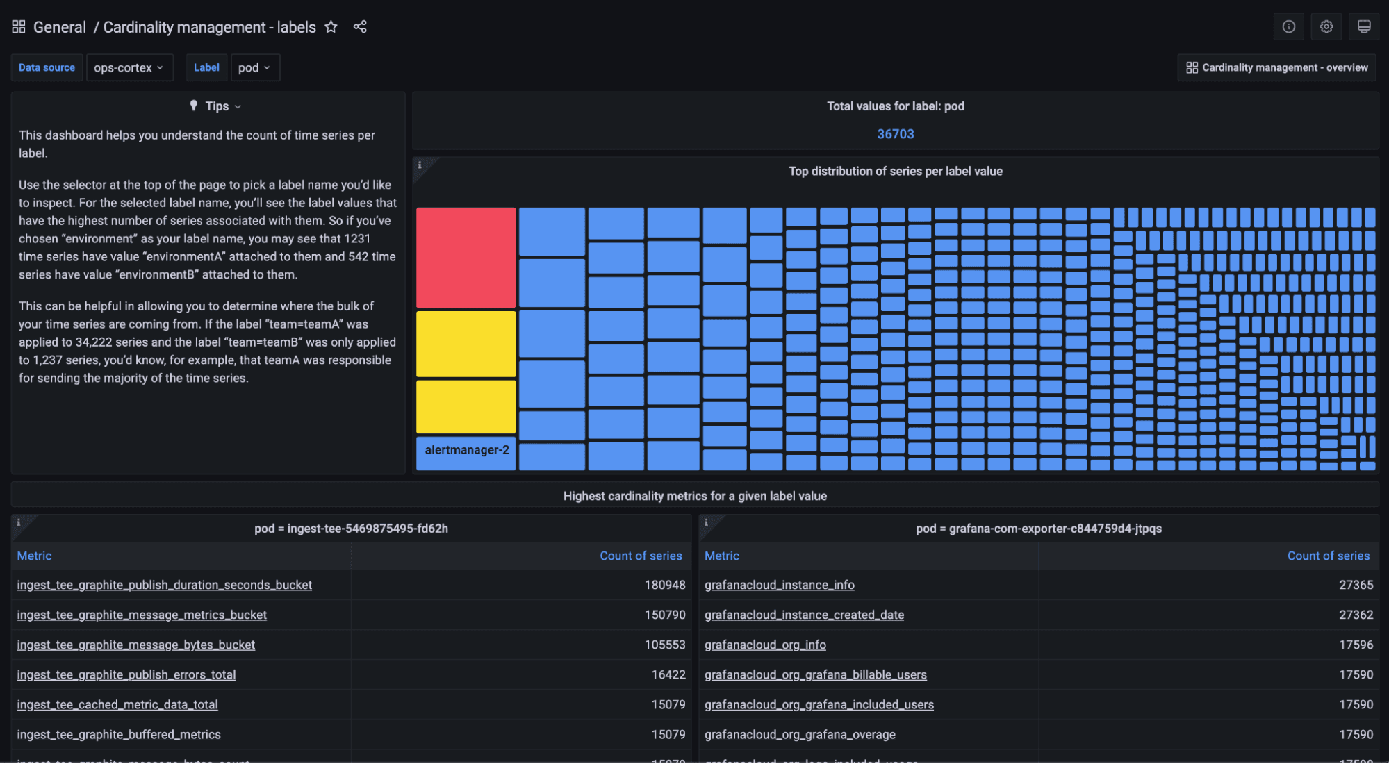

Labels dashboard
This dashboard shows a cardinality report for the selected label. For a given data source and label name, it shows you which label values are attached to the most series. It also shows you the highest cardinality metrics for a given label-value pair.
The labels dashboard is especially useful to show you the most common or the most important label values. It can also help you identify any imbalances of a label value across all the metrics it is being used. You might have decided to keep a certain label without reducing the number of values because it is important to you for specific use cases. However, in the labels dashboard you might identify metrics that use this label which do not provide value to you. Think about removing the entire metric or the label for this specific metric to eventually reduce cardinality.
Embedded image
Another use for this dashboard is helping to understand at a high level where your series are coming from. Let’s say that you use the common label environment across all your metrics to denote whether they’re coming from production, test, or development environments. If you use the labels dashboard to explore the environment label, you’ll be able to see what fraction of series are being generated by your prod, test, and dev environments. Maybe you notice that 50% of your series are coming from dev, which is unexpected for you. So you may focus on trimming metrics coming from dev.
Other organizations may use labels like application, team, or job to identify the source of a metric. Again, using this dashboard to look at these labels can be helpful to understand your distribution of series. Maybe you realize that application-1 is sending 90% of your series. Or that team-a is sending 5x more series than team-b even though they’re half the size.

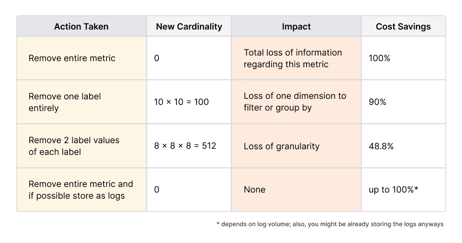

Let’s do a final example combining everything we have learned so far. Assume we have a metric with 3 labels. In real-life scenarios, it’s often the case that a specific label value only allows specific values of another label. For the sake of keeping this example simple, let’s assume that each label has 10 values, and each combination of these 3 times 10 label values can occur. This leaves us with potentially 10 x 10 x 10 = 1,000 series. Using the cardinality dashboards methodically as described in this article, we could do a couple of things. The table below shows some examples of actions taken, their impact on cardinality, their business impact, and the cost savings of this metric associated with the actions taken.
Embedded image
While this is a rather generic example, you can still see that small changes can make a fairly big impact.
