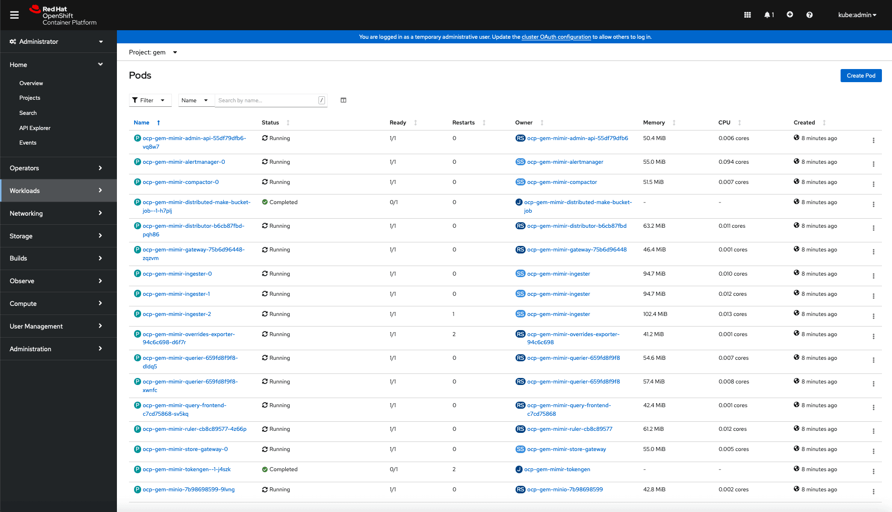

After a couple of minutes you should see the following by running: oc get pods -n ${PROJECT_NAME}
The running GEM pods and completed token job pod in Red Hat OpenShift.
Below is the OpenShift UI representation of the running pods and completed token job.
Screenshot of running GEM pods and completed token job pod in the Red Hat OpenShift UI.
