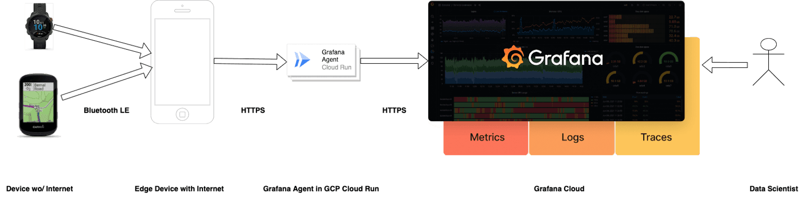

Since we wanted to be able to do analytics on the data the devices are collecting, we decided to consolidate the data in the cloud. We also needed a scalable — i.e. stateless — infrastructure listening for potentially massive amounts of data from the edge devices. Then, we needed a scalable layer that would persist the data and allow us to query it.
The first thing we did was build a device application using Garmin’s CONNECT IQ software development kit that was running on our smartphones. It reads information from our device’s sensors and sends it to our Grafana Agent, which will persist it in Grafana Cloud.
Normally, the Grafana Agent scrapes metrics, listens for traces, and reads log files, but what makes it extra handy is that we were able to configure it to also listen for incoming JSON payloads. With that done, we had a stateless listener.
Put the agent into a container and throw it at Google Cloud Run, and we had a stateless and scalable layer. Finally, we configured the Grafana Agent to send the data to Grafana Cloud Logs.

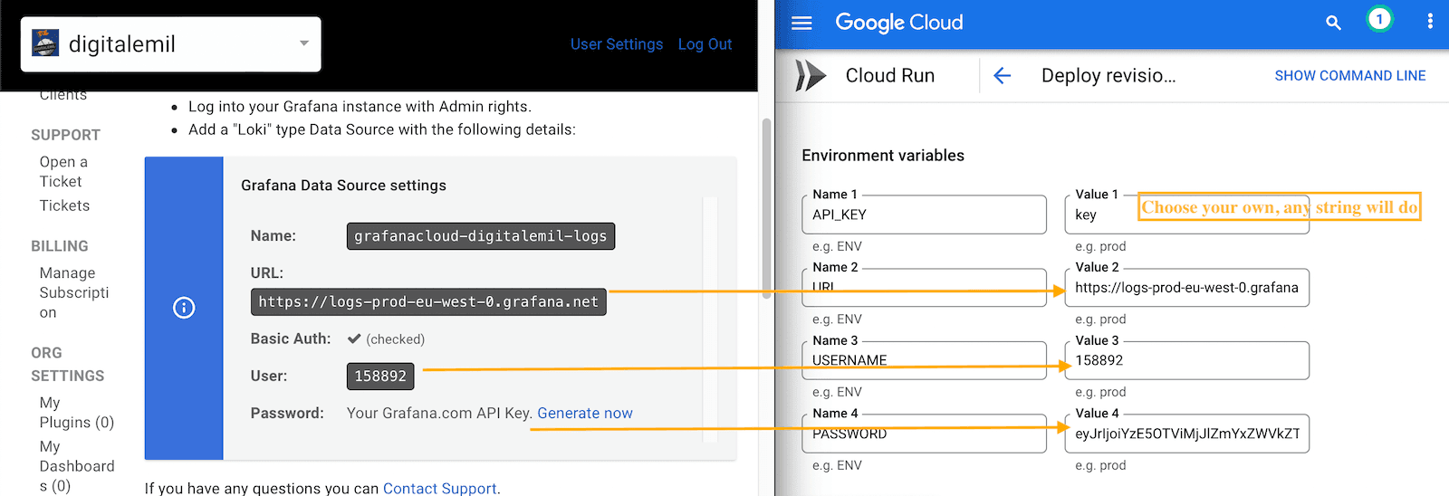

Next, set the environment variables of your Cloud Run service. For this, you need the details from your Grafana Cloud Log service. Also create an API_KEY, which we will refer to as PASSWORD.
Embedded image

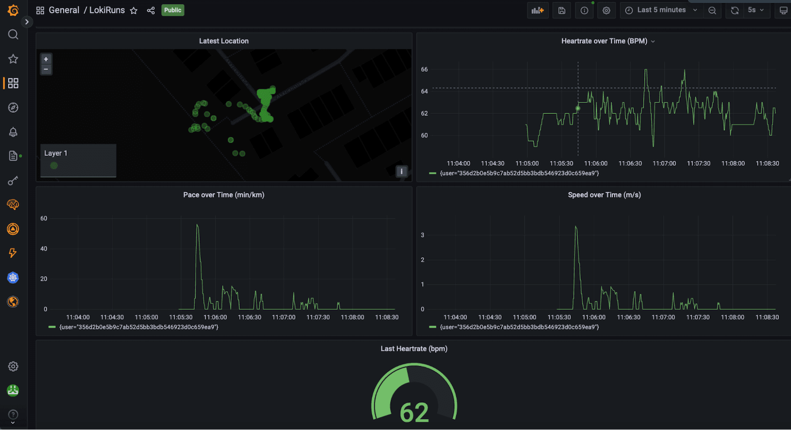

Creating a Grafana dashboard
The only thing left is setting up a nice dashboard where you can monitor your running metrics! Assuming you’re Grafana experts, we’re keeping things simple here and just putting a couple of panels together with metrics obtained from the logs.
Here is one we use for plotting the heart rate by user over time:
avg_over_time ({app="lokiruns"} | logfmt | line_format{{.message}}| json  | unwrap heartrate [2s]) by (user)
Basically, what you need to do is:
  1. Select the right stream: {app="lokiruns"}
  2. Get rid of the non-json parts (e.g. timestamp="2022-07-30 10:36:39 +0000 UTC" kind=log message=")by: | logfmt | line_format{{.message}}
  3. Parse the json message with the sensor data: | json
  4. Unwrap the value (so you can use it in an aggregate function: | unwrap heartrate
  5. Average the values over time by user: avg_over_time (... [2s]) by (user)
You’ll get something like the dashboard below. Here, we’re monitoring the last location, heart rate over time, pace over time, speed over time, and the last heart rate.
Embedded image
Seeing all of these metrics is helpful when analyzing your run and current fitness status. With Grafana 9.1 you can even make your dashboard public if you want to share your latest run with your trainer or friends and family.
