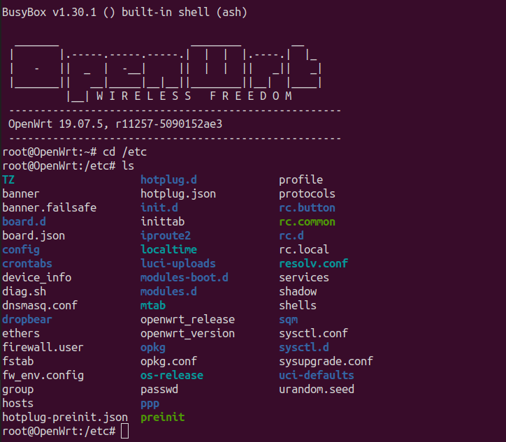

There are two ways to interact with OpenWrt to install packages. You can log in to the router directly using ssh or, if you have it installed, you can use a web UI called Luci. An ssh connection gives you a Busybox shell that includes a useful subset of standard UNIX utilities.

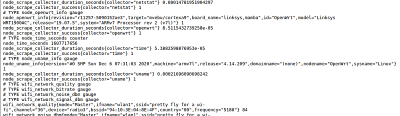

By default, the node exporter we installed will export data to localhost at port 9100 to /metrics. Let’s test whether the node exporter is exporting data as it should. You may need to install the curl utility before this command works. If it does, you will see several screens of structured metrics scroll past.
curl localhost:9100/metrics

My router’s IP address on my LAN is 192.168.1.1. Metrics are now available to anyone on my LAN at 192.168.1.1:9100/metrics. Here’s an excerpt of what that looks like in my browser:
Embedded image

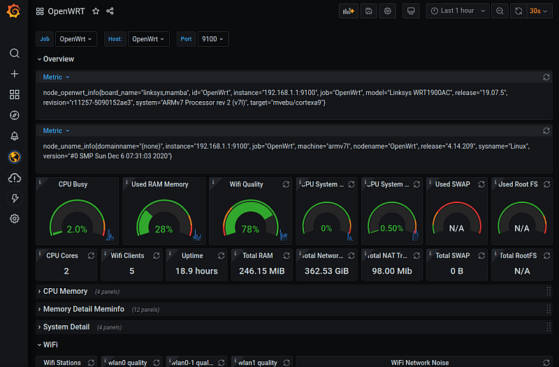

Viewing metrics in Grafana Cloud
After a few moments, metrics begin to be available in Grafana Cloud. I logged in and went to Dashboards->Manage. From there, I clicked Import and entered this URL for the contributed OpenWrt dashboard I mentioned earlier: https://grafana.com/grafana/dashboards/11147.
This is an excerpt of that dashboard in action.
Embedded image
