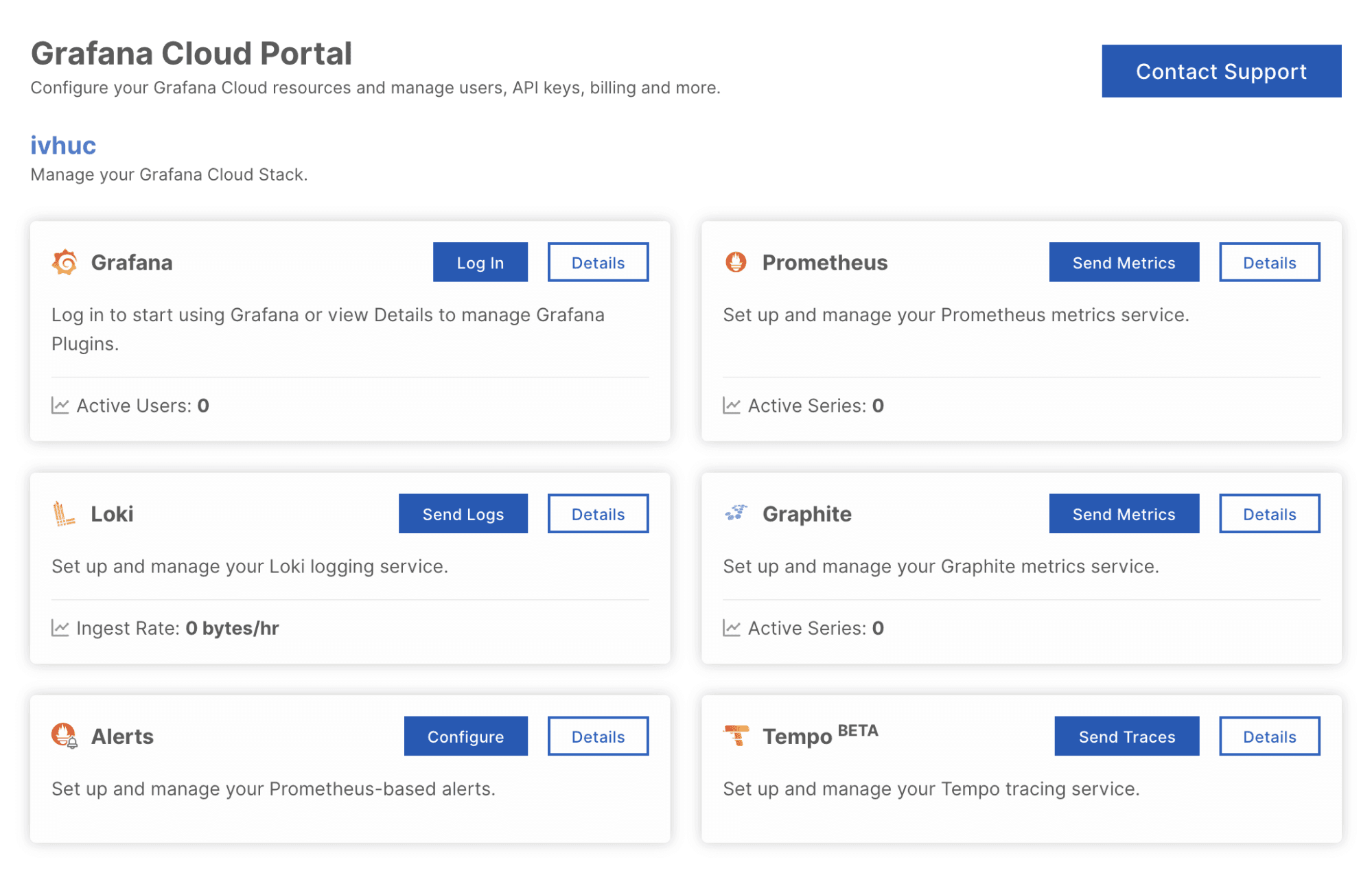

Setting up Grafana Cloud
The next step is to set up our databases and Grafana. I have decided to use Grafana Cloud — which comes with hosted Grafana, Grafana Loki, and Graphite — for our data storage and data visualization. The free tier comes with 10,000 series for Graphite metrics and 50GB for logs in Loki, which is definitely more than enough for this monitoring solution.
I went to the Grafana Cloud signup and created a new account. As soon as I had my account all set up, I could see my portal with my hosted Grafana, Loki, and Graphite instances.

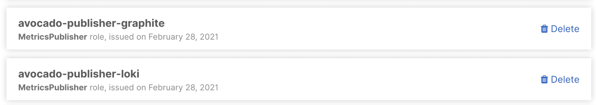

At this point, I’ve also created my API keys for Loki and Graphite to publish metrics from my monitoring system to these databases.

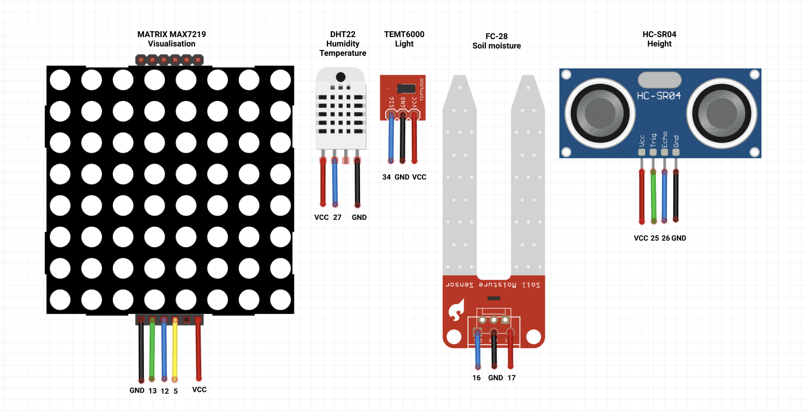

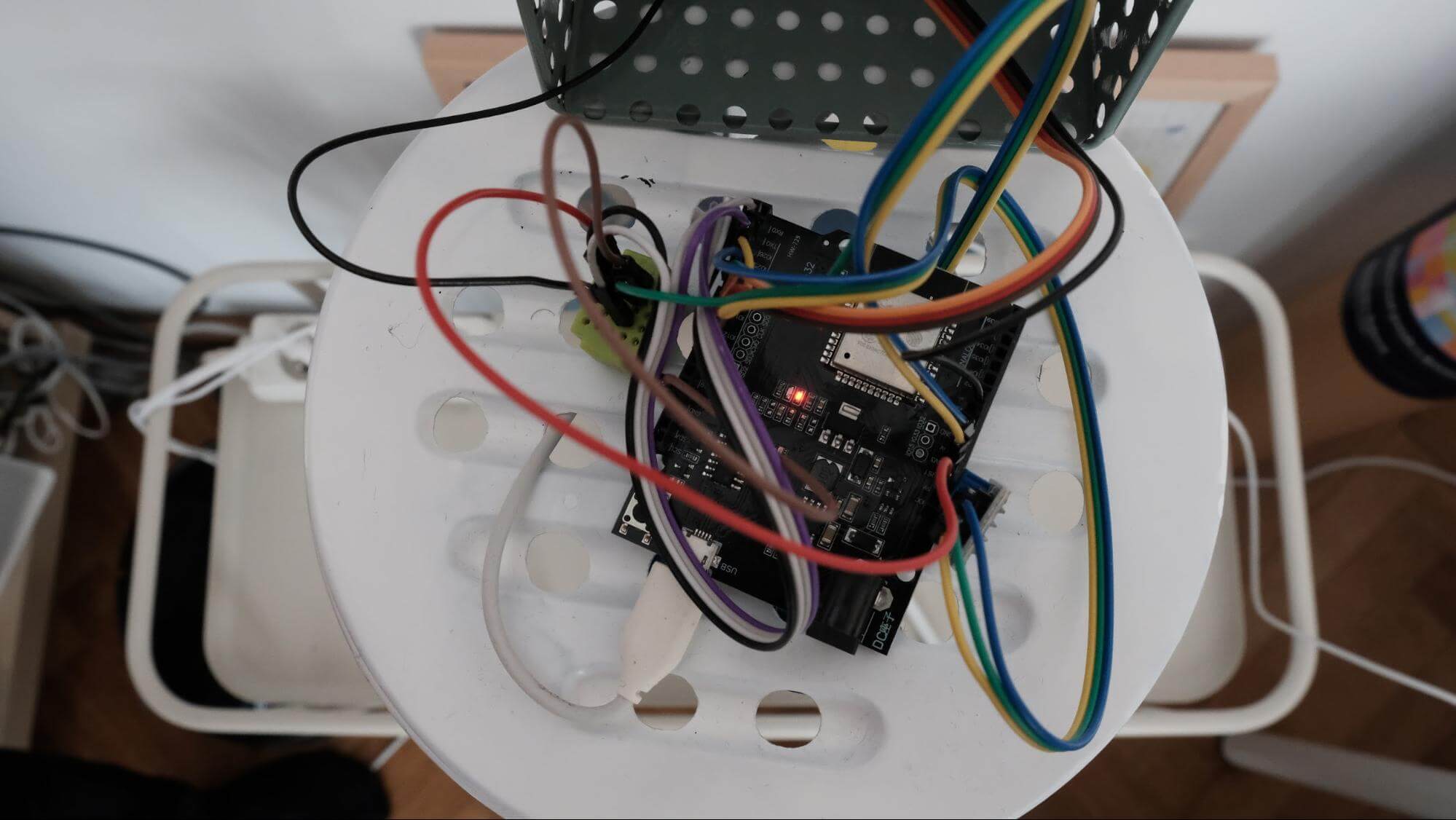

The hook-up
Now it’s time to start putting things together. Below, you can see the pinouts of all sensors and outputs:
Embedded image

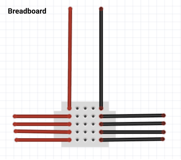

As I had more inputs and outputs than power and ground pins, I also used the 25 points breadboard. I wired it to the vcc pin and gnd pin, so I created 3 extra gnd and vcc pins that I will use for my inputs and outputs.
Embedded image
LED display MATRIX MAX7219
The 8x8 LED matrix is often used to display simple graphics or texts. I decided to use it to display the state of my plant. If the plant has perfect conditions, I see a smiley face on the LED matrix. On the other hand, if the soil is dry or the temperature is too low or too high, a sad emoticon is displayed.
Pinout:
  • VCC pin to 5V on the breadboard
  • DIN data input pin to pin 5 on board
  • CS chip select pin to pin 13 on the board
  • CLK serial input pin to pin 12 on the board
  • GND pin to GND on the breadboard
The DHT22 sensor module
This is a very basic and cheap sensor made of two parts:  a humidity sensor and a thermistor. In this case, it is used to measure the temperature and humidity of the environment in which my avocado plant lives.
Pinout:
  • VCC pin to 3.3V on the board
  • DATA pin to pin 27 on the board
The TEMT6000 light sensor
This light sensor will detect the brightness of my avocado plant’s surroundings. TEMT6000 measures illuminance that is measured in lux. TEMT6000 is very intuitive to use: More current means brighter and less current means darker.
Pinout:
  • VCC pin to 5V on the board
  • SIG output voltage pin to pin 34 on the board
  • GND pin to GND on the board
The soil moisture sensor
The soil moisture sensor is one of the most important sensors in this project. It is going to let me know if the soil of my plant is wet or dry, and it is going to help me figure out when to water it.
Pinout:
  • VCC pin to pin 17 (I am not using the vcc pin to prevent corrosion)
  • SIG output voltage pin to pin 16 on the board
The HC-SR04 ultrasonic distance sensor
The ultrasonic sensor uses sonar to determine distance to an object. It has high accuracy and stable readings in a range from 2 cm to 400 cm. I am using this sensor to measure the height of my plant.
Pinout:
  • TRIG pin that sends the signal to pin 25 on the board
  • Echo pin that receives signal to pin 26 on the board

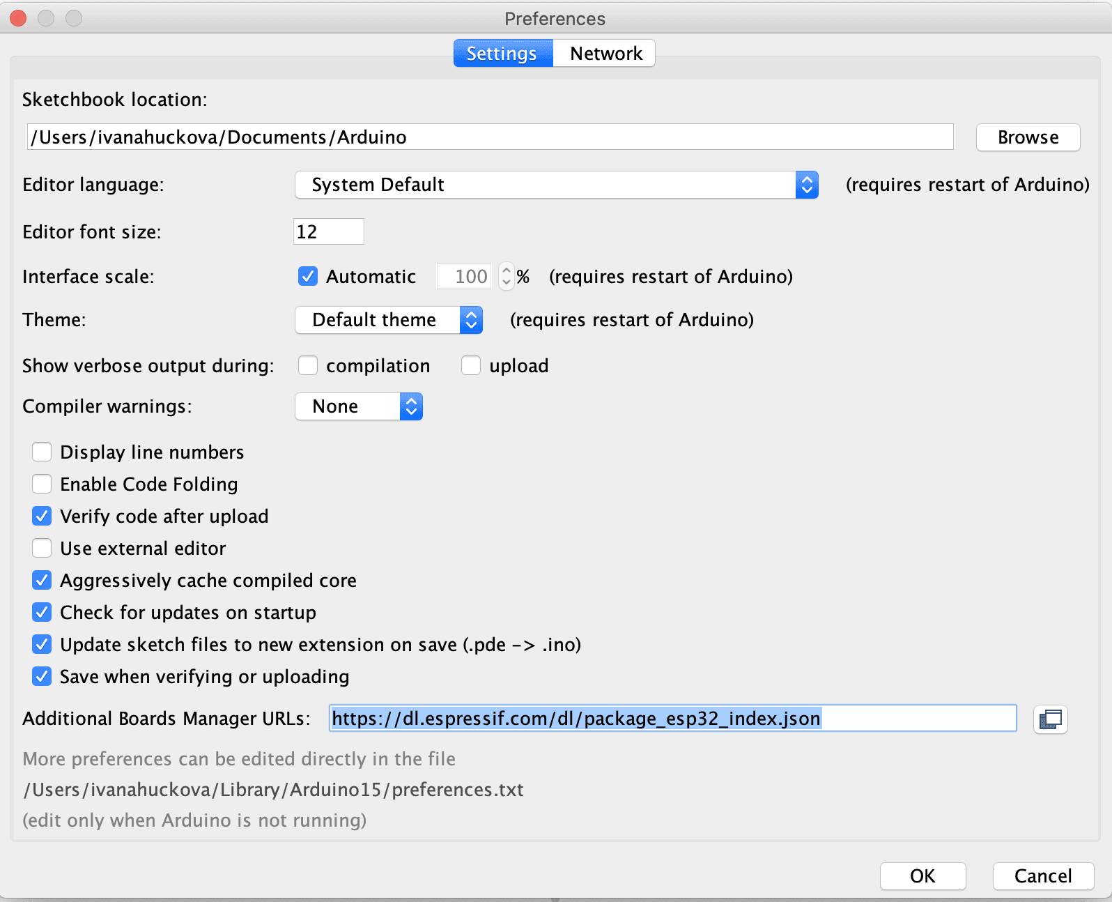

After my ESP32 board is connected to my computer, I continue with opening my Arduino IDE. As I am using an ESP32 board (and not an Arduino board), I need to add a board definition that adds support for my EP32 board. In Arduino > Preferences, I have added the url https://dl.espressif.com/dl/package_esp32_index.json to the Additional Boards Manager URLs input. This open source board definition adds support for programming ESP32 boards.

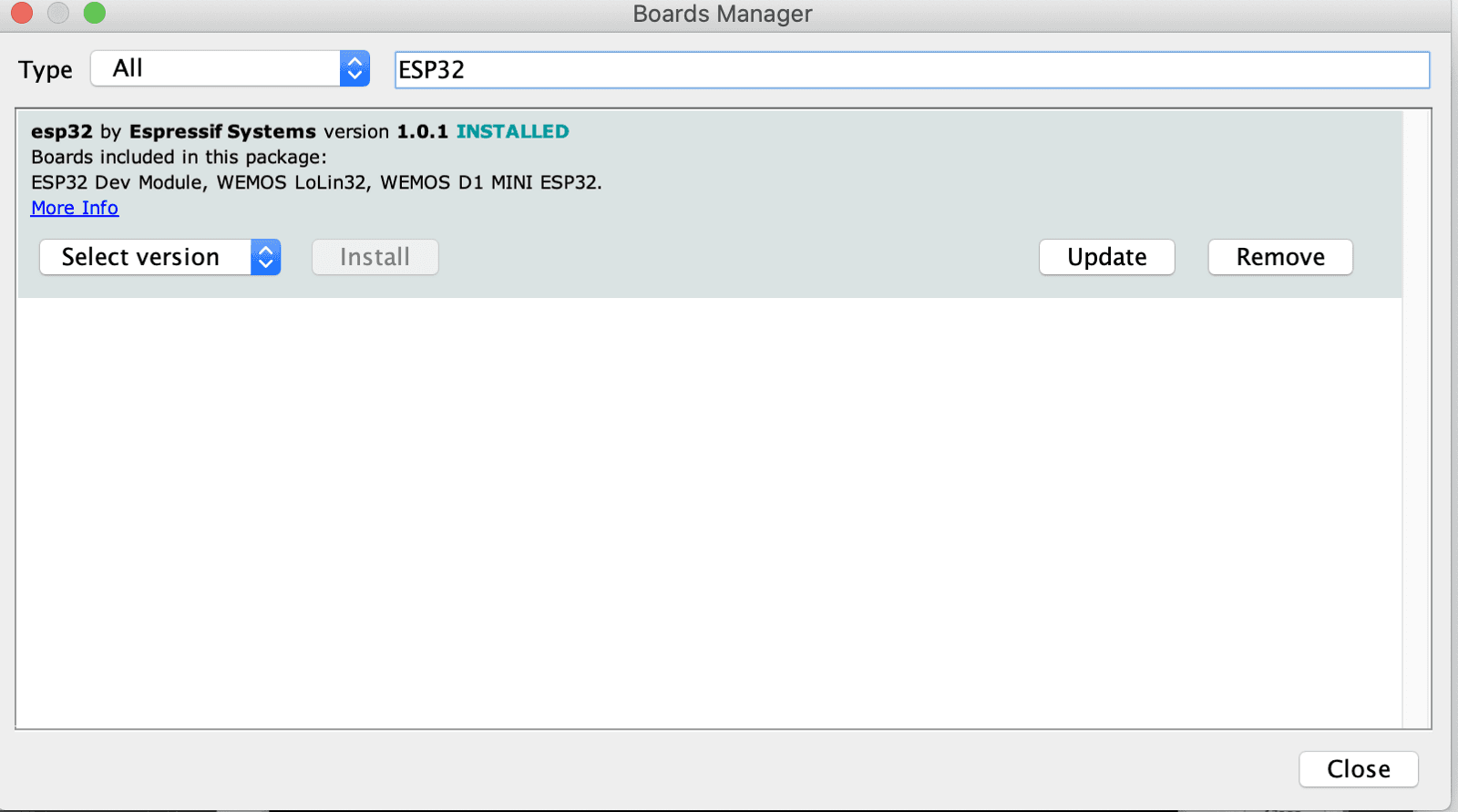

Then, in Tools > Boards > Boards Manager I have added ESP32 board manager.
Embedded image
Lastly, in Tools > Boards, I have chosen DOIT ESP32 DevKit. This tells the Arduino IDE which profile and base libraries to use when compiling the firmware image, and how to flash it to the board. Make sure that in the Tools > Port submenu, you’ve selected the new COM port.

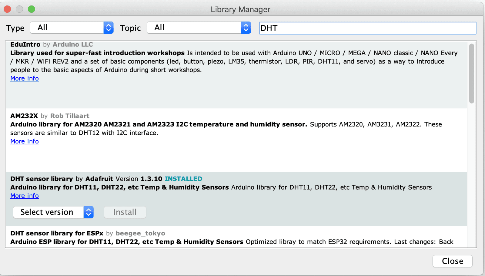

Step 2: Adding libraries
For this project, I used the following libraries:
I installed all of these libraries in Sketch > Include Library > Library Manager. It is important to have these libraries installed before moving to the next steps.

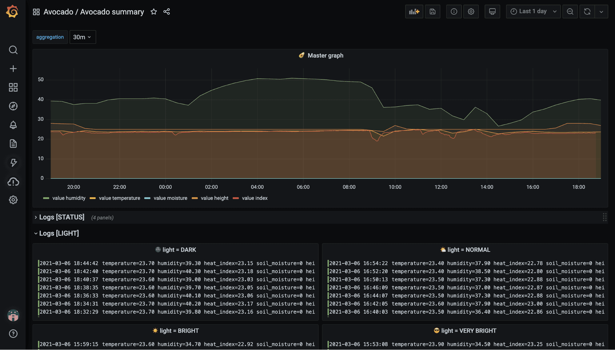

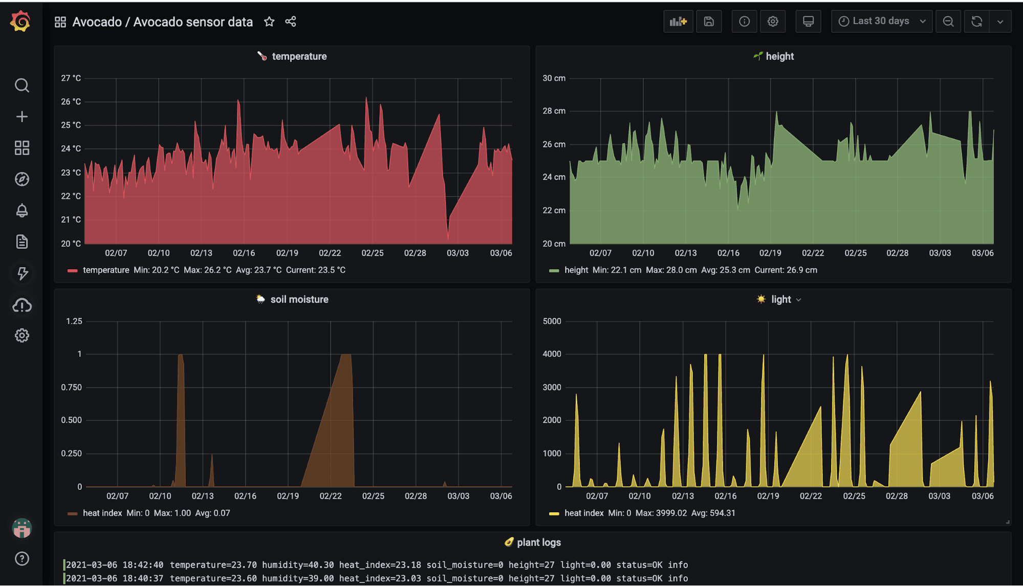

Visualize the data in Grafana
As soon as the data from monitoring is flowing to Graphite and Loki, it’s time to visualize them in Grafana. I opened the Grafana instance that was set up through my Grafana Cloud signup and started to create dashboards. I created  two dashboards, and if you would like to use the same ones, you can just go and copy-paste my dashboards’s JSON models in here and here.

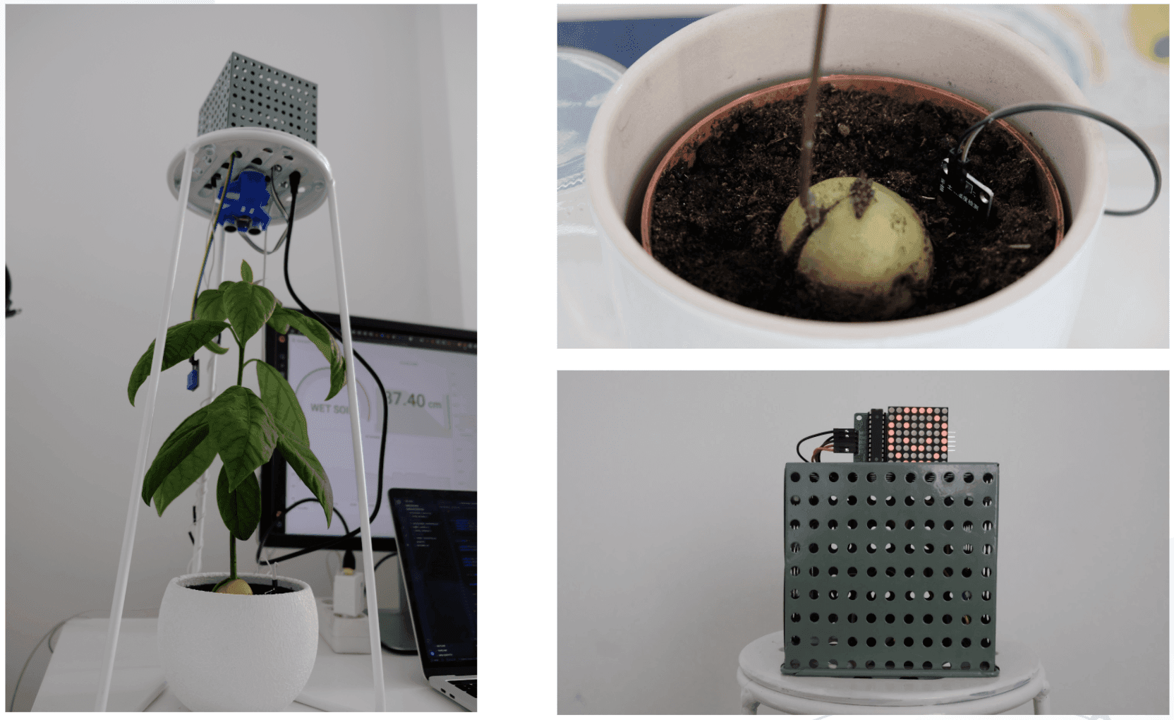

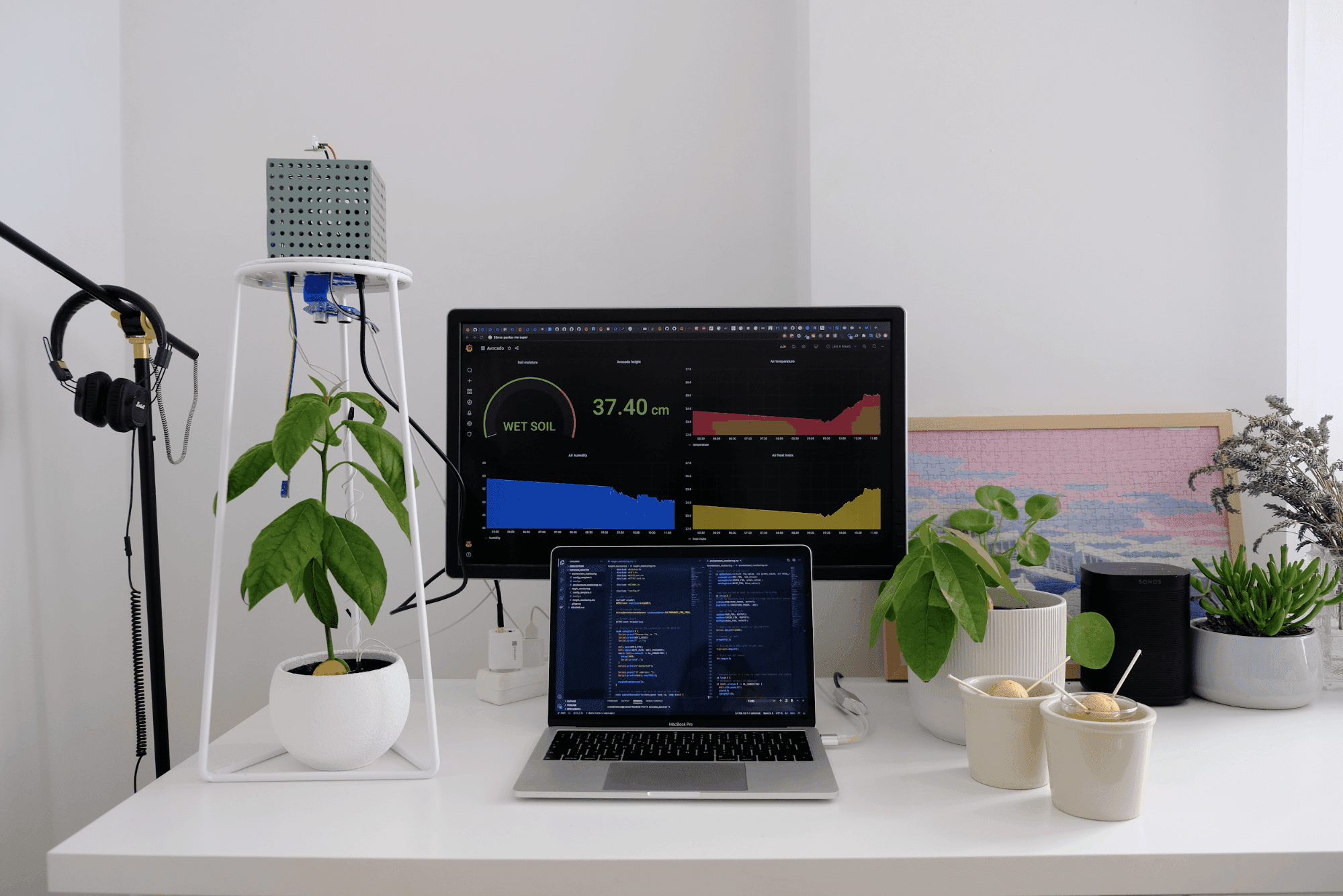

Add the monitoring system to the plant stand
Now comes the last, handy part of the work. 👷‍♀️ I mounted my monitoring system on the plant stand using a glue gun, but feel free to improvise and design your own solution.
Embedded image
