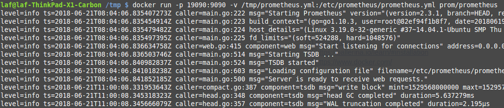

Now, execute the following command to run Prometheus in Docker:- $ docker run -p 19090:9090 -v /tmp/prometheus.yml:/etc/prometheus/prometheus.yml prom/prometheus
Figure 2Running Prometheus in Docker
Now, Prometheus will poll for metrics data from the Ballerina service and store in its time series data store.

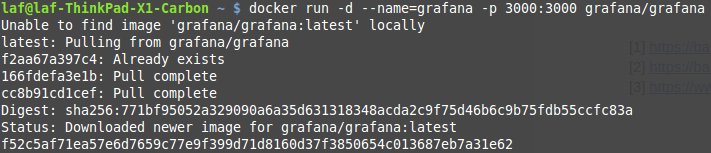

We will be installing and running Grafana using the following command:- $ docker run -d --name=grafana -p 3000:3000 grafana/grafana
Figure 3Install and run Grafana
Now, we can go to http://localhost:3000/ to access the Grafana dashboard. From here, you can log in to the system with the default username/password: admin:admin.

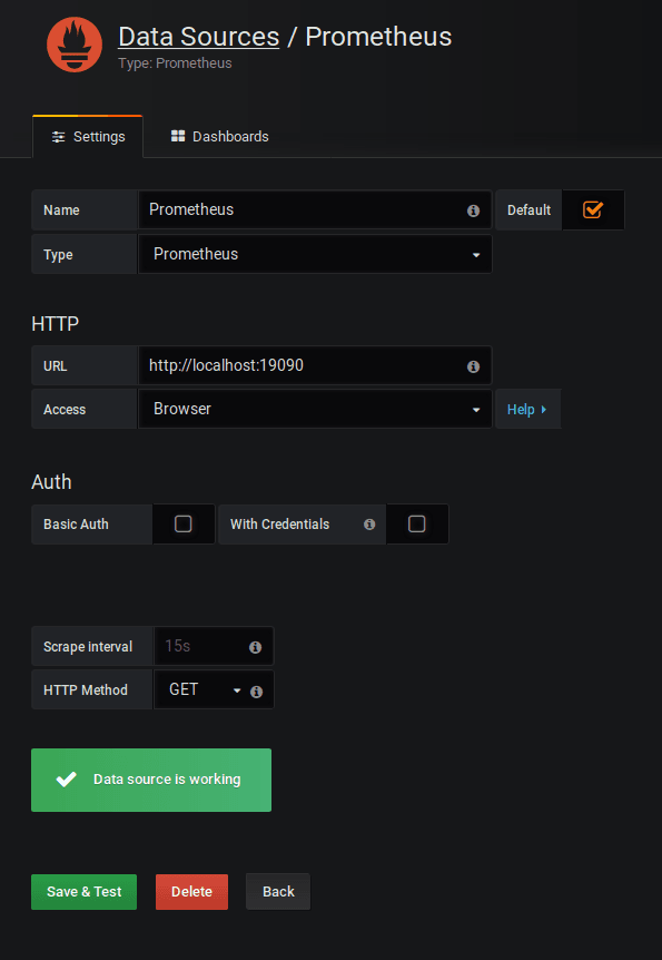

Next, we will add a new data source to Grafana, with the following settings:-
Figure 4Settings for your Prometheus data source

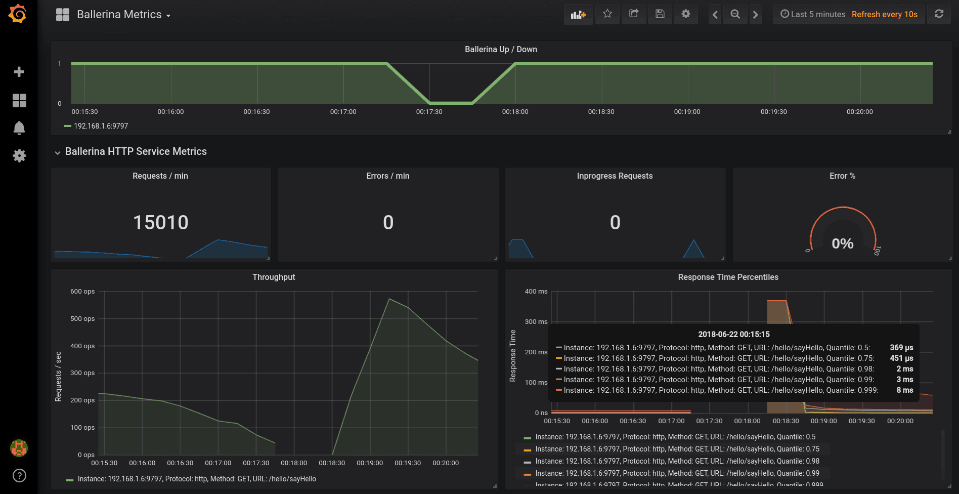

After the data source is saved, the already available Ballerina dashboard can be found at https://grafana.com/dashboards/5841. In order to add it to Grafana, Click [+] -> Import -> 5841 -> Load. After the dashboard is added, you will be able to immediately see the metrics being visualized by the Grafana dashboard.
#### Visualizations in the default dashboard
HTTP Service / Client Metrics
  • Service and client level statistics such as request/min, errors/min, error%, HTTP error codes distribution etc…

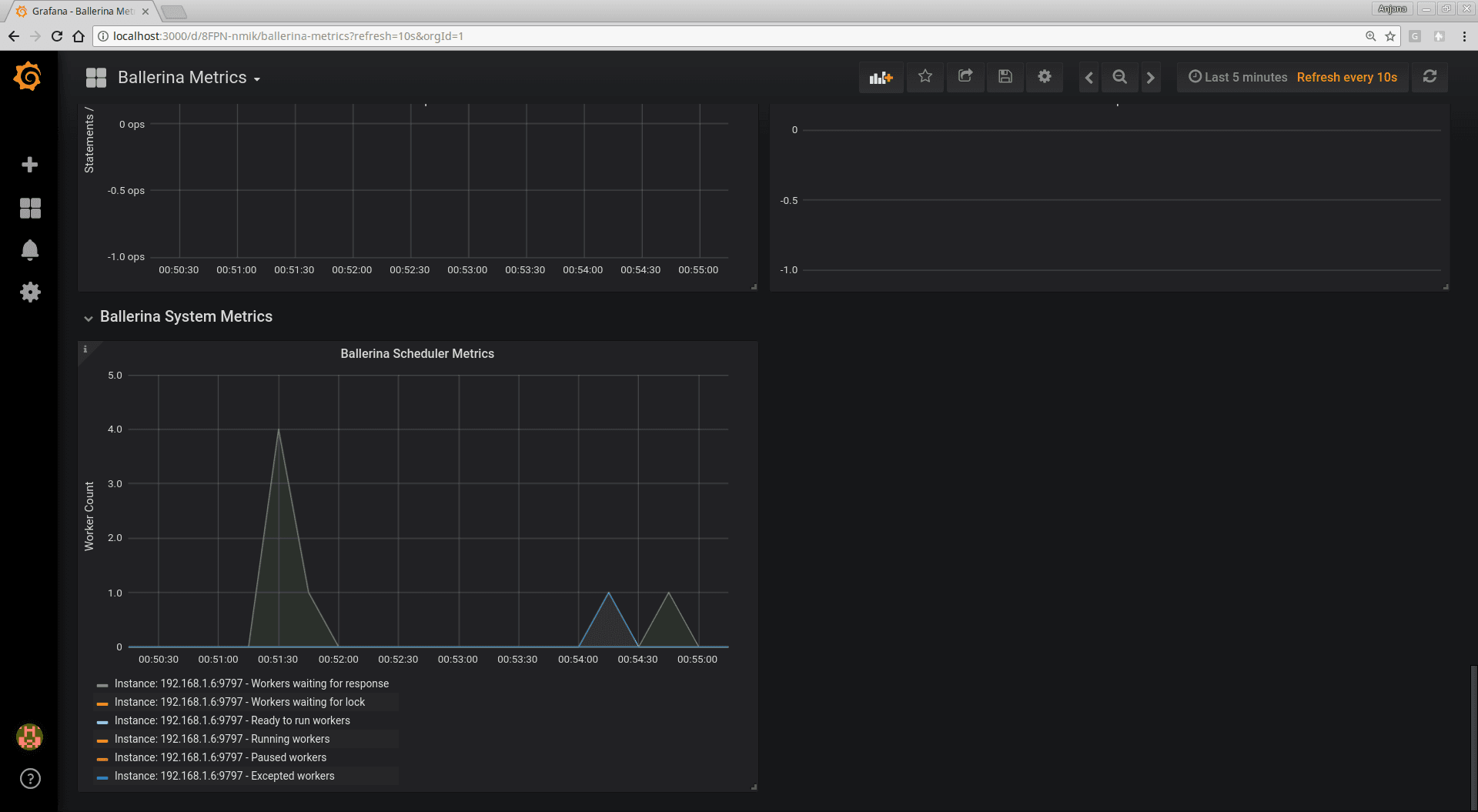

Ballerina System Metrics
  • Mainly contains the Ballerina scheduler based metrics, such as running worker count, waiting for response worker count etc…
  • In order to generate Ballerina scheduler metrics, the Ballerina environment variable “b7a.runtime.scheduler.statistics” should be set to “true”; $ ballerina run hello.bal --observe -e b7a.runtime.scheduler.statistics=true
Figure 5The metrics visualization of our hello-world service being invoked
Figure 6Ballerina scheduler statistics while the hello-world service is invoked repeatedly

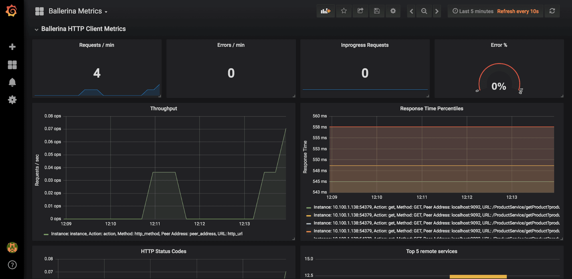

Figure 7Figure 8Preview of the Grafana dashboard panels, if we were to have any HTTP client operations and SQL operations to be executed, respectively
