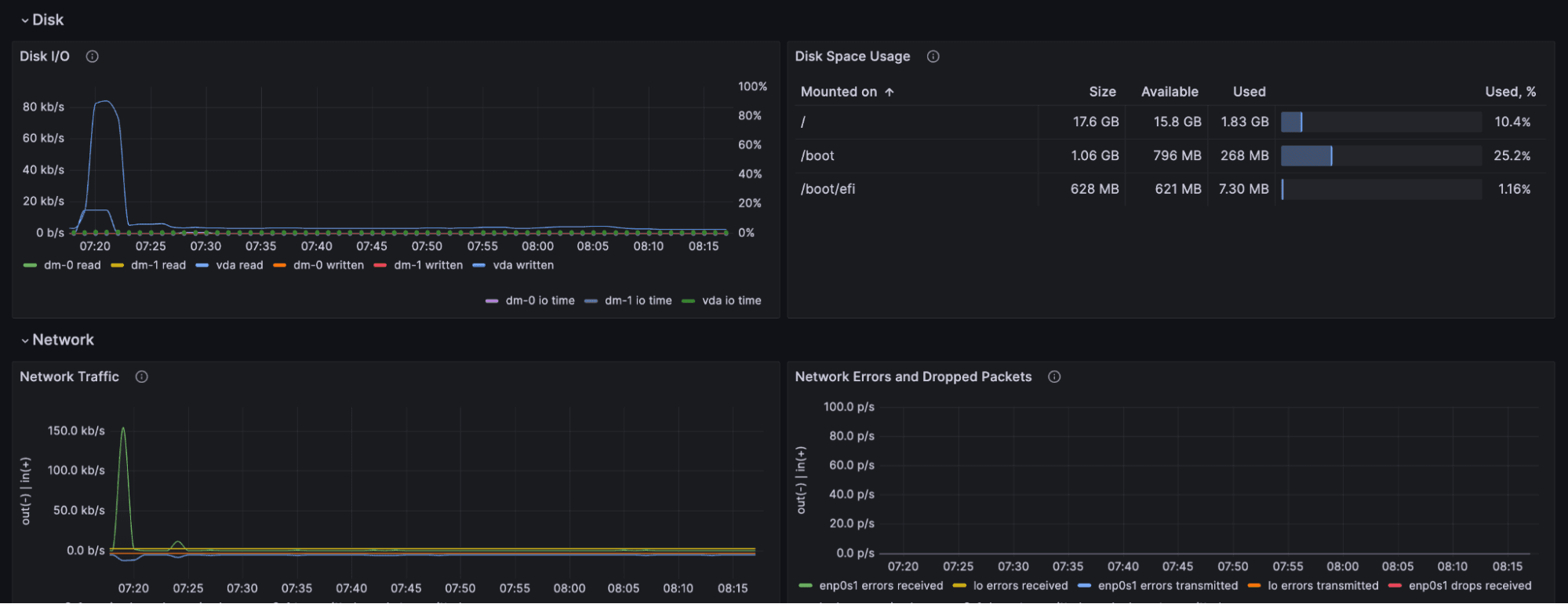

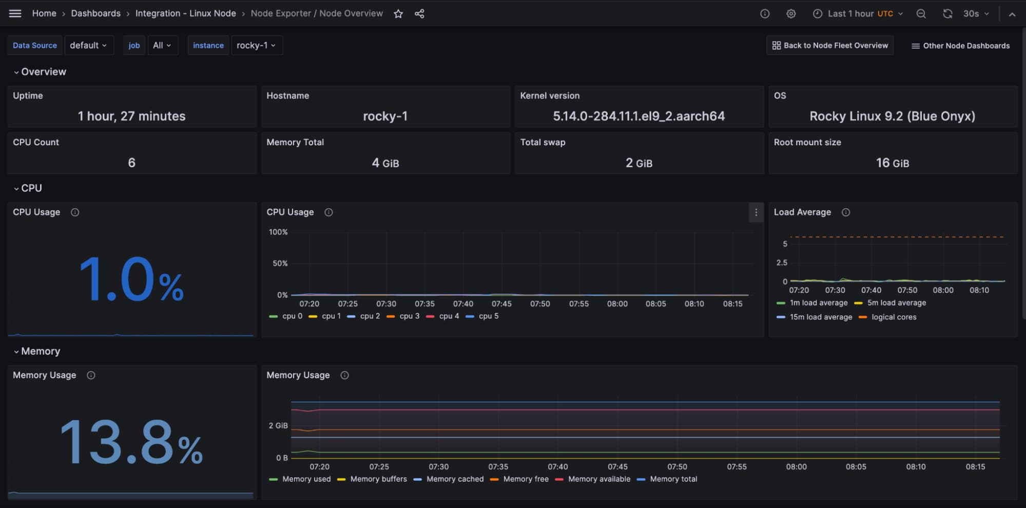

Node overview
This dashboard provides a comprehensive overview of a single server. It offers a high-level overview of the different resources, i.e., CPU, memory, disk, and network.
Linux overview dashboard, 1 of 2Linux overview dashboard, 2 of 2

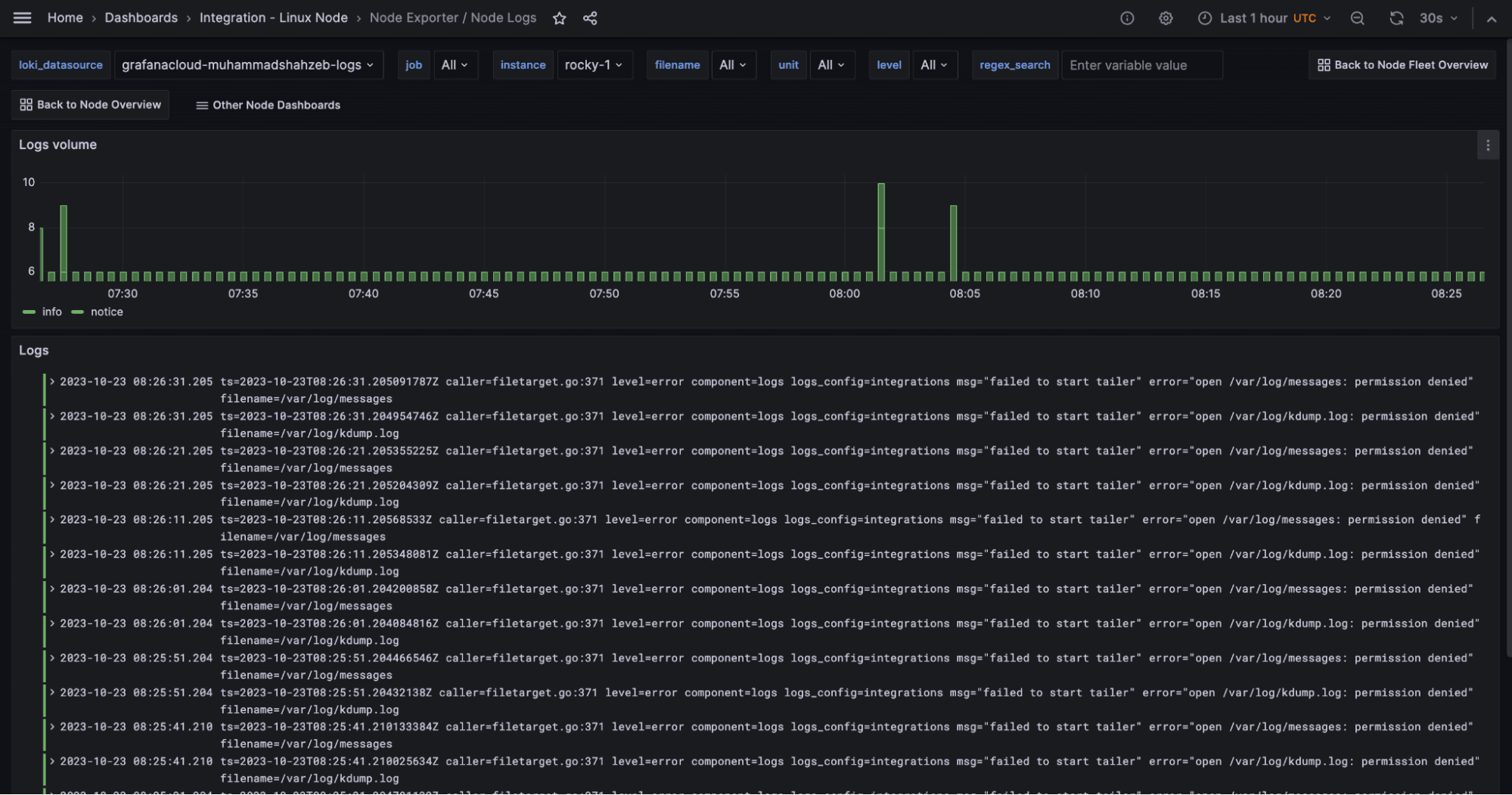

Node logs
The Rocky Linux integration also collects Linux logs with the help of Promtail embedded inside Grafana Agent. The logs dashboard can be used to monitor the logs and debug issues as well.
 Linux logs dashboard

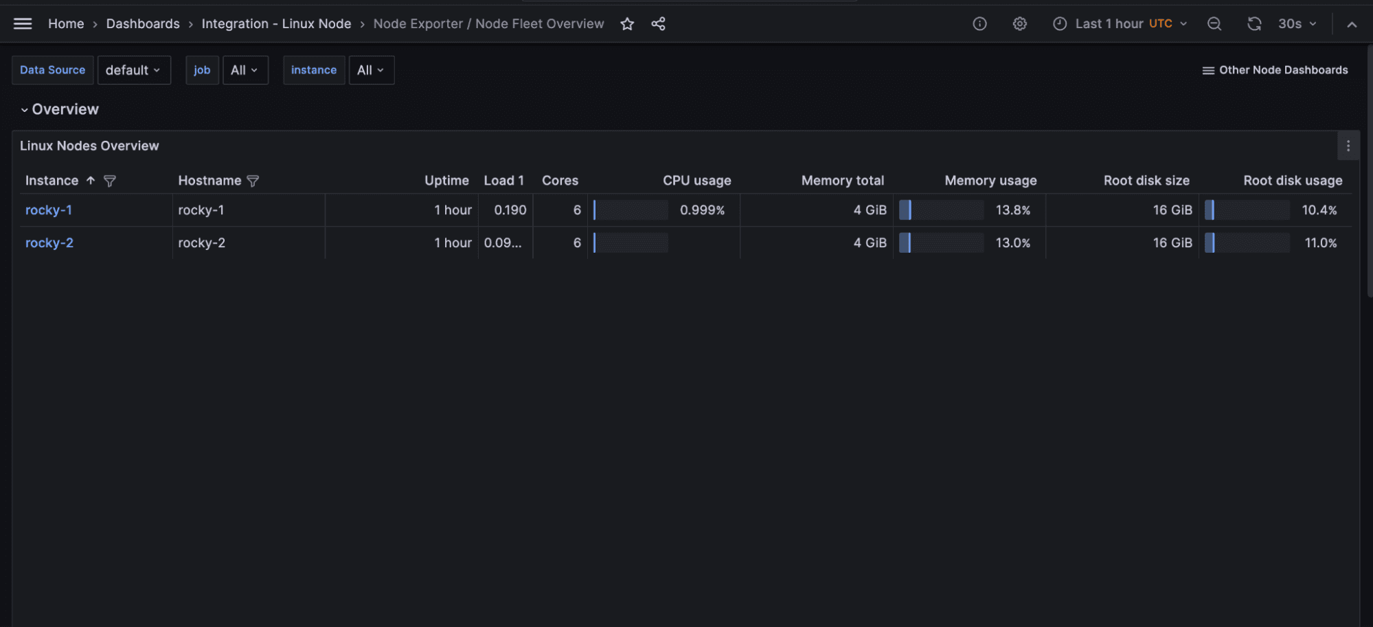

Node fleet overview dashboard
In an environment where you have multiple servers running, this dashboard is very useful for monitoring all the instances at a glance. You can also click on an instance to open the node overview dashboard for that specific server.
Linux fleet overview dashboard
