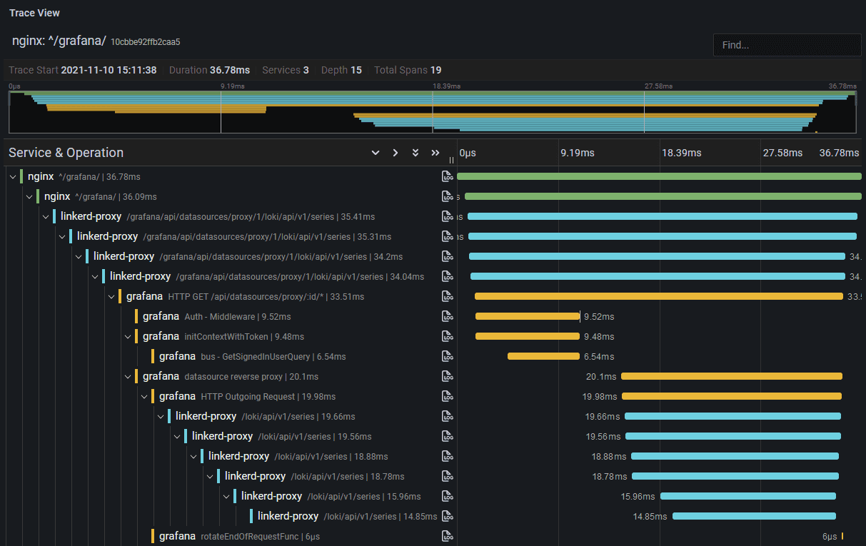

Now, click around in Grafana a few times to generate a few requests. You then have a few choices of how to find your traces:
  • If you have activated the experimental Tempo search feature in both Grafana Tempo and Grafana:
    1. Go to Explore
    2. Select the Tempo data source
    3. Click on Search - Beta
    4. You should see some traces here
  • If you ship your Grafana logs to Loki:
    1. Go to Explore
    3. Select Loki search
    4. Do a search for your Grafana logs, i.e.: {namespace="monitoring", job="monitoring/grafana"} or similar depending on your setup
    5. You should see some traces here
  • To grab the logs from Grafana, either directly from the pods or through your log system:
    1. Look for traceID
    2. Go to Grafana Explore
    3. Select the Tempo data source
    4. Select traceID
    5. Enter the traceID and run the query
    6. You should see a trace
