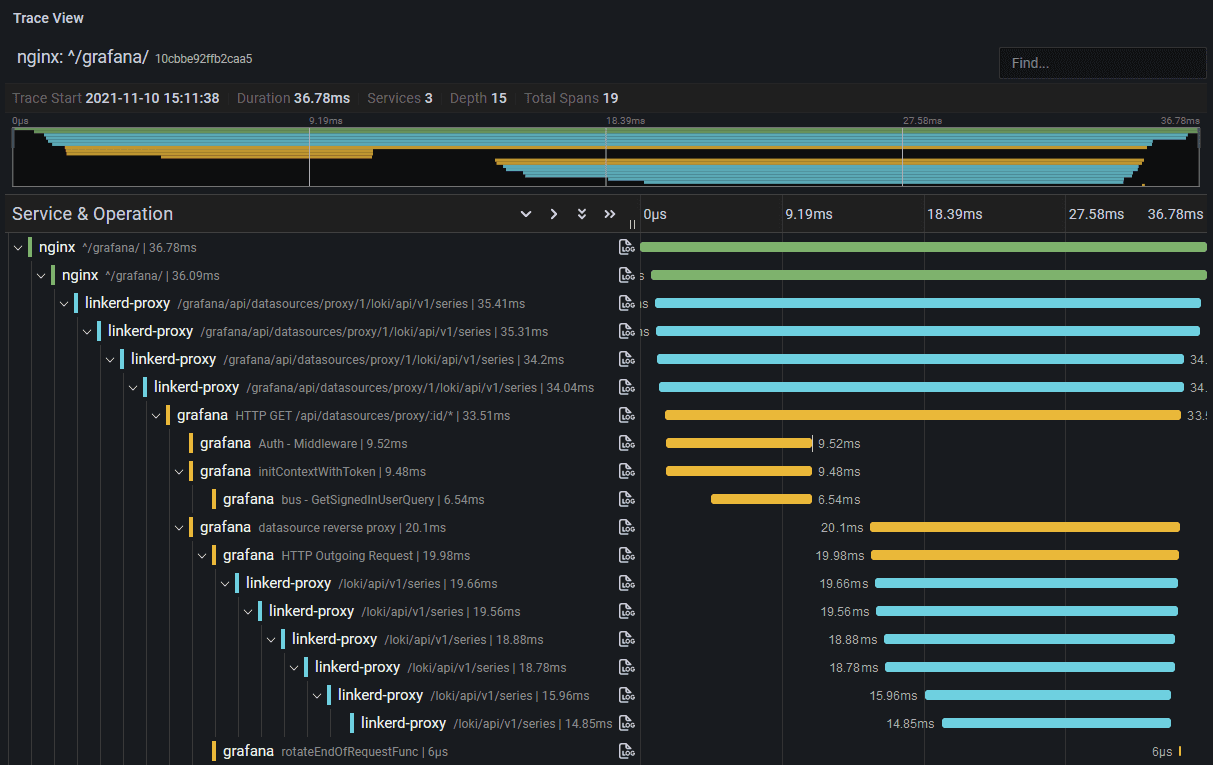

In this post, I’ll show you how to connect all the pieces necessary to end up with a system that collects traces from a Grafana instance that sits behind a NGINX Ingress Controller and runs on a Linkerd service mesh.

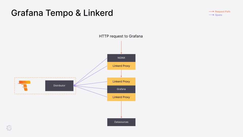

This is a high-level overview of how the request paths and span shipping will occur:

Shipping spans to Grafana Tempo
Grafana Tempo is a high-scale, minimal dependency distributed tracing backend.
Grafana Tempo doesn’t need any specific config, except you need to make sure that Tempo is listening on the ports/protocols you are going to use to ship spans to it on. For this example, I’ll be using the following protocols:
  • Jaeger Compact UDP (port 6831) - for traces from Grafana
  • OpenCensus TCP (port 55678) - for traces from Linkerd Proxy
  • Zipkin TCP (port 9411) - for traces from NGINX Ingress Controller
For a complete list of supported endpoints and their corresponding ports, visit the API documentation.
The Tempo receiver part of the config should look like:
distributor:
    receivers:
        jaeger:
            thrift_compact:
                endpoint: 0.0.0.0:6831
        opencensus:
            endpoint: 0.0.0.0:55678
        zipkin:
            endpoint: 0.0.0.0:9411
I’ll send the traces directly to the distributor in this example, but you could also send it through a Gateway (i.e. if you are running with multitenancy).

Now, click around in Grafana a few times to generate a few requests. You then have a few choices of how to find your traces:
  • If you have activated the experimental Tempo search feature in both Grafana Tempo and Grafana:
    1. Go to Explore
    2. Select the Tempo data source
    3. Click on Search - Beta
    4. You should see some traces here
  • If you ship your Grafana logs to Loki:
    1. Go to Explore
    3. Select Loki search
    4. Do a search for your Grafana logs, i.e.: {namespace="monitoring", job="monitoring/grafana"} or similar depending on your setup
    5. You should see some traces here
  • To grab the logs from Grafana, either directly from the pods or through your log system:
    1. Look for traceID
    2. Go to Grafana Explore
    3. Select the Tempo data source
    4. Select traceID
    5. Enter the traceID and run the query
    6. You should see a trace
