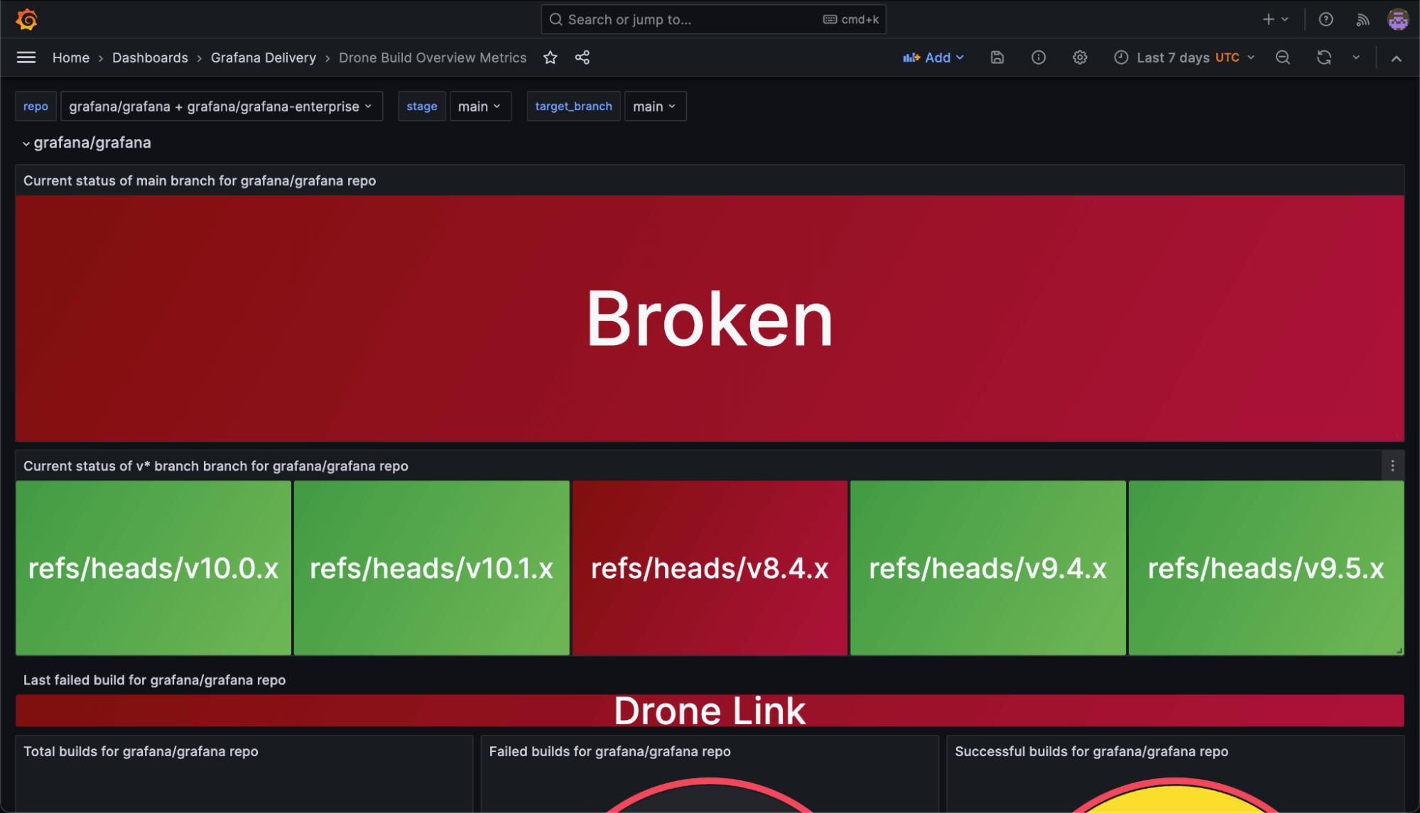

To bridge this gap, we originally created a custom Prometheus exporter, which armed us with a new influx of data. We designed dashboards to present the information in a visually intuitive manner so we could quickly get a grasp of our CI/CD health at a glance, accompanied by alerts for the things we cared about the most.
Here are a two examples of changes we made to ensure observability was part of our CI/CD process:
  • We release Grafana from a set of protected branches. As such, Grafana must be buildable from those branches at any given time, so we added an alert to keep tabs on potential problems. When a build in one of those branches fails, the alert fires so we can fix the issue as soon as possible.
  • We began keeping track of the number of restarts not triggered by any code change. We still have to understand exactly how to use this data effectively, but now, when we see an increase in this number, we assume it’s because of some sort of flakiness somewhere in the process. This may lead us to investigate further and prevent other contributors from experiencing the same issues.
A screesnhot of a Grafana dashboard showing the current status of the main branch for the grafana/grafana repo.

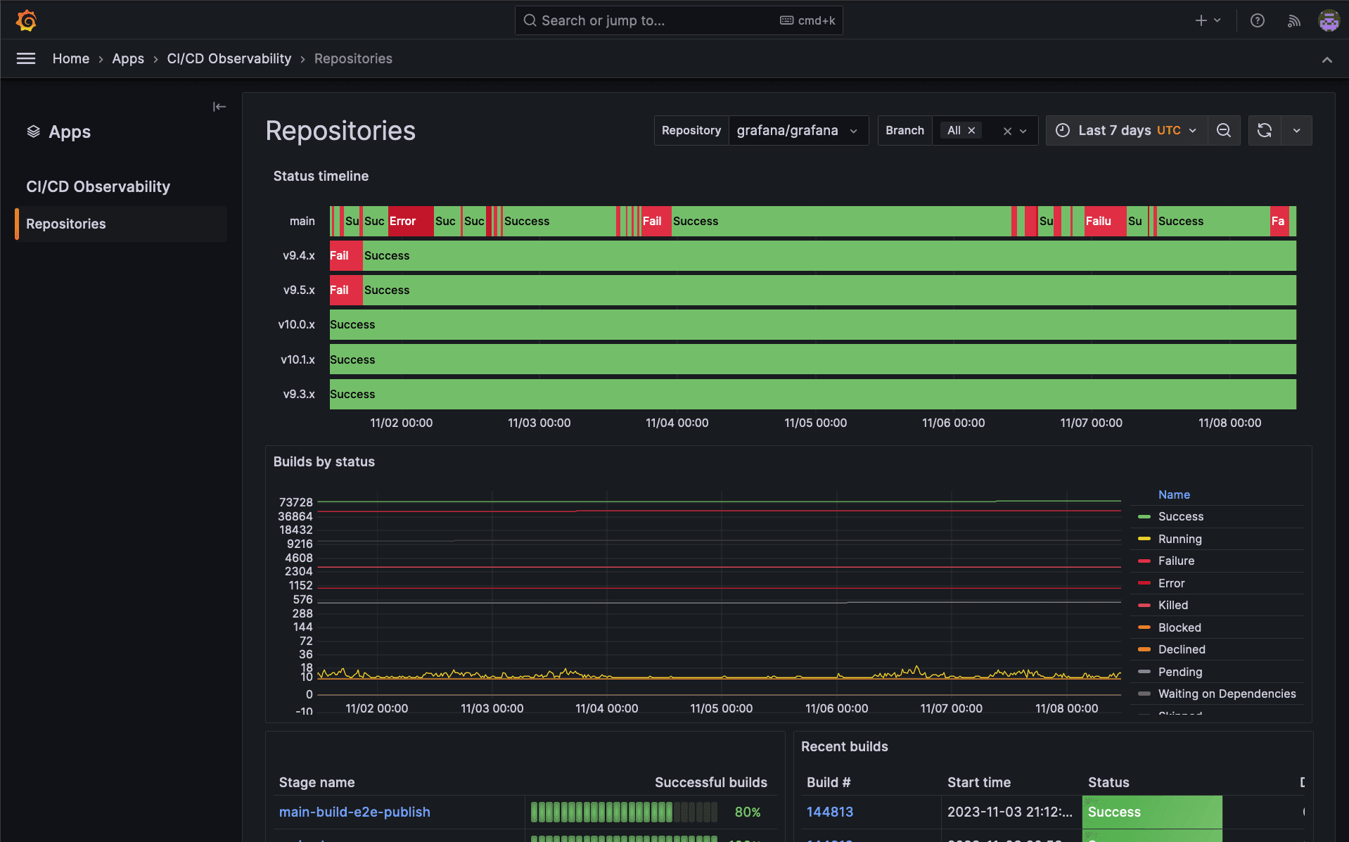

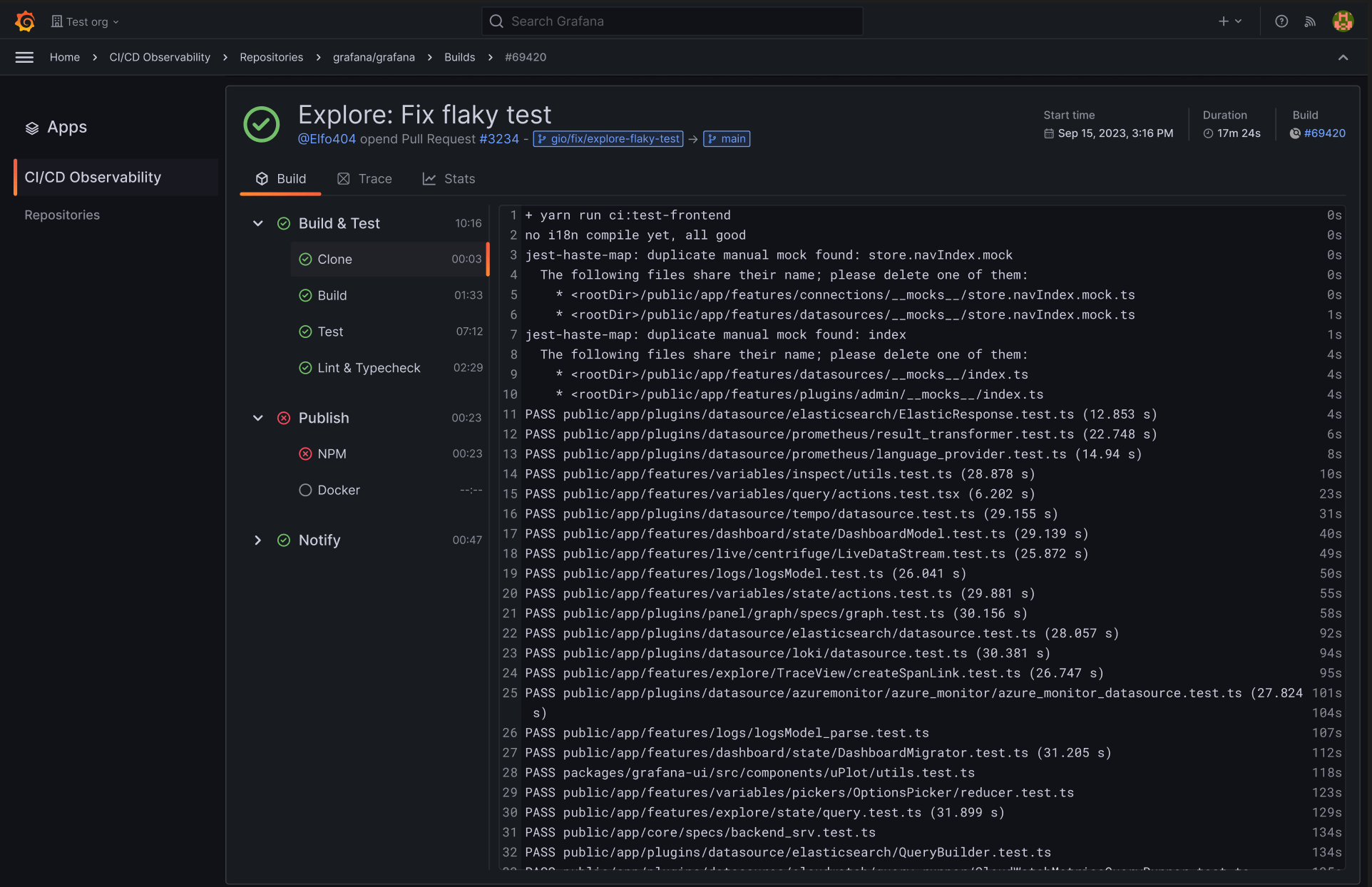

GraCIe is an opinionated Grafana application plugin we are building to provide users with an easy way to understand their CI/CD systems. It’s ideal for evaluating build performance, identifying inconsistencies in test results, and analyzing builds output. The application simplifies these processes, aiming to deliver insights about pipelines effortlessly.
By leveraging the power of Grafana Tempo, Grafana Loki, and Prometheus, we built an opinionated experience for a completely new domain, namely CI/CD observability, because it ultimately relies on the same telemetry signals used in more established observability use cases. Moreover, by relying on OpenTelemetry, GraCIe could seamlessly work with virtually any CI/CD platform, offering users the same unparalleled insights without the need for custom setups or configurations.
A screenshot of CI/CD Observability exploring a fix to a flaky testA screenshot of CI/CD Observability dashboard and the status of various repos.
