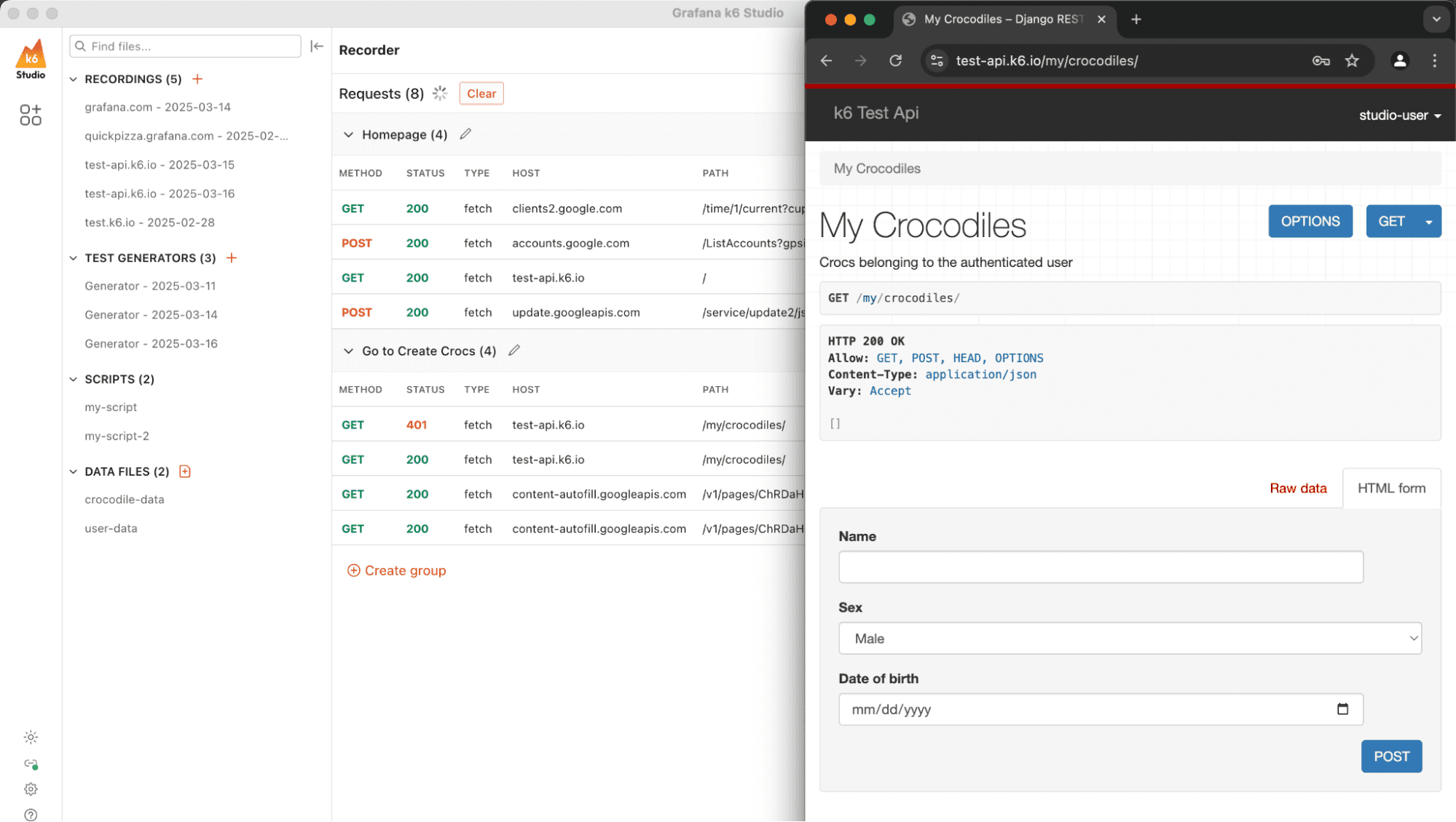

Test authoring can be a difficult process, especially when the inner workings of the system under test are unknown. Grafana k6 Studio offers a recorder-based test authoring experience. Using the Recorder component, you can capture interactions in the browser and inspect the recorded HTTP requests and responses.
A screenshot showing the Recorder component in k6 Studio.

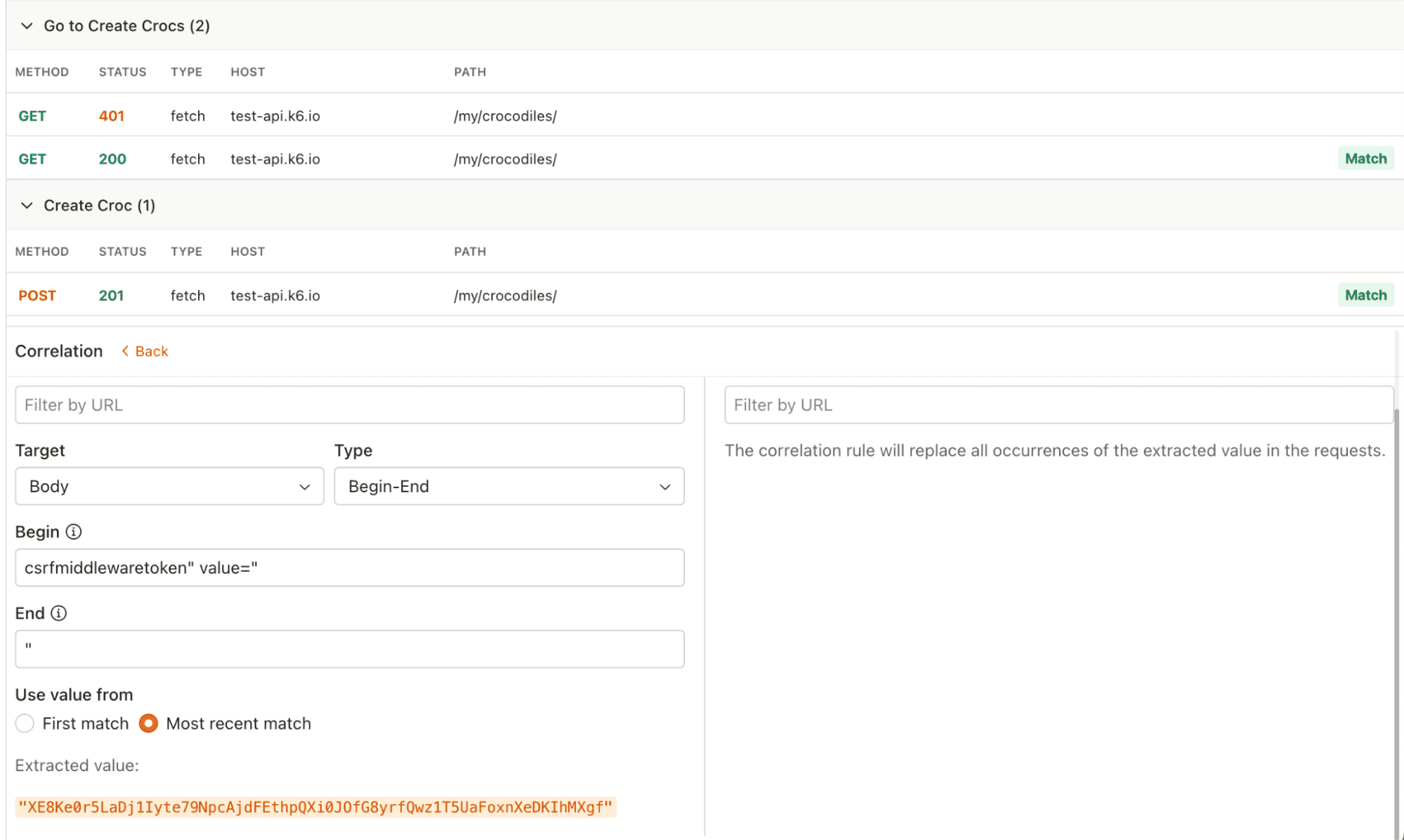

Let’s take the correlation rule as an example. It lets you extract a value from one or multiple responses and use it to replace data in other requests — for example, you could extract the CSRF token from the response and use it in the subsequent requests.
A screenshot showing an example of a correlation rule in k6 Studio.

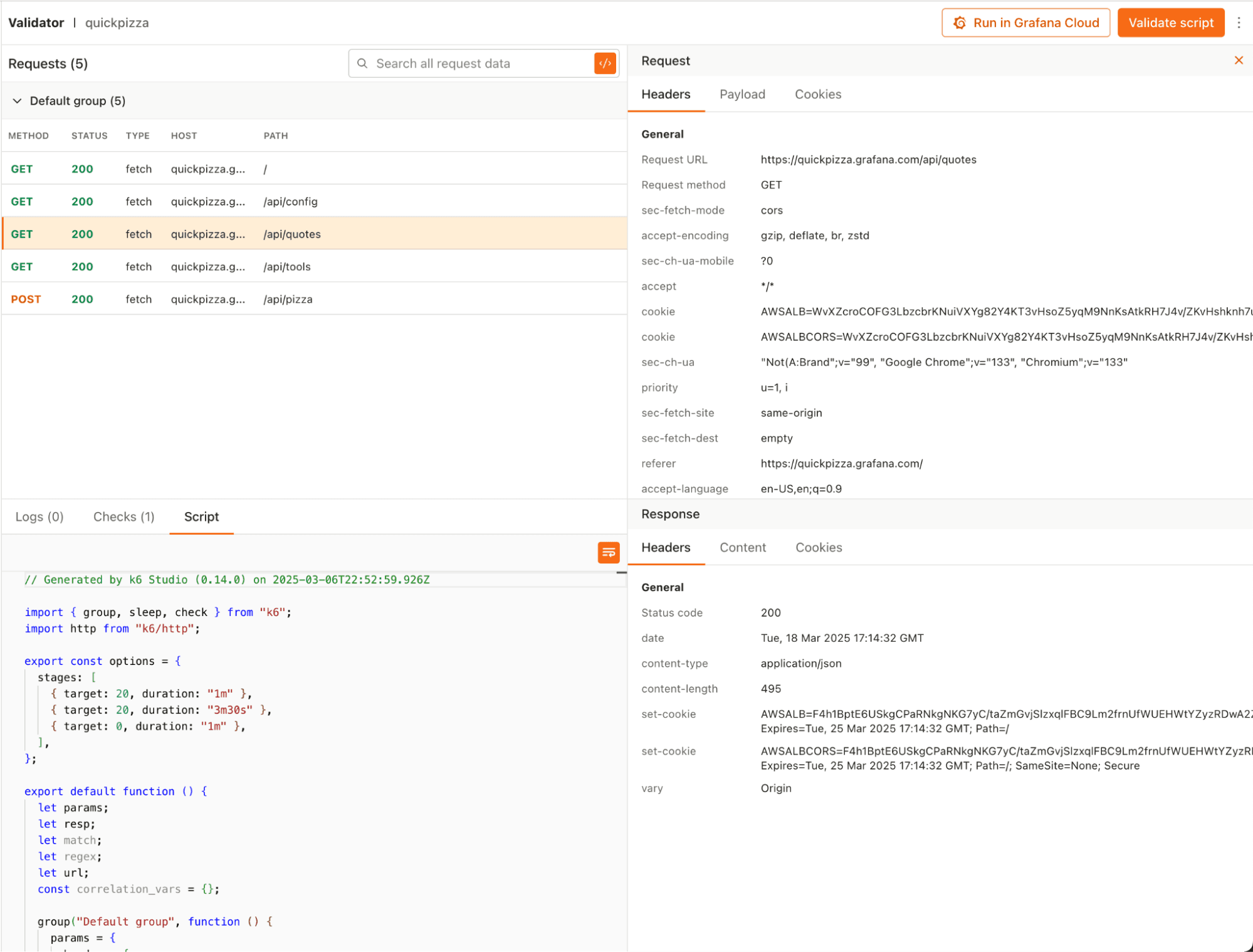

Historically, debugging a script involved running it and checking for errors in the logs. The Validator component in k6 Studio facilitates this process by enabling users to perform a detailed inspection of every request and response individually.
This offers a tight feedback loop, allowing you to make modifications and quickly validate the script while working on it.
A screenshot of the Validator component in k6 Studio.

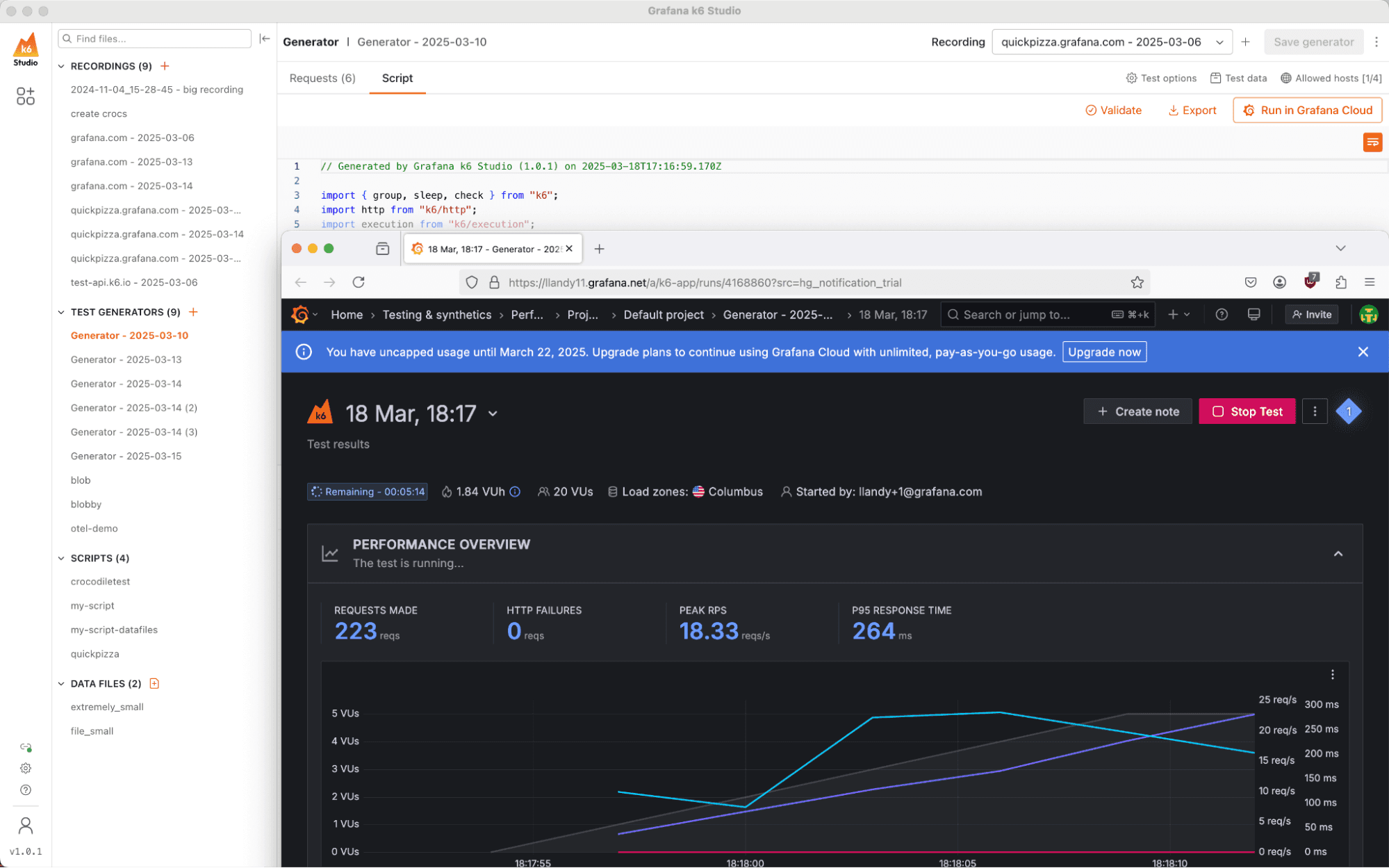

1. Trigger a test locally using the k6 CLI: This is a good option if your tests are going into a CI pipeline, or you are saving your tests into version control.
2. Trigger a Grafana Cloud k6 test to start immediately from k6 Studio: If you’re preparing for a high-traffic event, like Black Friday, or if you’re conducting a one-off testing scenario, you can just trigger the test in Grafana Cloud k6 directly from k6 Studio with the push of a button.
A screenshot of test results in Grafana Cloud k6.
