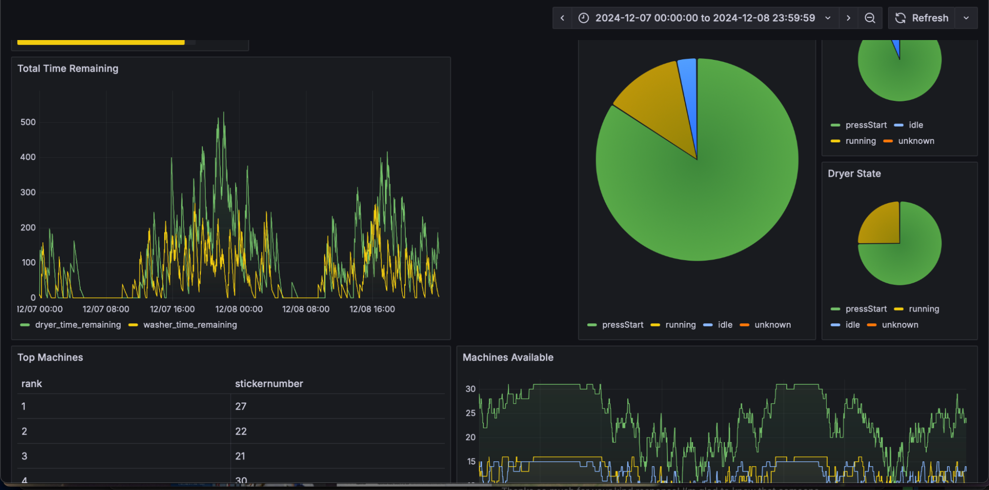

A screenshot of a Grafana dashboard for tracking machine availability.

First, Dakota and Cole got to work on data collection. They wrote a script in Perl, which they then rewrote in Go for better performance and maintainability. A cron job triggers the script to run every minute, fetching JSON data from the laundry machines’ APIs. From there, that data is written into an instance of TimescaleDB — which has grown to hold over 9 million rows of metrics.
“Originally, before Dakota introduced me to Grafana, I was in the TimescaleDB terminal just reading the latest data as it came in,” Cole said. “But then he made the first version of a Grafana dashboard and it was just a better web UI vs. going to the terminal and opening it up.”
From there, the pair started to use Grafana OSS to visualize data from 32 machines, in total, with an even split between washers and dryers. Each machine is identified by a sticker number (1-32) and has key attributes stored, including machine type, license tag, and time remaining, which indicates how much time is left when a machine is running.
Additional fields track availability status, toggling between states like “running” or “idle,” as well as water temperature, dryer heat level, and more. (Dakota and Cole said they’ve yet to figure out how to graph lost socks — but it’s a work in progress).

“There are a lot of other web libraries for charting, but with many of those, you’re often distracted by other things, like how to set the width of a graph,” he said. “With Grafana, I can just write the queries and know the graphs will look nice.”
In addition to monitoring the status of individual machines, Dakota and Cole have gained even deeper insights from their real-time Grafana dashboard. They can tell, for example, which machines are the most popular and which time of day the room gets the busiest.
“It made me aware that I shouldn’t be doing laundry late at night because, even during winter break, I see a spike at 11:00 or 11:30 PM,” Cole said. “It’s good motivation to do laundry earlier.”
