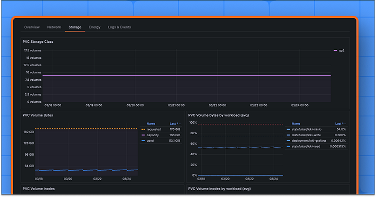

The Storage tab includes five new prebuilt panels (with more on the way soon!):
  • PVC storage class, for tracking the storage classes requested by your PVCs
  • Volume bytes, which compares claim requests with actual volume capacity and usage
  • Volume inodes, which compares volume inode capacity with usage
  • PVC status, to monitor the binding status between the claim and the volume from the claim side
  • PV status, to monitor the binding status between the claim and the volume from the volume side
We designed the new tab so that you can see both high- and low-level storage metrics over time, which is particularly useful in revealing correlations and ad hoc cause-effect analysis. Higher-level PVC information is toward the top, and as you move further down the page you move into lower-level data, ending in the PV information itself.
The tab view at different levels
The tab view is available on the cluster, namespace, workload, node, and pod detail pages.
When viewing at the pod-level, you’ll see one set of panels for each volume, which makes it easier to observe and understand individual volumes. On the PV status panel, the PV name itself is displayed, so you can be sure you’re looking at the correct dynamically provisioned block device, even if they are sometimes elaborately named by the Container Storage Interface driver.
It’s worth noting that StatefulSet replicas may have different provisioned volumes over time, especially if they’re controlled dynamically by a Horizontal Pod Autoscaler. For example, let’s say you’re tracking down a pod by an associated provisioned volume name that you’ve taken from your cloud storage provider. Be aware that the PV status panel is capable of showing exactly when and for how long that particular block device was bound, along with any other block devices that may have been bound to the same pod and claim.
Moving up through the levels above pod, the volume bytes and inodes panels show aggregated data across the whole resource on the left half of the view, as well as a breakdown by sub-resource on the right half of the view.
PVC volume panels
Part of the storage tab as seen from the namespace-level view, showing the entire namespace on the left and breakdown by workload on the right.
This means, depending on which level you choose to view your storage from, you can see everything from which pod in a multi-replica workload has volumes close to capacity, through to namespace-averaged volume usage, or even the total provisioned volume capacity across an entire cluster.
The cluster-level view is particularly useful for getting an overview of the distribution of StorageClasses over time. This information can be used to track a migration to a more cost-effective or performant volume type, for example.

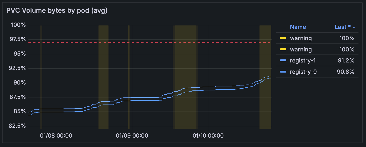

To help understand how these alerts work, we’ve also added a new alert overlay to the panels. Let’s look at an example to illustrate how you can use this feature to identify issues quicker.
In the screenshot above, we’re showing the “PVC Volume bytes by pod (avg)” panel for a StatefulSet with two replicas. It looks like both of the pods in this workload have volumes with intermittent warning alerts. If I look at the first pod, registry-0, I can see it’s the KubePersistentVolumeFillingUp alert. This alert has two severities: warning and critical. The critical threshold is 97%, so this is plotted on the chart as the red dashed line—and we’re not there, yet.
The warning behavior is a little different; it uses the predict_linear PromQL function to analyze the historical series and tries to determine if the volume will fill up within four days. As this depends on the rate of increase of used bytes on the volume, the output of the function can lead to intermittent firing. This behavior might be particularly difficult to grasp, unless it’s visualized in an overlay like this. The warning alert fires when the increase in volume usage is steep enough that, if usage were to continue at the same rate, the volume would likely fill to capacity within four days. The alert resolves when the rate of increase levels out, meaning the volume would take longer to fill.
We think this new overlay will save you time and effort when you’re troubleshooting issues, as it can reduce your context switching and help you gain a deeper understanding of your alerts with the Kubernetes Monitoring app. Lots of relevant information is pulled directly into these panels so you have one view to make informed decisions on your storage infrastructure.
