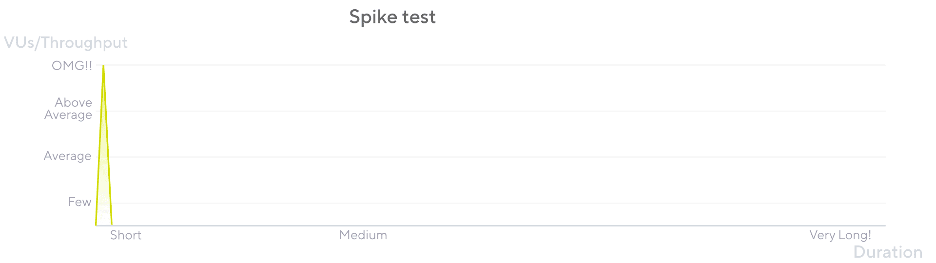

Diagram showing a spike test using Grafana k6.

In a spike test, load quickly increases to an extreme level. The ramp-down period follows when the test reaches the maximum, returning to 0 quickly.
Diagram showing an example of a spike test using Grafana k6.
