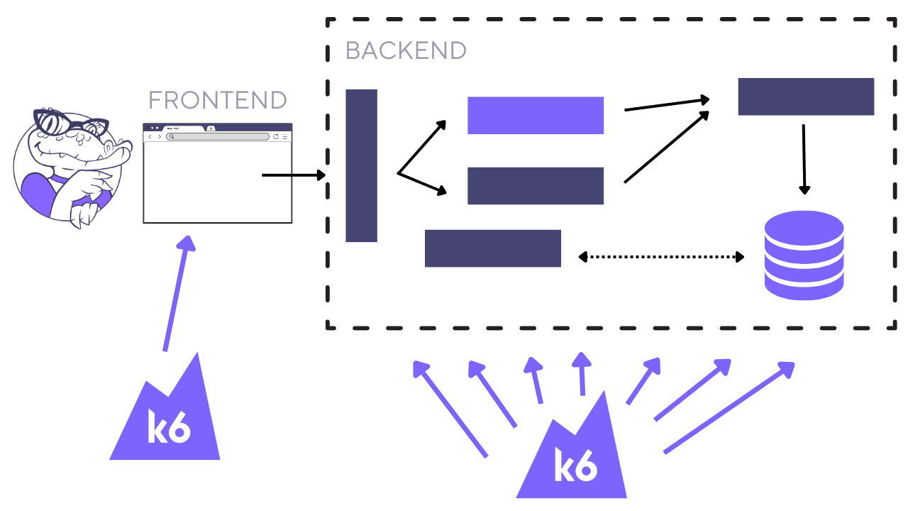

A hybrid approach to performance testing
If you only consider web performance, this can lead to false confidence in your overall application performance when the amount of traffic to an application increases.
It’s still highly recommended to also test your backend systems to have a complete picture of your application’s performance, via the protocol level.
However, there are problems associated with testing via the protocol level, such as:
  • Not being closer to the user experience since it’s skipping the browser.
  • Scripts can be lengthy to create and difficult to maintain as the application grows.
  • Browser performance metrics are ignored.
On the other hand, if you perform load testing by spinning up a lot of browsers, this requires significantly more load-generation resources, which can become quite costly.
To address the shortcomings of each approach, a recommended practice is to adopt a hybrid approach to performance testing, which is a combination of testing both the backend and frontend systems via protocol and browser level. With a hybrid approach, you spin up the majority of your load via the protocol level, then simultaneously have one or two browser-level virtual users, so you can also have a view of what’s happening on the front end.
An illustration of k6 testing frontend system as well as backend systems for a hybrid approach to performance testing
The great thing with k6 browser module is that it can offer you this hybrid approach to performance testing. While you can do this with multiple tools, the beauty of using this module is that it’s built on top of k6, which means that you can have a protocol-level and a browser-level test in the same script.
