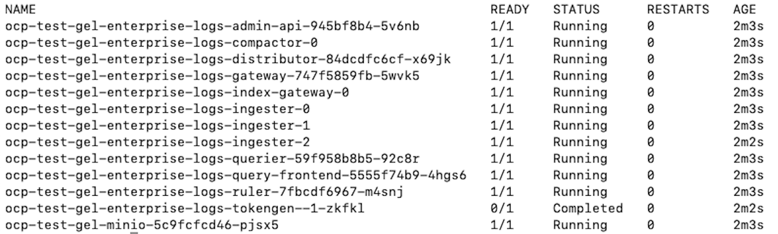

After a couple of minutes you should see the following by running: oc get pods -n ${PROJECT_NAME}

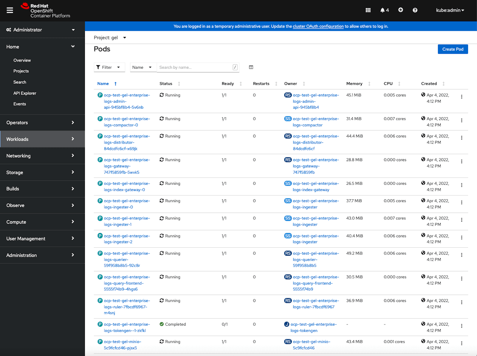

Below is the OpenShift UI representation of the running pods and completed token job.
