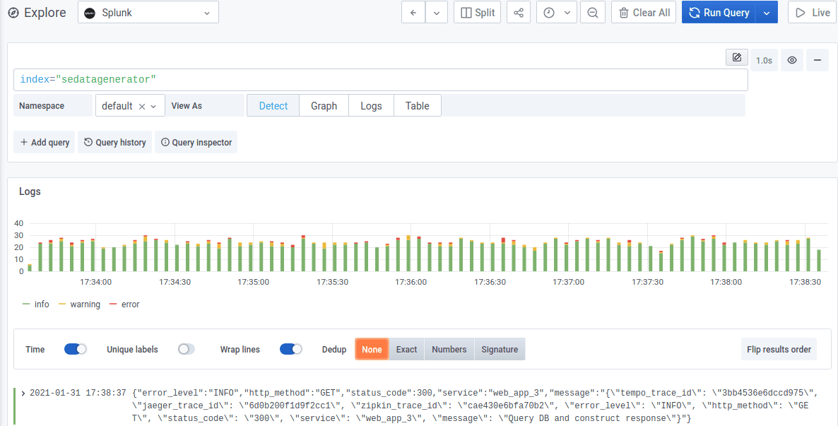

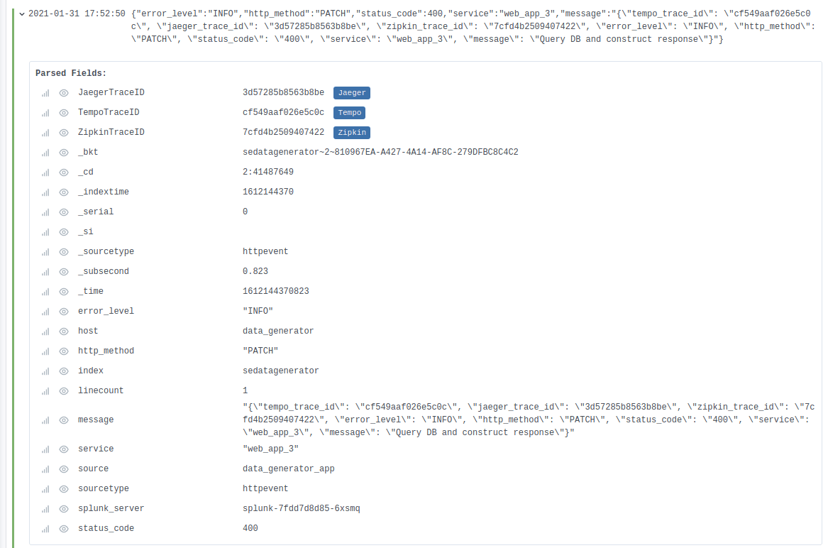

First, verify your trace IDs are appearing in your logs. Here I’m just doing a simple Explore:
As you can see in the full log line at the bottom, I’ve actually got this application outputting trace IDs for all three possible backends  — Grafana Tempo, Jaeger, and Zipkin —  in the form of tempo_trace_id, jaeger_trace_id, and zipkin_trace_id, respectively.

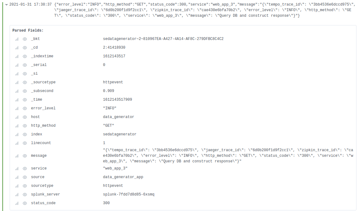

If I expand the log line I can check out all of the fields and see the trace IDs sitting in the message field:

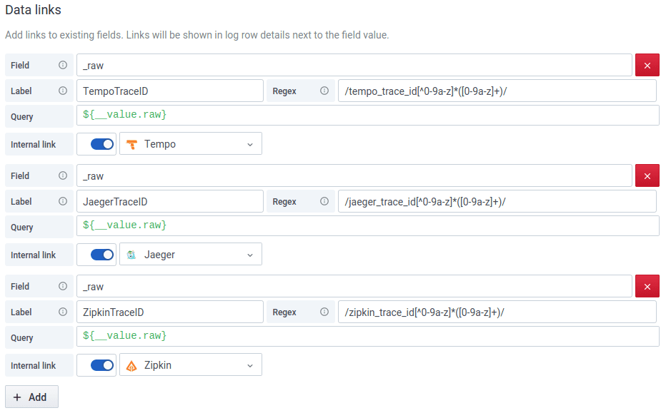

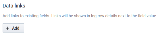

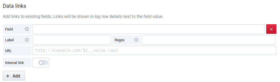

In my Splunk data source’s config, there’s a new section at the bottom:
Clicking Add shows the fields to be filled in:
I’m going to add three links, just to show all three tracing backends working. They mostly use the same regex, e.g., /tempo_trace_id[^0-9a-z]*(\[0-9a-z]+)/.
A quick click of Save & Test to let me know I haven’t made any glaring mistakes, and I’m ready to check back on the Explore page:

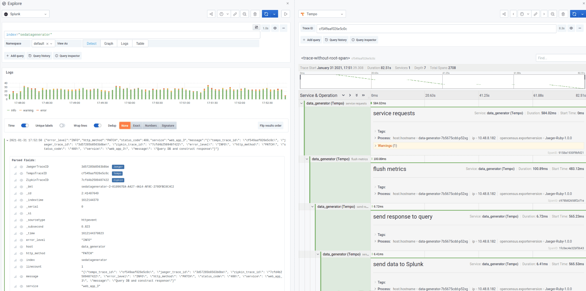

What’s different? Notice how I now have three new Parsed Fields right at the top, each for one of my corresponding data links. That’s neat enough by itself, since I didn’t have to modify my configuration on the Splunk side at all to pull these out!

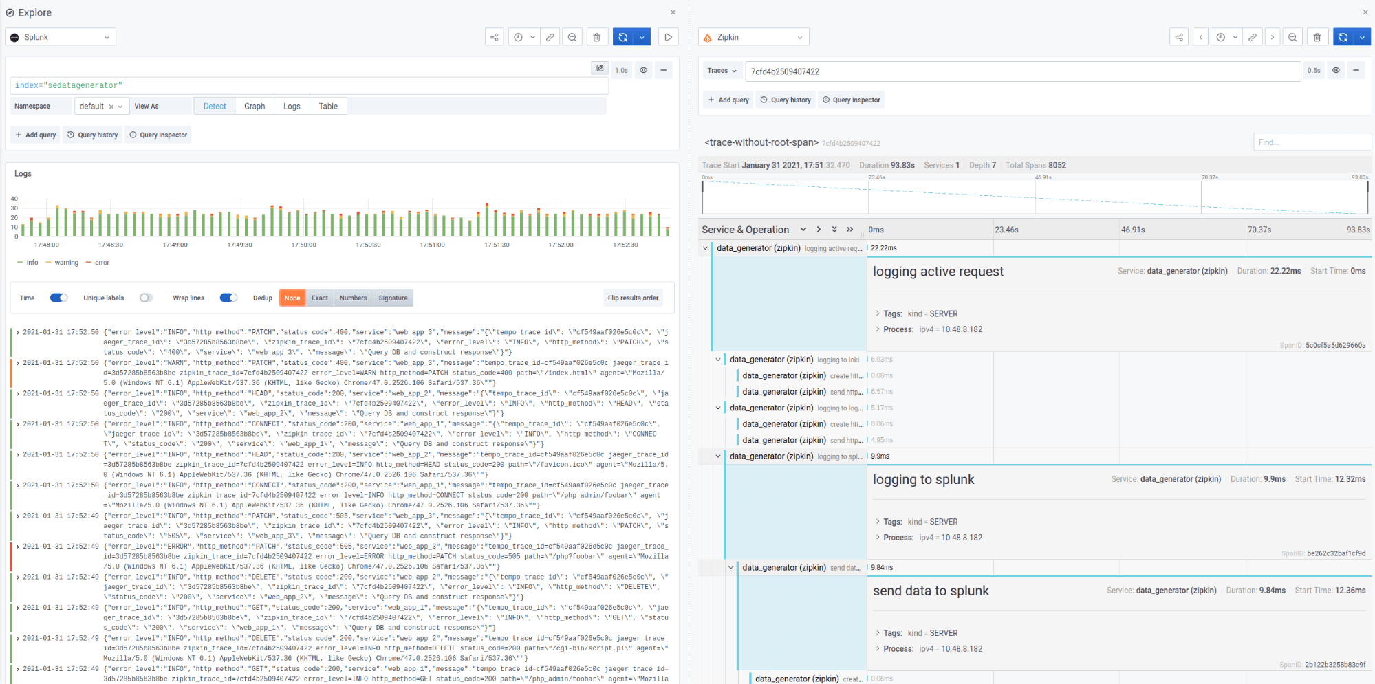

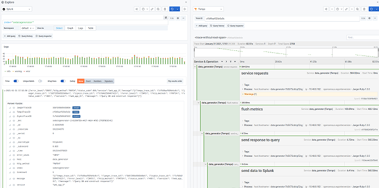

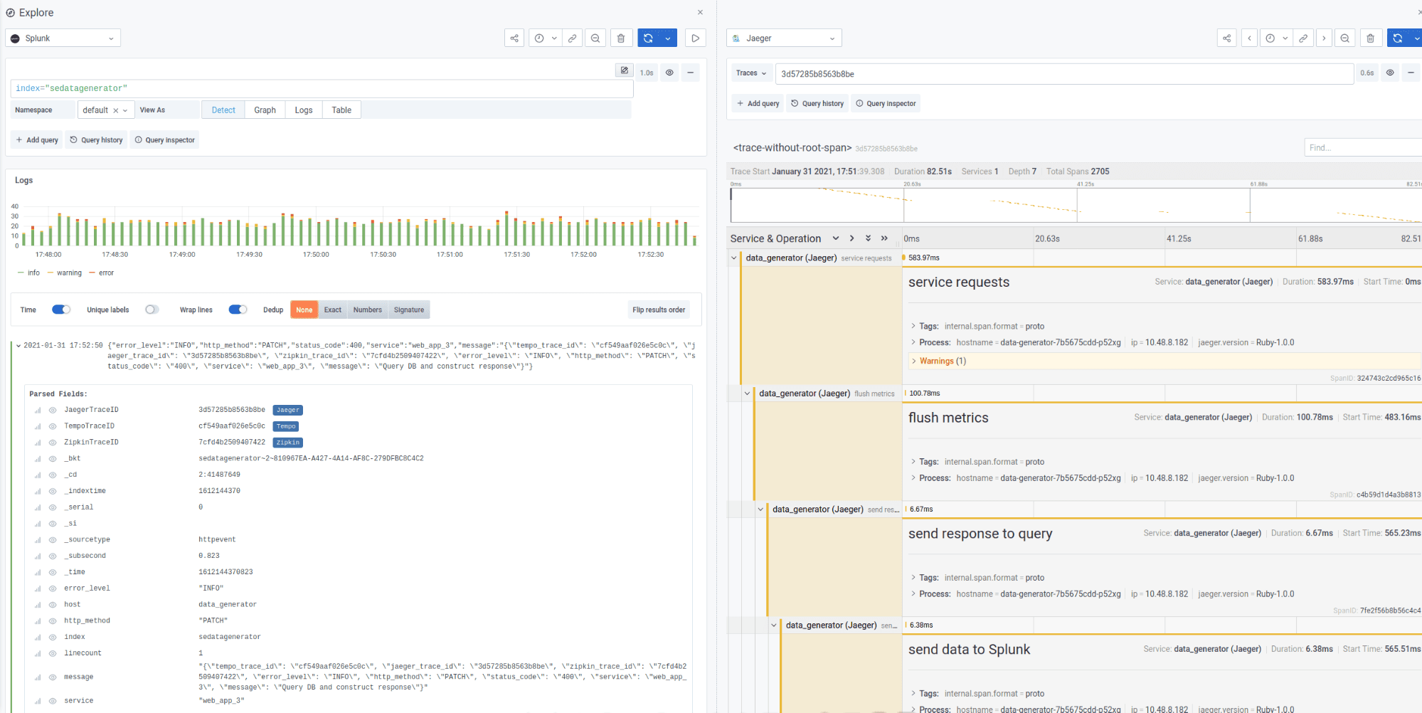

However, the blue labels are the real magic here: Clicking any of them will split the Explore pane into two and show me the exact trace in question!
Tempo:
Jaeger:
Zipkin:
