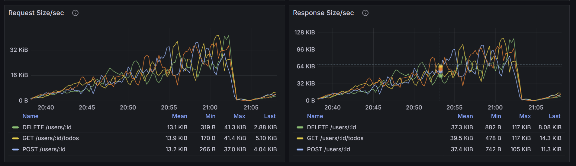

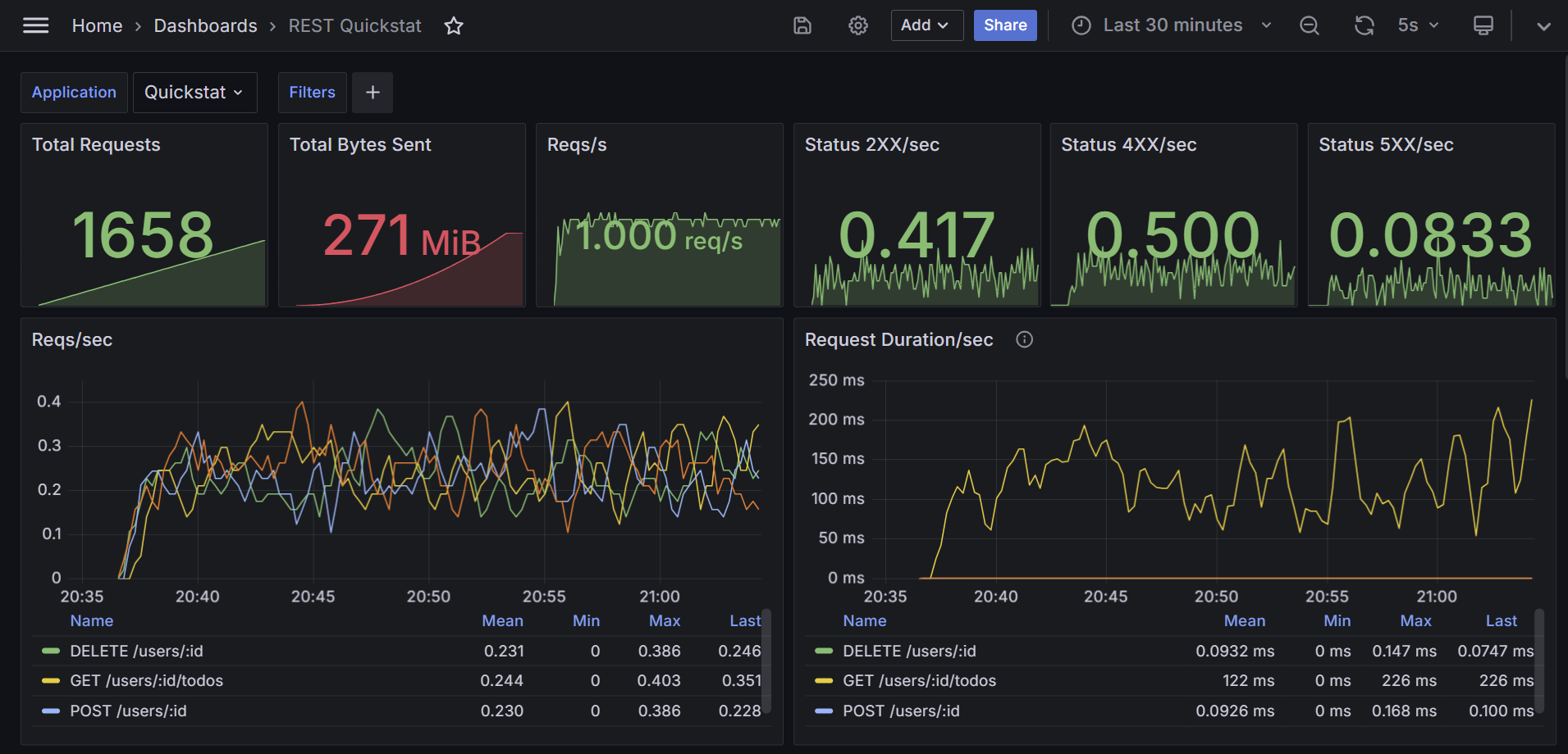

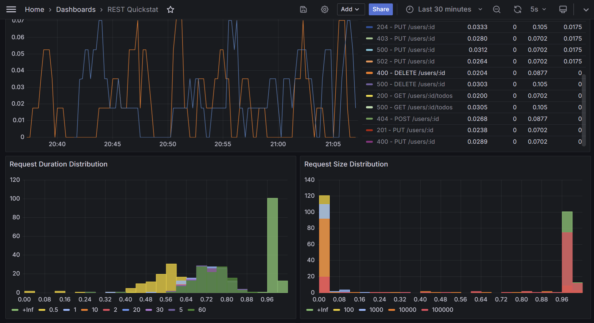

REST Quickstat
Seamless integration with Node.js REST instances, allowing effortless monitoring of key metrics for express.js, fastify etc.
REST Monitoring Plugin
The QuickStat REST Plugin offers seamless integration with REST instances, allowing effortless monitoring of key metrics. It exports these metrics to Prometheus, enabling visualization in Grafana dashboards.
