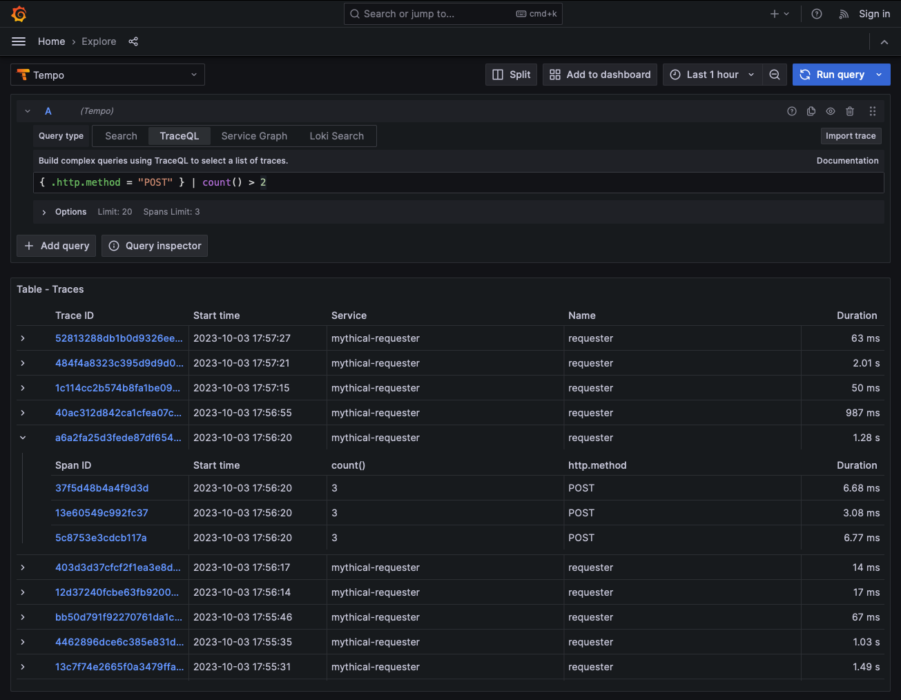

Query using TraceQL
You can use TraceQL query editor and query builder in the Tempo data source to build queries and drill-down into result sets. The editor and builder are available in the Tempo data source for Grafana Explore.
In addition, you can use Traces Drilldown to investigate your tracing data without writing TraceQL queries. For more information, refer to the Traces Drilldown documentation.
For more information, refer to Write TraceQL queries in Grafana.
